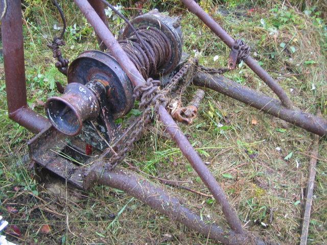

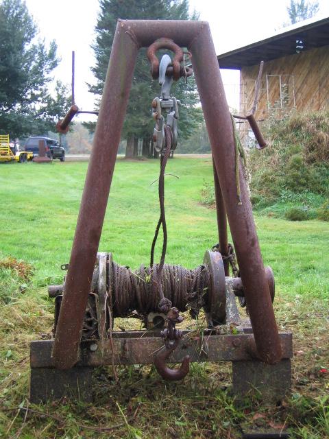

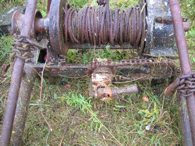

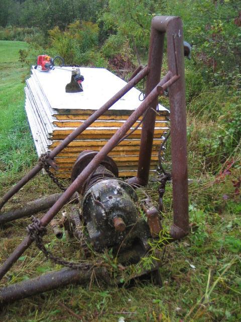

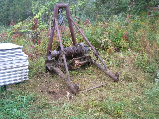

agh: I finally got some pics of my logging arch. I described them earlier so if anything's not obvious just ask. MikeD74T

mike, thanks for posting great pcts!! this is exactly what i needed to see. a couple of questions. I don't see a 3 point hookup, if arms bolt to brackets under frame of tractor where does top link or lift arms attach? i may be missing seeing it.agh
   / how to make 3 point pto logging winch #25
agh, The tabs on the arms connected with pins thru u-channels that hung under the rear axle and formed the pivot point. The channels were also the rear attachment points for the loader on the Ford. They attached to the tractor with the bolts that hold the fenders on. You can see the pins hanging on the chocker hangers on the pic from the rear. The arms look long because they went to the axle centerline. The winch is quite close to the tractor with about an 18" pto shaft.
The chains visable in the side views have a holed tab that connects to the 3pt lift arms to lift the entire frame/arch. Not very clear in the back view, below the winch, are the hooks I towed with in order to keep the load low. MikeD74T
