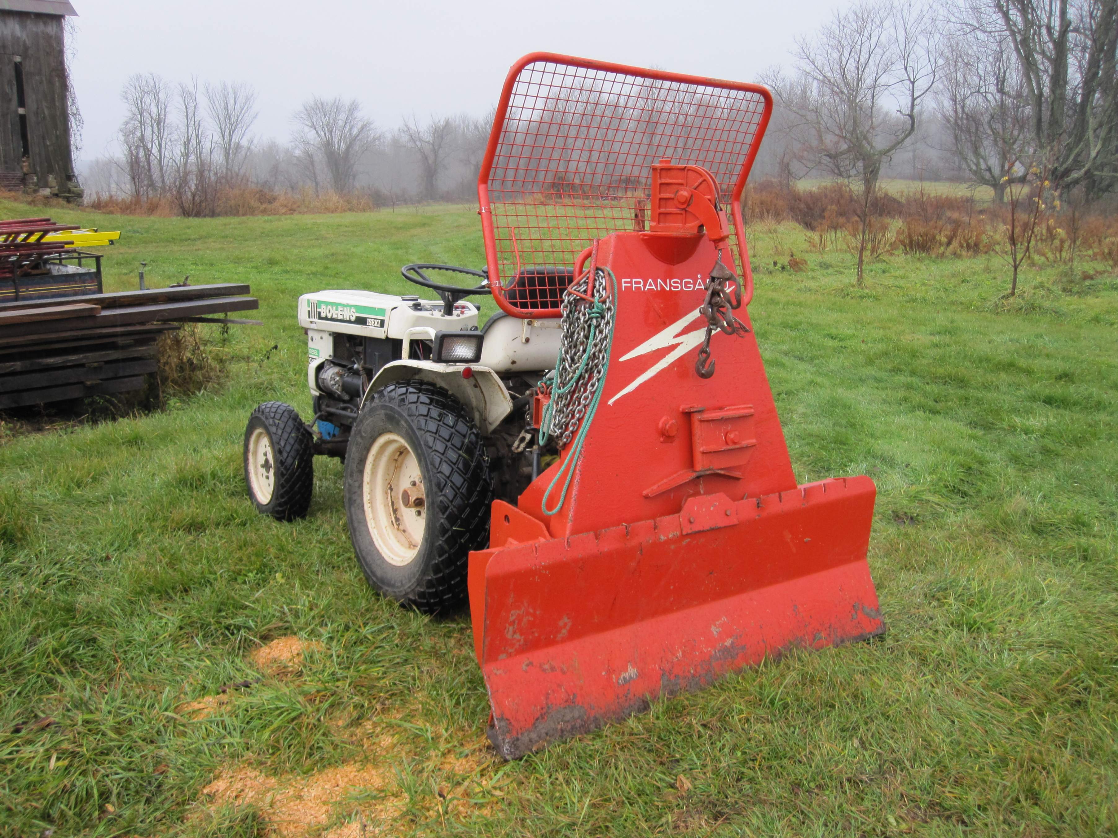

If the little tractor will physically carry the winch, it will certainly have enough power to pull logs to the road with it. Then you'll need to handle them some other way, though. It won't skid them with the winch installed. Too heavy.
The advantage of the short tractor is its ability to turn sideways on a narrow road. Its disadvantage is its propensity to do the same thing without warning on slight slopes when overloaded at the back. Counterweights will be essential to handle the weight of the winch.
In a couple of sessions last fall I skidded my winter's firewood out to the road with the rig in the photos. This winch is an 8000 pound model, second from the largest the company markets. It's way too heavy for the tractor, but the blade digs itself in and the tractor doesn't slide around on a moderate pull. Common sense and a light touch are indicated, however.
Normally I use the winch on a Massey Ferguson 35 but the clean exhaust, vented forward, on the Bolens is much more pleasant to work around than the relatively dirty rear flow from the Perkins in the Massey.
The cable reaches 165 feet, and your tractor's pto and the gentle clutch on the winch should do the job for you if the little guy can move the winch into position.
