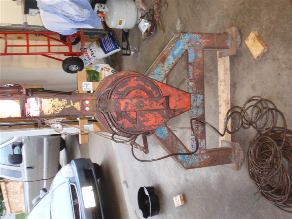

I'll disagree at least a bit, Bob. The Old Farmi winch I have will jerk the tractor (L3130) around like nothing ... if allowed to. Yes you can throttle them pretty well with the rope, and I do that myself, but there is a point that you may be missing after having so much time with these winches: They are not "normal" winches. Most people who think of a winch think of the slow-as-grass-growing type that use gearing to get leverage. Logging winches are orders of magnitude faster than those as they have access to significant PTO horsepressure (neigh!). Newbs will not realize this. For winches, these things fly!
The one I have is much like what you describe - no blade or cage. It's pretty open and "not OSHA happy" by modern standards. They are very hard to find used. I got mine from a friend that essentially gave it to me (OK he got 30 cords of free firewood...) but it took some repair to get it back in shape as it had been a it mangled over the years.
Man that thing needs some paint...
