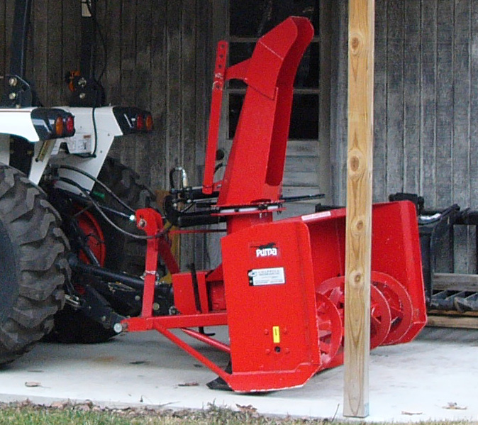

/ how to keep snowblower higher? #9
I found a picture of the add-on skids I made and yes, I tilt mine back also. It helps.
