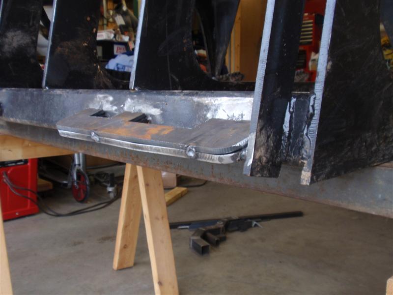

I ended up welding expanded metal onto the back of my grapple. I had too many close calls with sticks poking through and trying to stab expensive tractor parts. It also allows me to grab more with one bite as nothing slips through anymore.

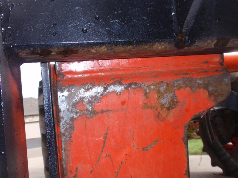

I had an early problem with the grapple popping off the QA brackets. It had to do with the way the grapple was built and the way the Kubota QA brackets are made. Kubota makes the hook angle on the top by bending the bracket. The grapple upper bracket was short and did not go down far enough to get past that bend in the kubota bracket, so a little force and it would pop right off. My solution was adding steel in the right places. in addition to tightening up the fit at the lower bracket, I added some steel up top (you can see that in the photo above).

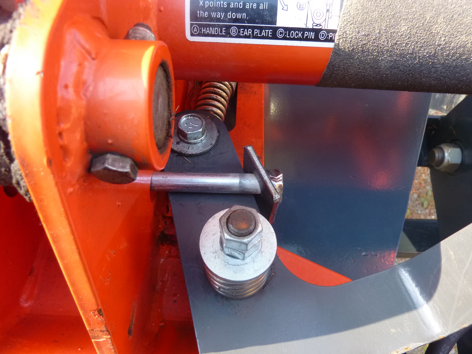

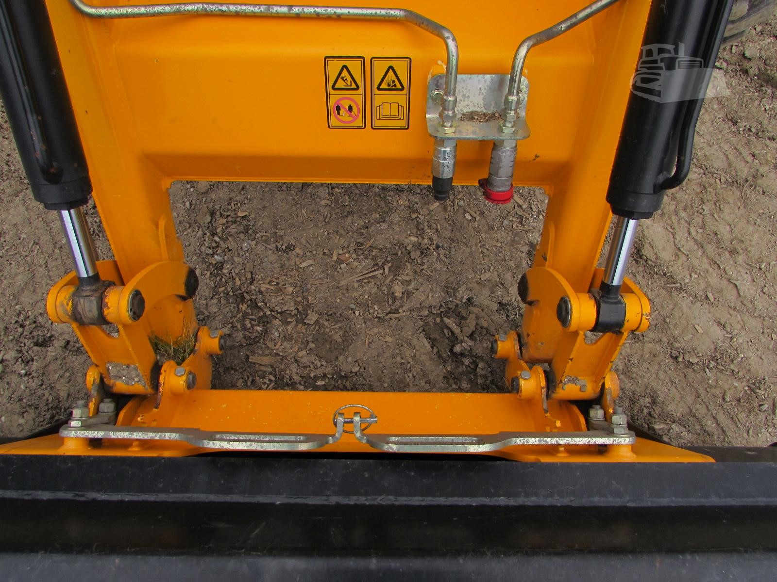

Look at Xfaxman 1st post this thread. The 3rd picture down just above the nut to adjust the spring. There is a metal stop to keep the pin from coming all the way out as long as the pin is over center. If it isn't there the pin can come loose from the bucket. My L3130 didn't have that, but my 4240 has it. The 3130 would open up the arms sometimes.

Well I just felt like puttering this afternoon and decided to see if I could come up with something other than the bungees holding the FEL QA levers down and locked. I noticed a couple holes in the FEL frame that would allow a 1/2" bolt to pass thru and go just behind the QA lever below the pivot point. So I made a couple hooks out of a 1/2" X 8" bolts and short pieces of 3/16" angle to hook around the QA lever.
It is a hard place to get a good picture. I rolled the grapple forward. Here is the hook on the lever below the pivot point.
When the lock nut is tightened it pulls the hook tight and holds the lever securely in the locked position.
I have had the bungees on there for about a month and have had no more problems but I like this solution much better considering the kind of work I do with that grapple..
