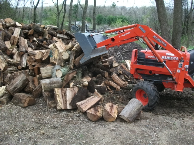

Your first sentence says a lot. Once you learn where the hazard points are with your tractor your "seat" will feel a lot more comfortable. When I am traversing a new slope I take it slow and easy until I see/feel how the tractor behaves. Keeping loads at a low center of gravity is always wise when moving. One way to increase your stance is to put wider tires on the front. Gives you better flotation also. The tires in this pic are 2" wider than the originals. I am pleased with the results although I am still careful on hills.
