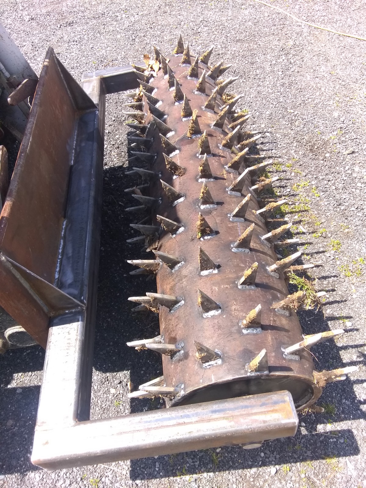

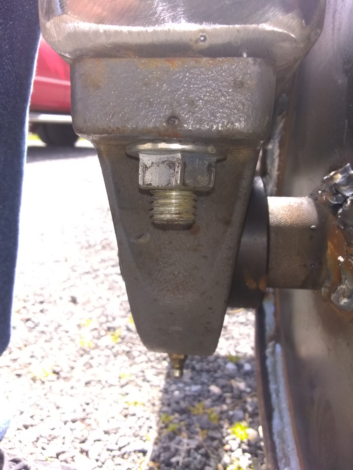

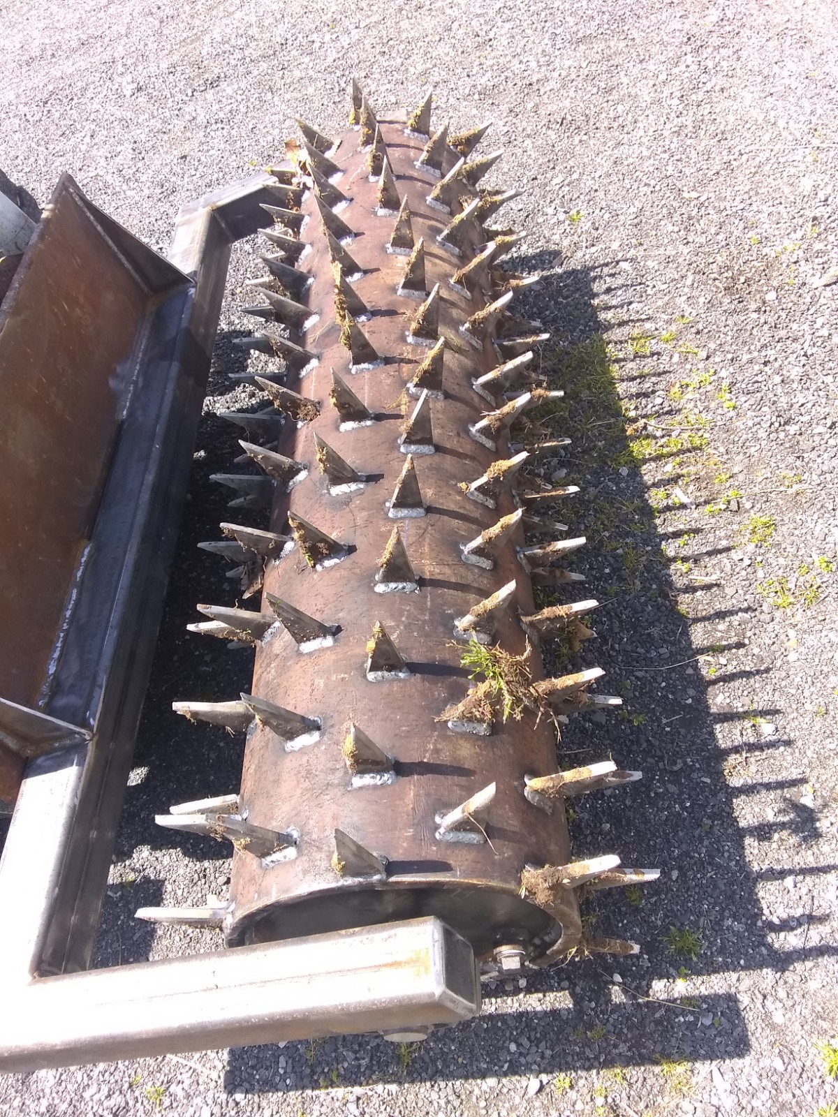

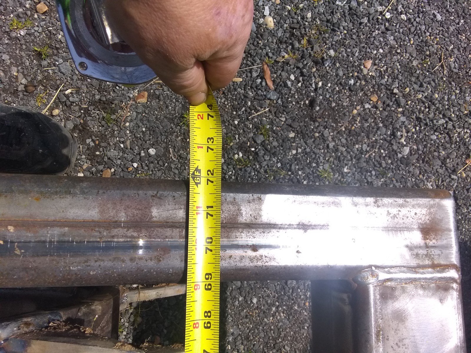

I didnt build a roller, but its kinda close :) This was a 16" piece of sch. 80 pipe. It is now my new pasture aerator (yes I can fill with water, if needed) I cut out the end plates then found center and mounted my stub axles. The bearings are frame mounted using the same spacing off of the main tube. The tines are placed in a v-shape and are 1/2" plate, 4" long View attachment 647667View attachment 647665View attachment 647663View attachment 647664
This thing looks SOLID and mean! Looks like you're running it on a bobcat? Bet it does a good job.

I built it on a ssqa but I have an adapter for 3 pt to ssqa so I can use it on the front or back. Just finished building and its too wet to use it right now. Did a small demo run and it seems to be a very nice cross between a spike and plug type.
