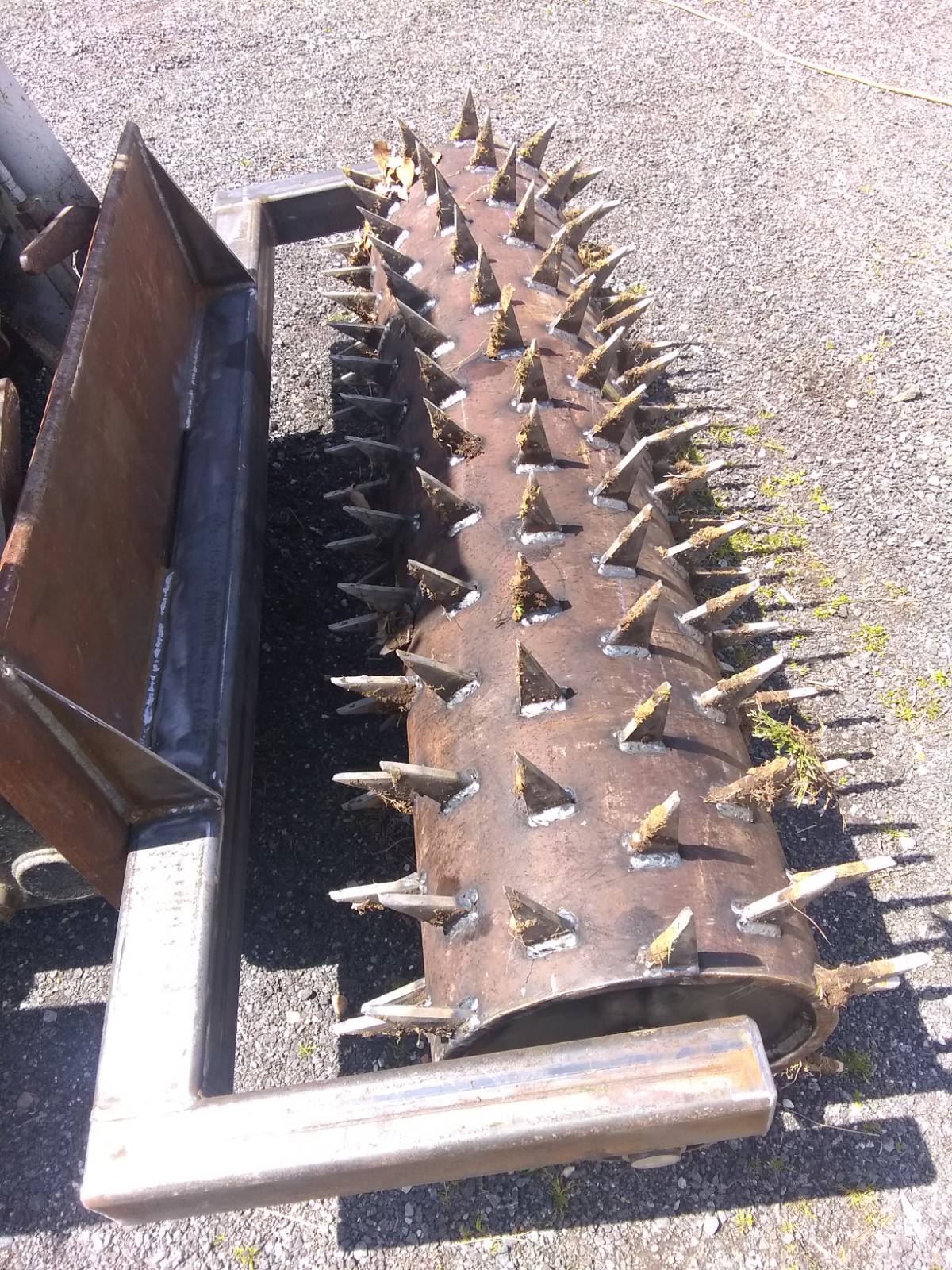

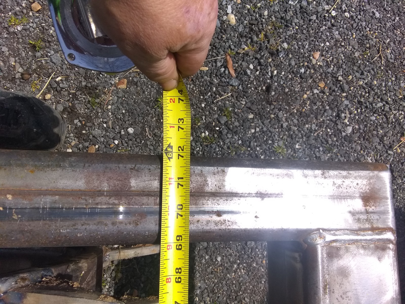

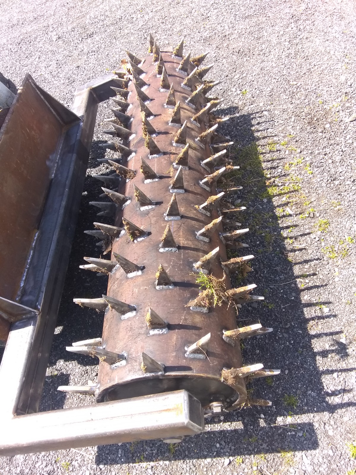

I didnt build a roller, but its kinda close :) This was a 16" piece of sch. 80 pipe. It is now my new pasture aerator (yes I can fill with water, if needed) I cut out the end plates then found center and mounted my stub axles. The bearings are frame mounted using the same spacing off of the main tube. The tines are placed in a v-shape and are 1/2" plate, 4" long width.jpgbearing locate.jpgaerator 2.jpgaerator.jpg
