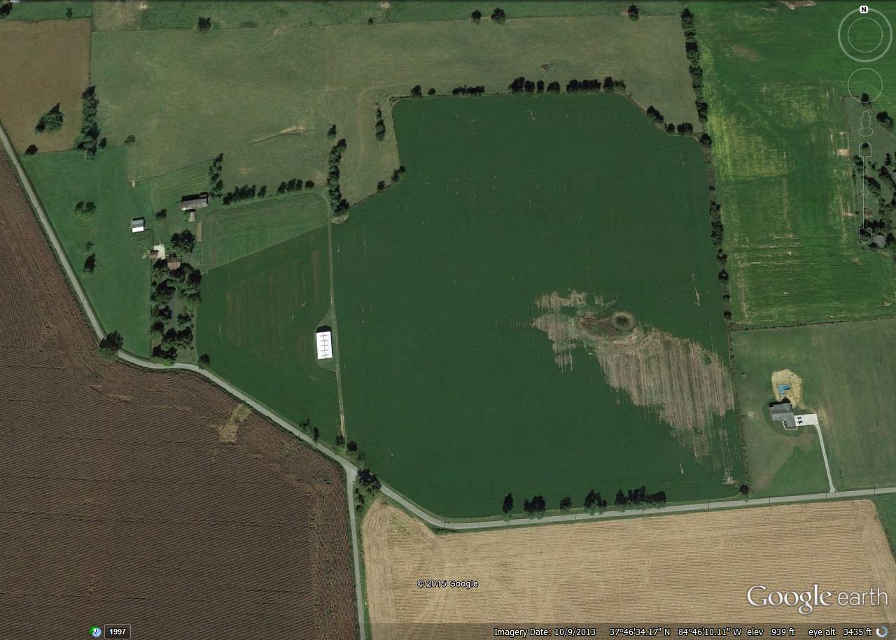

I live in central ky and have a 50 acre grain field with a water problem. This field is mostly flat but the lowest portion is the lowest area in the surrounding 3 or 4 hundred acre area.
very productive maury and mcafee loam soil that drains well, but in heavy rain periods (like this summer) I have an area about 5 to 10 acres that has standing water for a week or so. needless to say this is hard on corn and beans. I would like to drain this area. The only way I see to do this is to pump this water out using tiles to drain field to lowest spot and a sump- type system. Over a rise about 600 yards away I have a spring that surfaces and runs through a ditch about 50 yds then disappears into a hole. This never backs up even in heaviest rains. My plan is to pump flooded area to this ditch. My questions are: am I crazy? will this work? what kind of pump system would be best? Returning this land to productivity would be very beneficial financially and aesthetically. Grain land rents for $300 per acre here, so it would make sense to spend as much as maybe $10 to 15 thousand dollars on project. Any ideas or comments?

Thanks for all the input. To clarify a few things: the "rise" is about 20 foot in elevation, and the spot in question is in the corner of my 100 acre farm. Therefore any kind of ditch or natural drainage doesn't seem possible. Simply stated, if I stand in the low spot and look around, there are hundreds of acres higher than me. There is a neighbor who (stupidly) built a house adjacent to my property and I am expecting him to share the expenses. He owns a 3 acre lot that has been under 2 to 10 inches of water most of the summer. His small kids swim in his driveway (literally). My farm drains exceptionally well, with little or no clay content. Any attempts at digging a pond are fruitless, and anyway you cant grow grain on a pond. In extreme wet conditions the water table seems to rise to about 1 foot above this area. I was thinking if I dug a sump and pumped down to 3 or 4 feet below ground level, that would give me a cushion for when it did come an extended rainy period. Can anyone tell me the approx. cost per foot of tiling? My plan is to construct a sump in lowest spot with tiles radiating from this sump to direct water to the sump. Then lay underground pipe from pump to drainage ditch.

google farm.jpg This is google view of farm. lower right is wet spot and neighbors house. The place I want to drain to is near top center to left of treeline.

The Natural Resources Conservation Service (NRCS) in your town will be your best bet for tiling information. There is probably tile in your farm field now that was laid decades ago. You just have to find it and sometimes the NRCS will have a map of it. Look in the road ditch around and near your farm for a county tile inlet. The NRCS office should be able to give you a list of companies that do this kind of work in your area.
