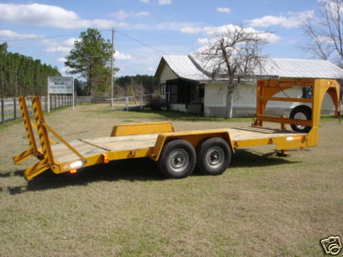

Here's a pic of the trailer as you can see the axles are about centered on the trailer. . . is that going to be a problem?
Thanks again for all the help

/ how to center tractor on trailer #8
You don't want that trailer.
The axles are not placed right, especially for a gooseneck, and it will be about impossible to load right no matter what you do.

I agree with Duffster. The placement of those axles are strange, especially for a GN. Most GNs tend to place the axles much further back. (I often think too far back on some trailers.) You will have trouble balancing your load unless you set the FEL on the GN. Also with the flip up ramps, you probably won't be able to load your tractor, FEL and 6' mower. The mower may need to hang a little off the back and the ramps won't allow that unless they are removed after you load (unless you put the FEL on top of the GN).

I agree with the others, that trailer doesn't look right.

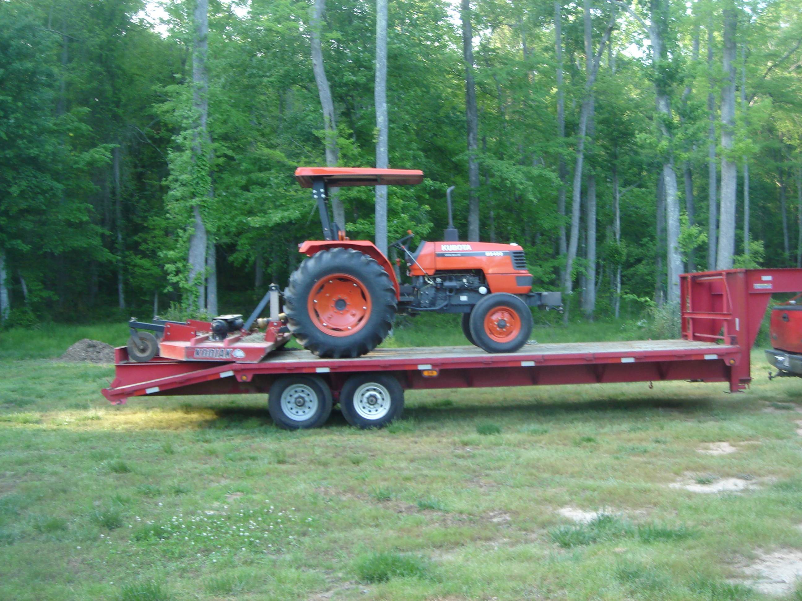

Here's a couple pics of my gooseneck. It's a North Alabama brand 20 + 5 with 7K lbs axles.
Hope this helps with your question.

That trailer is not set up right like the others say. Skip it and keep looking.

Big State here in the Houston area tells me the first axle should be at 60% of the trailer length. Second axle follows as the spring set needs. So, just remember the 60/40 rule regardless of trailer length.
Your trailer 'looks' like it would be balanced, but I think you'll find out as others have said, axles centered will never load right.

I dont think the problem will be tongue weight, it will be a light tongue. With the axles that far forward you can get the trailer tail heavy very easily and the tail will wag the dog so to speak.
It almost looks like that trailer was originally shorter, the back end added on. It is hard to tell . . . . .
