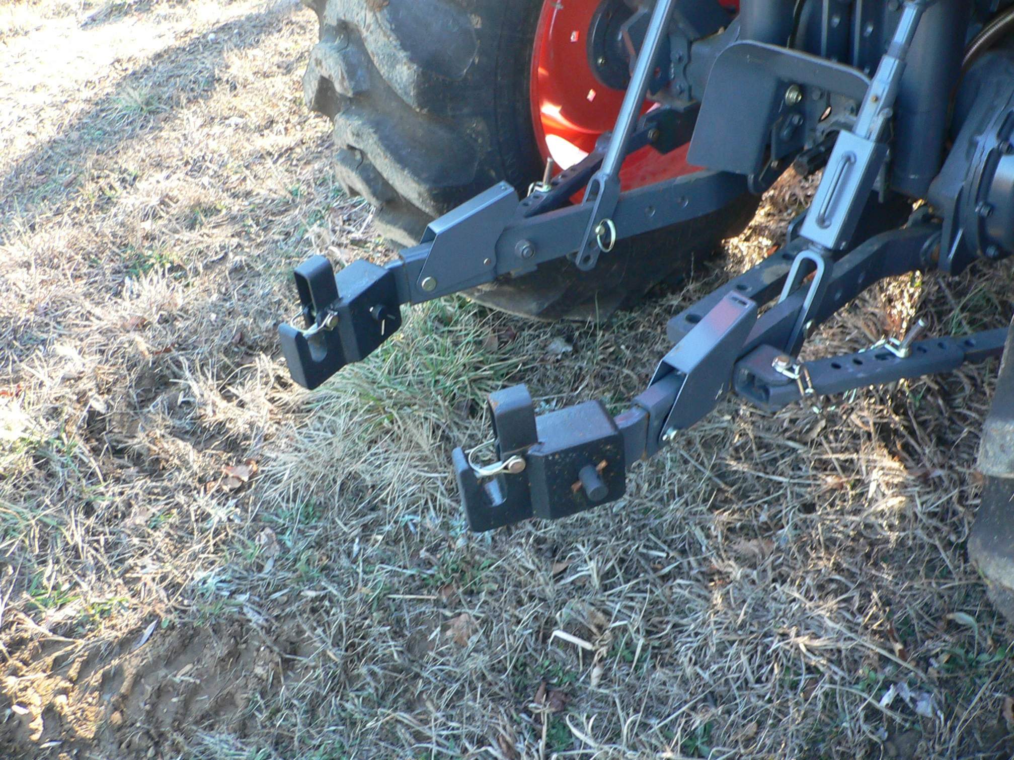

These are called quick hitches. One of the first things I bought when I found out about them. I also hated switching implements, still don't love it but it's much easier now. Pat's is a plated steel and capable of more rugged use and the other set, cast metal, I ordered off ebay for under $100. They install over the arm/pivot ball and extend back a few inches so upper arm may have to be replaced for approx $15 at Tractor Supply.

I am confused. None of my three point attachments require wrenches on the pins. The pins slide through the ball socket and are retained with a keeper, no tools required. Pictures might help.

Underneath those 'hooks' on the ends are just like what you have. The swivel ball, and the implement pin slides in and through and then the lynch pin to hold.

No adjustment necessary with the Pat's. It works by coming up from under the lift pin and then a securing latch locks in the pin.
If all of the pins on all your equipment are the same width no further adjustment is needed. With the BX a rod is necessary to keep the lift arms spread while hooking up. They tend to collapse together as you probably already know.
If you decide on the Pat's let me know by PM and I'll send pictures of various spreading rods that I've tried on my BX that work well.
