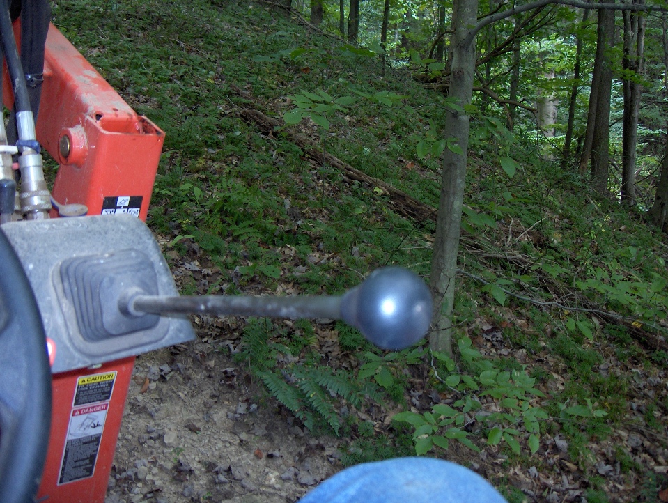

Thanks for all the advice. The problem with getting a tilt meter is that the numbers won't mean anything to me. What's the number where I should stop and back up the hill?
I have one of those little angle finder gizmos for carpentry. I held it at arms length and lined it up with the slope on the steepest part and it said 30 degrees. I took a picture of the steepest parts and drew in the horizontal and the slope as best I could. Would you mow this sideways?
/ How steep is too steep (and how do I know)? #8
I have one of those little angle finder gizmos for carpentry. I held it at arms length and lined it up with the slope on the steepest part and it said 30 degrees. I took a picture of the steepest part, but the photo somehow makes it look less steep. Would you mow this sideways?
The pics(pics are deceiving without a good reference) do not tell the whole story but the angle finder does. If the slope is truly 30 degrees I would not try to cut across the slope(sideways). I would for the first cutting back up the hill or walk it and look for drop off and holes that could cause issues. I would make sure the tractor is in 4wd and go to work. Here is a couple of pic of a trail that is +-30 degrees. The first is a side shot for reference and the second is looking forward up the same trail.

My first impression is those angles are definatly up and down mowing only. I have seen the state highway mower guys mow those kind of slopes sideways, but not me. Also their tractors are really wide, and low. Get those rear tires filled with WW fluid or RV antifreeze or RimGuard if you can find it as soon as possible. you will feel much better, and will not have to go in so often to change underwear:D As far as the chicken thing, you will have to decide if you are just a "chicken" or not, its your life and limb, better to err on the side of caution than have us read about you after your death or maiming. After traversing it several times you might feel better about doing it, that is ok, but you still need to be careful, as pointed out, you could drop a tire in a little hole or depression and the trouble can begin. Go slow and stay frosty and alert. Good luck.

About 15 degrees side angle is a rule of thumb (where exactly that came from...I've no idea). Tractor manufacturers test their machines on tilt tables to 20 degrees (IIRC) per an ASTM standard. That's a static test so it's not really too applicable in the real world.
Nice thing about a tilt-meter is it can warn you of a gradually increasing slope. No good for a sudden transition though (such as a downslope hole or an upslope rock).
Actually, in my case, the tilt-meter helped me to determine which slopes were relatively safe (but that doesn't mean being complacent!!).
As far as those slopes in your pictures, the second picture is definitely an up/down slope operation. First picture is harder to judge, but 30 degrees is more then I'd mow across with a standard CUT. If I had to mow across, I'd want to install dual wheels on the rear.
