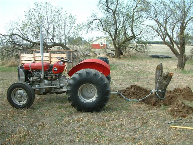

I have one of those little angle finder gizmos for carpentry. I held it at arms length and lined it up with the slope on the steepest part and it said 30 degrees. I took a picture of the steepest parts and drew in the horizontal and the slope as best I could. Would you mow this sideways?
30 deg is pretty sporty. I wouldn't try to mow sideways on that type of slope unless my tractor was specifically set up for that kind of work. For example my 1964 Massey Ferguson 135 diesel is set up to squat low for orchard work.
Those are 18.4 x 16 (18" wide, 16" rim diameter) rears loaded with water (no need for antifreeze here in the North Sac Valley) and the front axle spindles are shorter than normal so the tractor sets level with those 16" rims. The rear track width is 83" and the centerline of the rear axle is 20" above grade. So the squat ratio is 83/20=4.15. Compare that to my big tractor--a Mahindra 5525 with 28" dia rear rims--rear track width 71", height of rear axle 25", squat ratio 2.84.
As others have said, adjust your rears to maximize the track width. If you're still leery, consider a dually rear tire setup. Otherwise mow those slopes with a weed whacker and save yourself a trip to the ER or worse. All you need is for one of the downslope wheels to drop into a 6" deep depression while you're mowing a slope like yours sideways to roll your tractor.
