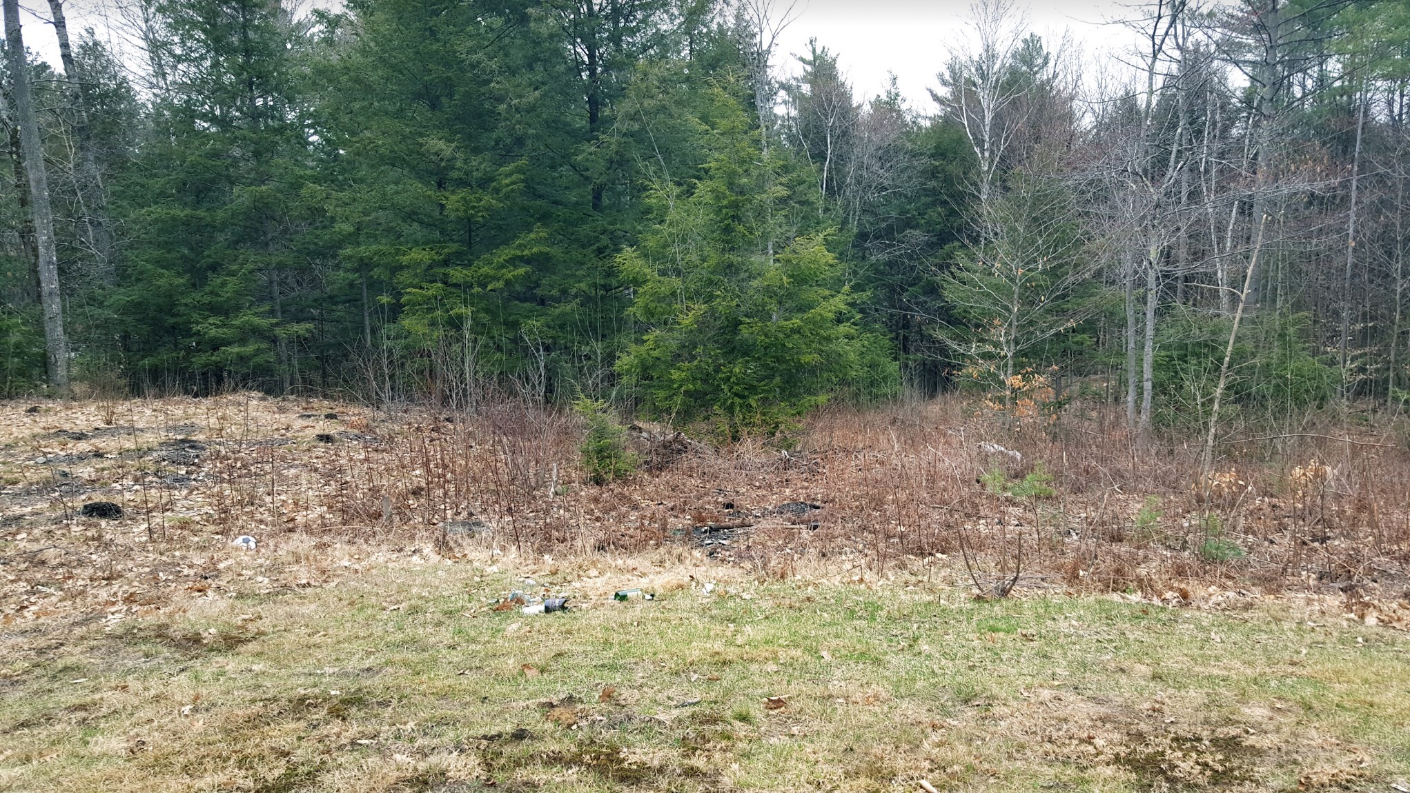

Thanks for all the good guidance. Problem is, mowing isn't really an option for me. Pictures may not do justice but the ground is so covered in debris it would be a nightmare to mow through (take a look at the middle photo for reference). I don't own a rider but imagine that's what you all are referring to, given the condition of the ground, you guys think a rider can handle that type of terrain? And what type of sapling diameter can a powerful rider take on, like in the 20-22hp range.
Answering some of the other questions, my location is New Hampshire, cold season is long and I'm JUST starting to get early signs of buds on trees.
Cost. Mini excavator and skid steer are about the same at around $300 a day and $1,100 a week. To this point I've just assumed all the sublevel roots need to be ripped up to control the growth.
Lawn tractor won't do it, you need a rough mower. For just an acre you could use a walk-behind. They are rentable.
You want to mow right now when the brush is still dormant, knock it down to the ground while you can see what's what. It will come back, but as fleshy new growth, which you can mow again. If you hit it every few weeks you can use a regular lawn mower on that stuff. This time of year you can do surprisingly well just walking around with loppers and a saw. Cut off everything that's living at ground level. Pick up everything that's dead, plus what you just cut. Pile it all up and burn it. Pick up any rocks you can pick up and add them to the nearest wall.
If you're in NH I assume your soil is like mine, mostly rocks with a sprinkling of dirt between them. You do not want to disturb the soil, that will just bring rocks to the surface. If you have surface rocks the only tool that will survive is a string trimmer. That's a big area to cut with a trimmer. You want to limit yourself to cutting, mowing, burning and chemicals, no uprooting or moving dirt around. Trust me on this, I've broken three mowers in a day several times.
What kind of debris are you talking about? Is it rocks, logs, stumps, branches? Human-generated junk? Or just uneven ground? Rocks and stumps will break your mower, they need to come out. I don't like digging out stumps because I end up with a whole lot of rocks, so mostly I burn them when I can. Branches you can mow over with a rough mower. Logs won't generally break the mower but need to come out, pile them up and burn them.

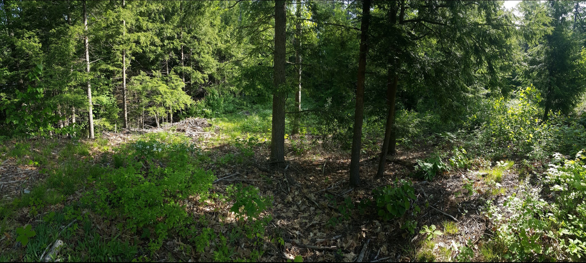

Hey guys, the back acre of my land is covered in thick brush rendering the whole area useless. Id like to clear it all out leaving just the trees. Not too concerned with leveling, it will house a few animal enclosures and fenced roaming areas. Ive tried maintaining it with a bladed brush cutter, but im left with a mess of tangled (mostly blackberry) roots. And it grows back incredibly fast! I think I need a more powerful approach, hoping to get some guidance onto which would work best. Mini excavator, skid steer or mulcher? Plan to rent one for a few days or week, not plan on pulling any stumps either, just work around them.
Here are a few pictures of the land. What it looks like unmaintained with and without summer growth, then after clearing with my brush cutter (and the useless mess it creates.) any advice would be awesome! Much appreciated, cheers!

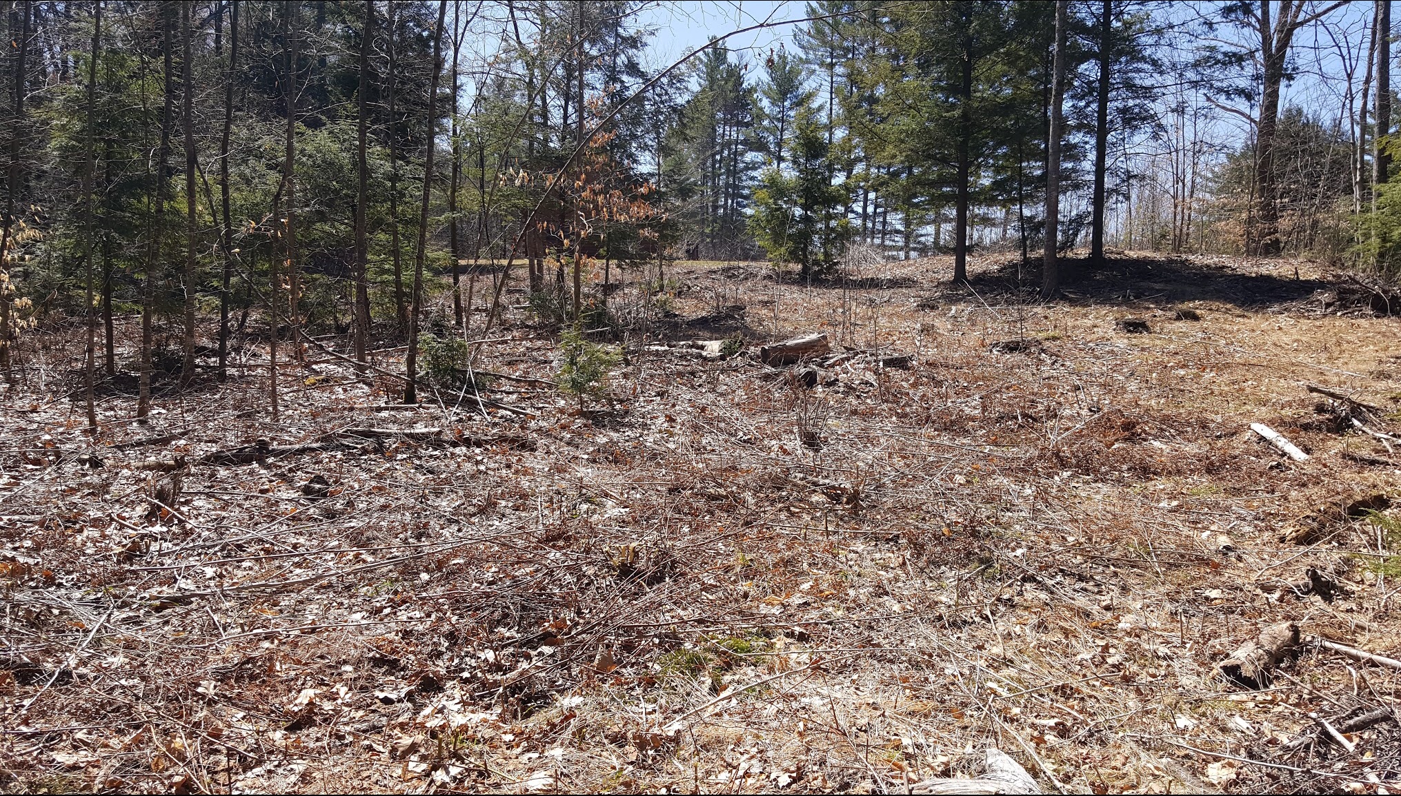

The debris are a combination of naturally downed branches, small trees and the remains of my clearing out the area with the bladed trimmer. It's too big to rake handheld and way too much volume to move by hand. This seems like the biggest problem, if I had all the dead sh#t out of the way I'd have a much easier time with a walkbehind and eventually a rider. But as it sits, no way anything short of a tractor is rolling through there.

Can you burn in place? Can you go around the perimeter of the whole area and establish a cleared path that fire can't jump? Then you can be more liberal with fire on the inside, if you accidentally set the whole thing on fire it's mission accomplished.
I would do a bunch of small fires, and feed them as you go rather than building big piles and burning them all at once. It depends on what's legal where you are. Just walk through an area, if you can pick it up throw it on a fire, if you can't pick it up pile some brush on it and burn it where it sits. Sometimes you can start a fire at one end of an area and work your way to the other by feeding it as you go. If you get a good bed of coals going just about anything wood will burn, even if it's green.
