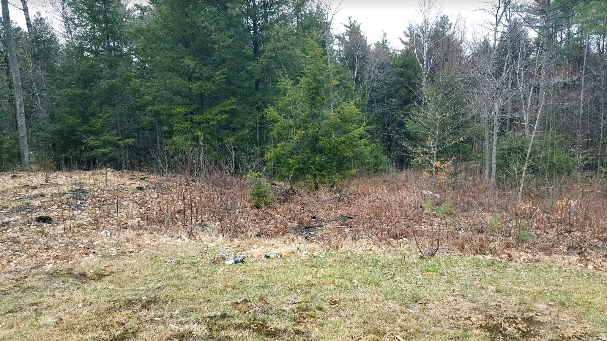

Thanks for all the good guidance. Problem is, mowing isn't really an option for me. Pictures may not do justice but the ground is so covered in debris it would be a nightmare to mow through (take a look at the middle photo for reference). I don't own a rider but imagine that's what you all are referring to, given the condition of the ground, you guys think a rider can handle that type of terrain? And what type of sapling diameter can a powerful rider take on, like in the 20-22hp range.

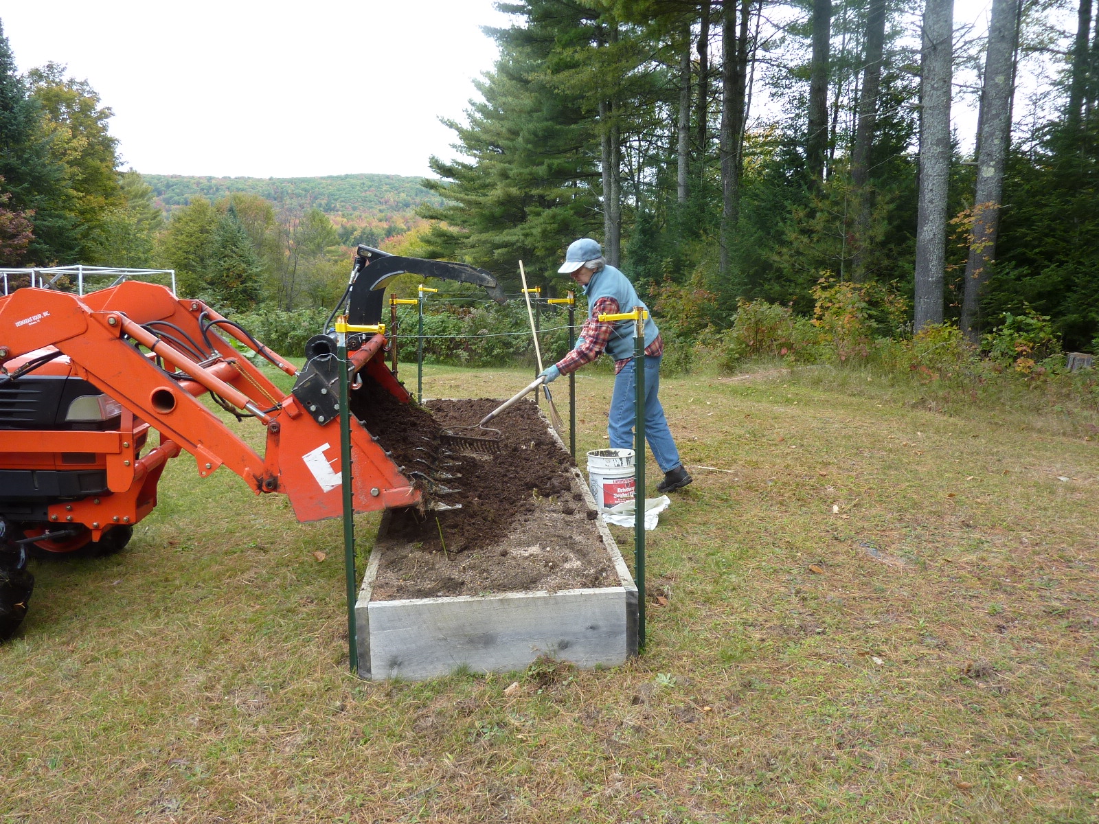

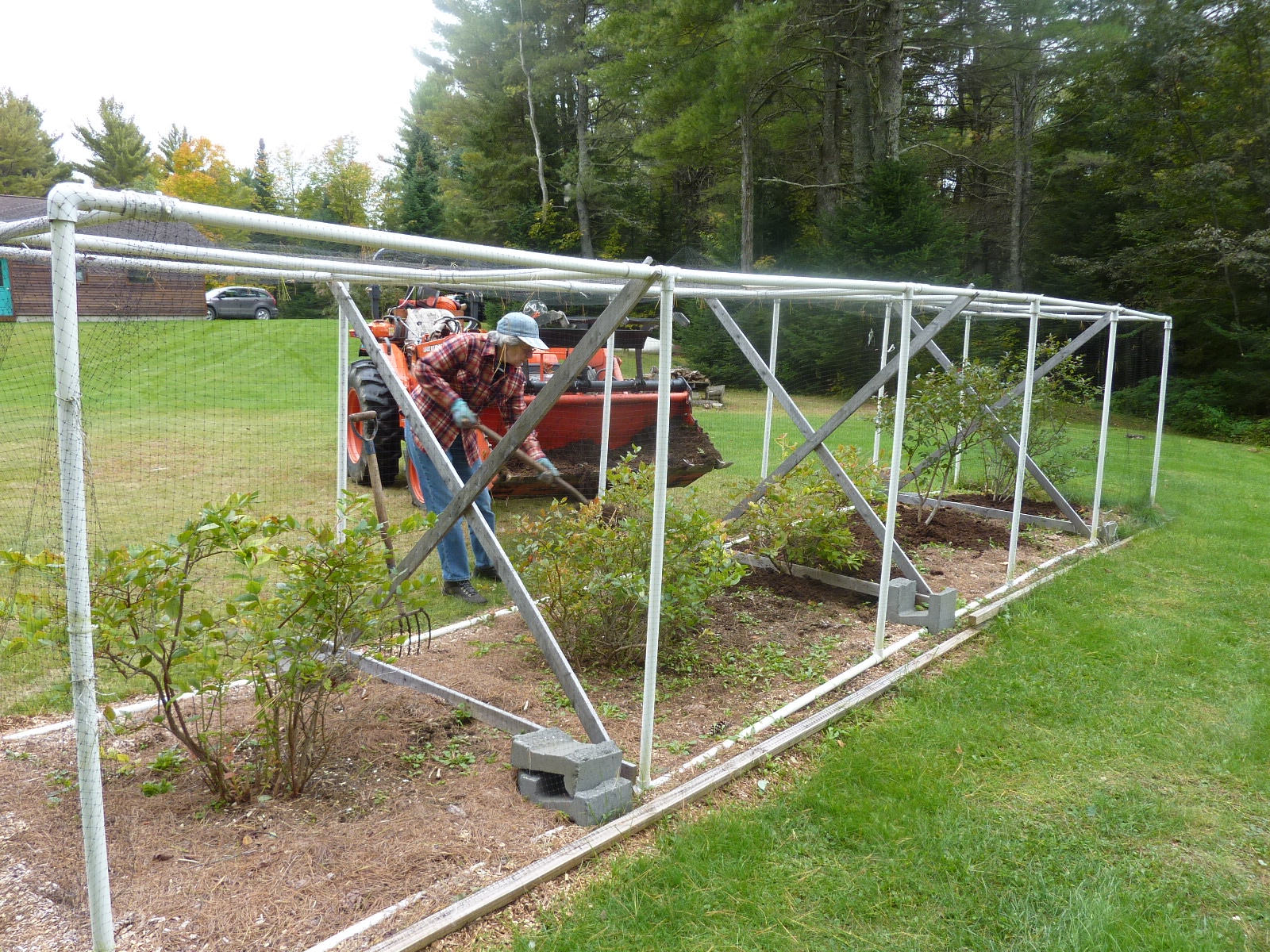

Black berries are not as persistant in NE as they are in other climates. This flat area where my wife has her asparagus and blue berries was reclaimed from black berries by mowing. You can see the remaining black berries that run down the hill behind the FEL in the first picture. They have turned into raspberries now. The area is a 25 year old log landing and was full of half buried logs. I have done nothing but mow and pull out or cut off at ground level stuff that protruded to high. The grass all came up by itself. What I couldn't cut or pull out I just mowed around until it rotted enough to mow over. I used a rough trail mower at first with the blade as high as I could get it, at least 6" probably, and now the lawn mower. Takes a little work and some time plus a lot of patience but mother nature will help quite a bit if you let her.

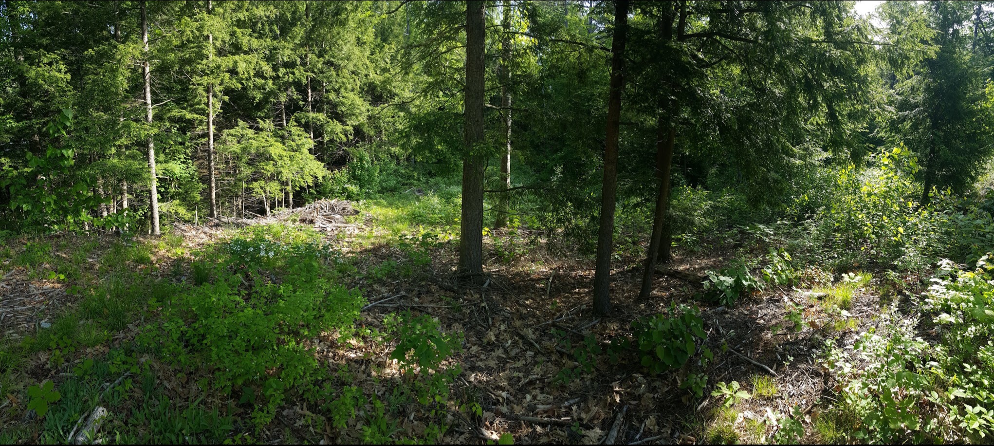

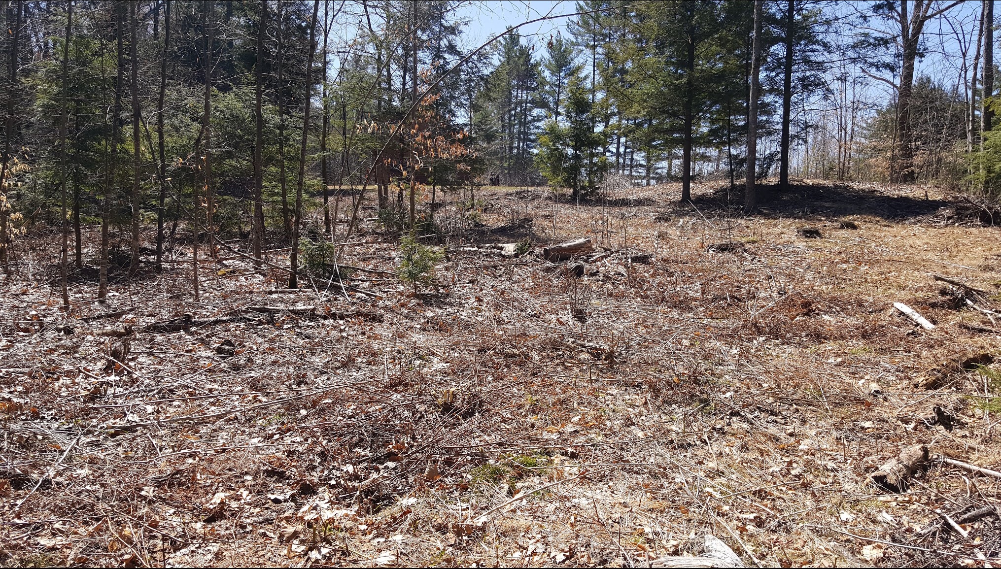

Hey guys, the back acre of my land is covered in thick brush rendering the whole area useless. Id like to clear it all out leaving just the trees. Not too concerned with leveling, it will house a few animal enclosures and fenced roaming areas. Ive tried maintaining it with a bladed brush cutter, but im left with a mess of tangled (mostly blackberry) roots. And it grows back incredibly fast! I think I need a more powerful approach, hoping to get some guidance onto which would work best. Mini excavator, skid steer or mulcher? Plan to rent one for a few days or week, not plan on pulling any stumps either, just work around them.
Here are a few pictures of the land. What it looks like unmaintained with and without summer growth, then after clearing with my brush cutter (and the useless mess it creates.) any advice would be awesome! Much appreciated, cheers!

The debris are a combination of naturally downed branches, small trees and the remains of my clearing out the area with the bladed trimmer. It's too big to rake handheld and way too much volume to move by hand. This seems like the biggest problem, if I had all the dead sh#t out of the way I'd have a much easier time with a walkbehind and eventually a rider. But as it sits, no way anything short of a tractor is rolling through there.
Can you burn in place? Can you go around the perimeter of the whole area and establish a cleared path that fire can't jump? Then you can be more liberal with fire on the inside, if you accidentally set the whole thing on fire it's mission accomplished.
I would do a bunch of small fires, and feed them as you go rather than building big piles and burning them all at once. It depends on what's legal where you are. Just walk through an area, if you can pick it up throw it on a fire, if you can't pick it up pile some brush on it and burn it where it sits. Sometimes you can start a fire at one end of an area and work your way to the other by feeding it as you go. If you get a good bed of coals going just about anything wood will burn, even if it's green.
Just be careful about the fire getting out of control.
