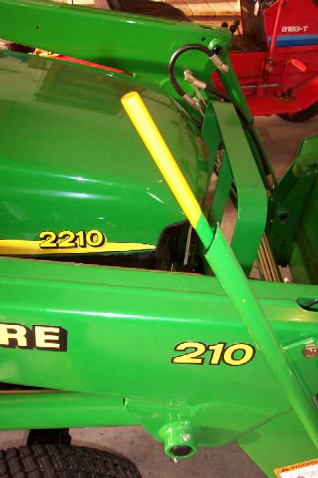

It's a little closer to 3-1/2" on the 210 loader. Here's a pick showing a simple painting of the tip of the rod with "school bus yellow" enamel with two coats of clear acrylic to slow the wear. I figure the paint will be worn off sooner or later, but the acrylic might make it a little later. Now, if I see all yellow, I'm diggin'. I'll probably end up marking a couple of angles with a Sharpie as I learn a little more about the loader's capabilities.

I have a 410 loader, what I did was get the bucket level, then cut the rod off flush with the tube(its at an angle) then painted the top of the rod. so when you dump etc you can see at an instant when the bucket is level again. woorks great. /forums/images/graemlins/cool.gif

Gary,
Make sure your tube is long enough so that when you tip the bucket way forward that the rod does not fall out on you.
What I actually did was put some colored tape on my rod which then I had a couple of different angles then.

I was also very concerned with the rod falling out on me which is why I didn't cut it off as well. In fact I just painted mine last night. /forums/images/graemlins/cool.gif
