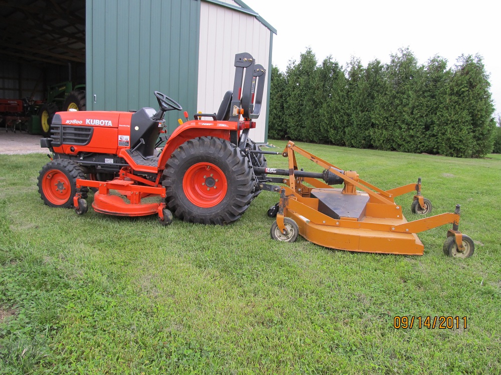

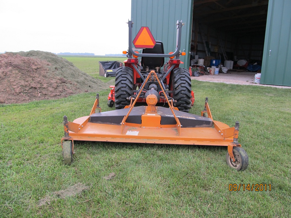

My current mowing setup is a 7 ft pull type Woods RD8400. Recently I put new blades on and the difference in the grass quality is amazing compared with the "before" blades. I mow at 3 1/2". The mower also doesn't clump the grass clippings any more either but distributes them evenly. I'm now sold on sharp blades.
I know to sharpen them when they are dull and need it but how often is that for most people? And do a given number of sharpenings mean you replace or do you just keep sharpening as long as there are no nicks in the blades? I hear everything from four times a season to every four years. What do others do?
Also, the owner's manuals say to not sharpen the blades to an edge but, in effect, leave them with a dull radius. Why? It doesn't sound right so it that advice just a liability issue?

First off, your tractor is way too clean. :)
I like to even have sharp bush hog blades, but not so easily kept up with. I have flint rocks that are up to large potato size. I try to pick them up, but they keep spawning. They take their toll on the blade's tip, rounding it off where you need it sharp.
Sharp blades cut through grass easier and save fuel. In Bahia grass, I have to slow down as it lugs down my 4310's 25 pto hp. Sharp blades help it cruise right on through.
/ How often do you sharpen or replace mower blades?
Tractor not quite that clean. Date shown in photo is 4 years earlier. :D
But I do wash them either once a year or every other year and I am fundamentally (wife says) pretty sloppy otherwise. This tractor is a dedicated lawn mower. Used to be I used the 6' belly mower but the 7' rear blade does a better and faster job. :)
