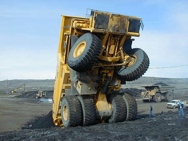

I think this may be to much!
/ How much weight is too much? #9
/ How much weight is too much? #10
/ How much weight is too much? #11
I have learned in construction or mining those guys could bend a crow bar in a sand box!!:D
NOTE: I am not trying to offend just be humorous.
/ How much weight is too much? #12
That doesn't seem possible with a truck that big - even if dumping or going uphill.
Severe off road conditions, not uncommon, the articulated ones go over sideways all the time, it isn't even an attention getter.
My buddy has a small one and he said when the back end goes over, sometimes the cab stays upright, they just throw a chain on it and right it with a heavy excavator.
