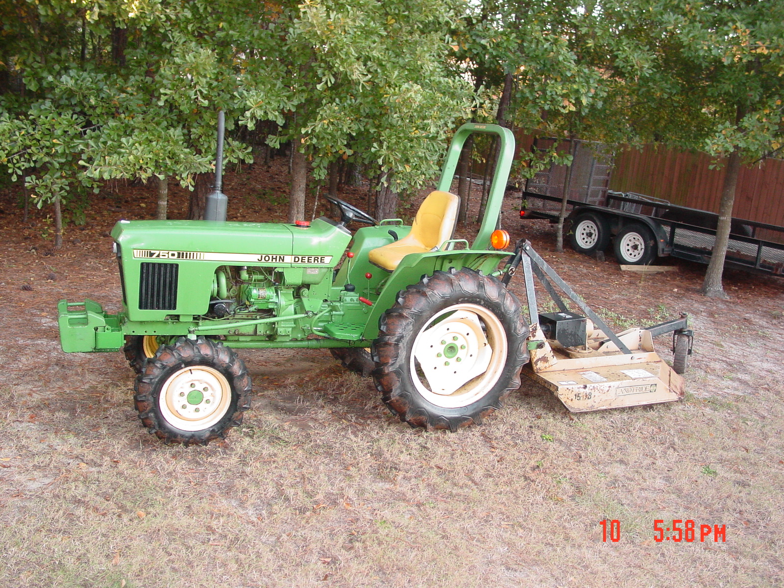

I used to have a Land Pride 15-48 bush hog, great piece of equipment and very well made. I used it behind a JD 750, which was a 21hp tractor with about 18hp at the PTO. I always thought that was a great combination, and the tractor handled it quite well, although without extra weights up front it would get light on the front end with the mower raised up (especially going up grades). Imho, I would get a tractor from about 21 to 24 hp to run your 4ft bush hog. Anymore than than that and you could really move up to a 5ft BH. Btw, I bought my Land Pride from a local dealer for $400 used, but had them install new blades for an extra $50 before I picked it up. Of course, that was probably about 15 years ago.
