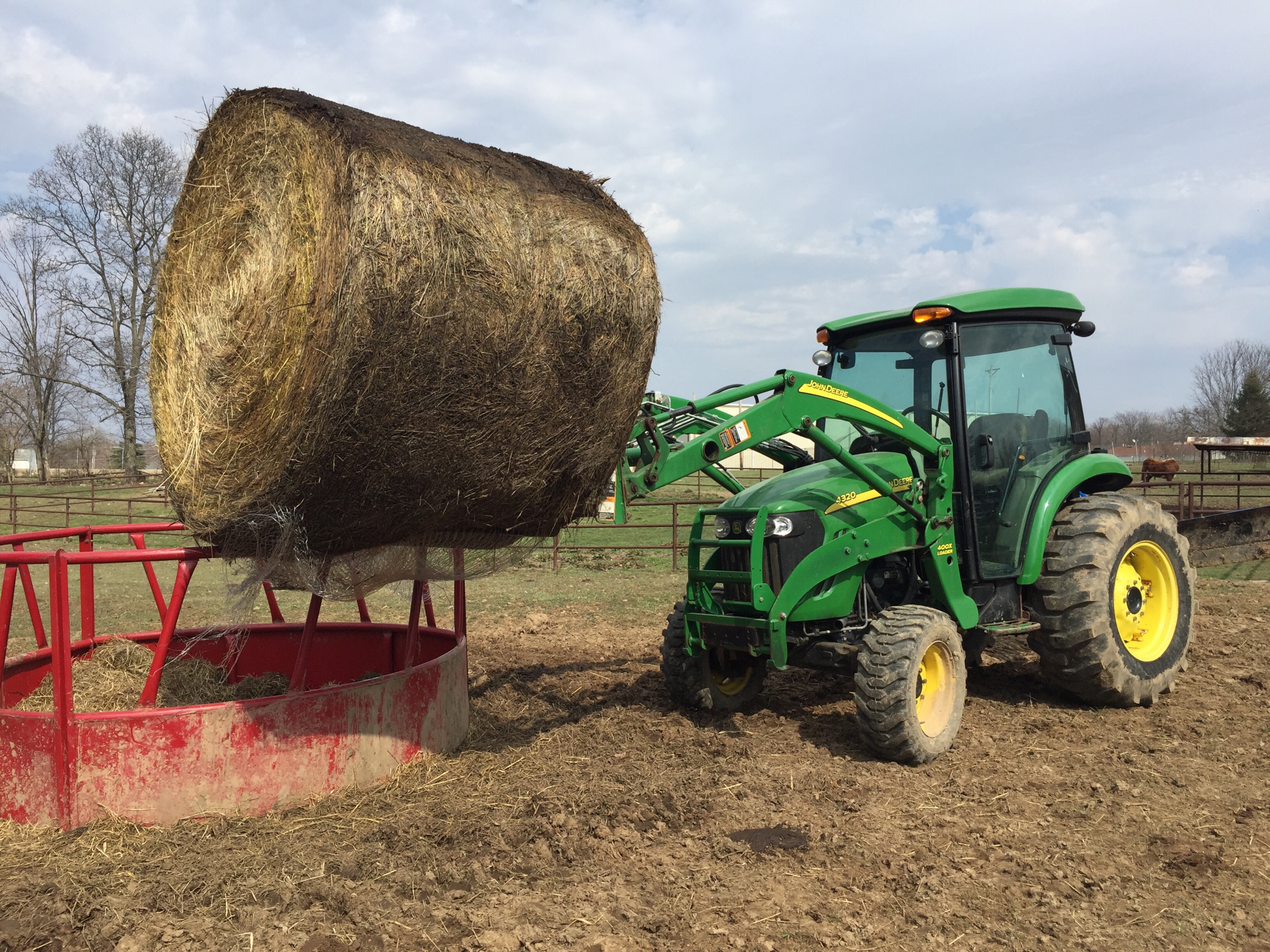

My story started much like yours, I didn't have a tractor, never have but I researched the crap out of them, I calculated the exact tractor I needed based of FEL lift capacity, in the 30-40hp range I was gonna sign on a Mahindra 1533 HST but was on the fence about the 1538 HST. I looked at NH, Case, Mahindra, JD and Kubota and found the Mahindra to be the best value for what I needed. Less than a week before signing my dad found a used JD cabbed 4320 in one of those tractor trader magazines, we drove the hour and half one way to check this tractor out, the guy was a farmer that had a used machinery dealership kinda business on the side. So the Mahindra was 33hp and could lift 1500lbs, the JD was 48hp and can lift 1800lbs, way more tractor than I even thought I needed, I fell for that tractor and shook hands with the guy. 2 weeks later I brought it home (financing delay).
My use for a tractor is handling round bales for cattle, 6 months later I'm really really glad I didn't buy a smaller tractor, I find myself thinking that my tractor is borderline as small as I want and could see myself using a 5 series, the bales I'm buying now are over 1000lbs, prob closer to 1200lbs but with pallet forks my loader has a hard time curling them from the weight being so far away from the pins.
So I guess good luck, research for awhile, pay attention to what guys like and don't (some tractors require you to be a gymnast to operate them correctly)(duel brakes, deff lock and directional HST at the same time)) and get first hand experience anyway you can.
