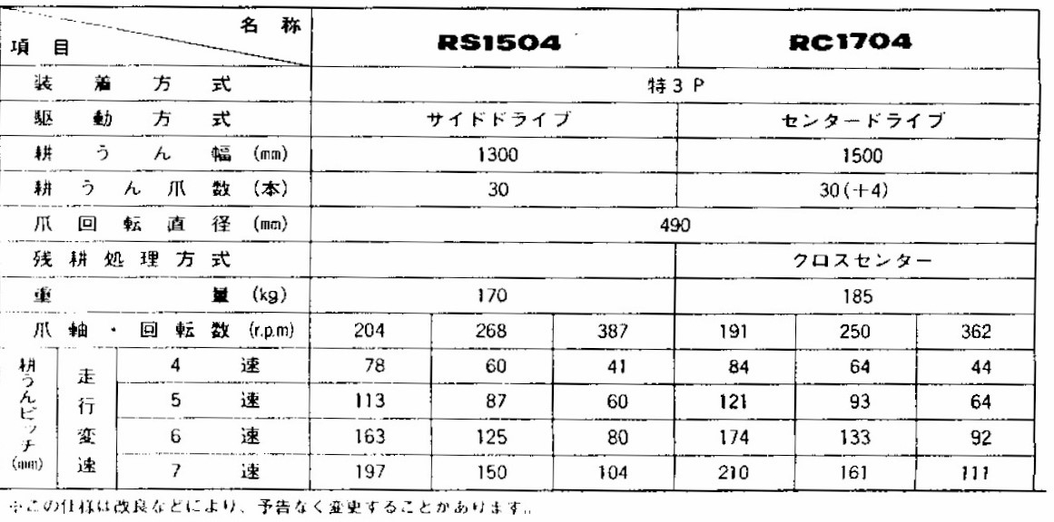

Eric,
Did you ever download the - - -
YANMAR YM2310 PARTS MANUAL NPC-1181.pdf
On page-5 it already tells you the maximum capability tillers to use with your model. :)

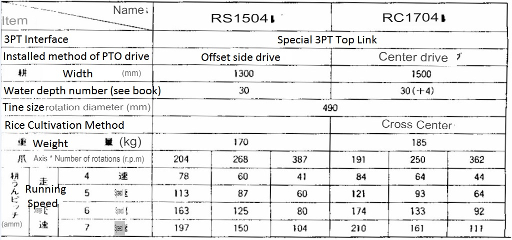

Here's a hint:
Oh, we can run this thru the Yandex image translator to English to get ...
/ How much tiller will 2310 handle? #9
Eric,
Here's a hint:
Hey, I forgot to add the manuals for those 2 tillers in the last posting.
Here are the OE tillers made by Yanmar for your YM2310. ;)
  • YANMAR TILLER RC1704 RS1504 PARTS MANUAL.pdf

I did download it. Just to look at the parts in the exploded diagrams. I guess I need to sit down and translate all the pages and then print them. I had no idea the parts manual also had info about attachments. And about rice cultivation. Rice is a grass, isn't it? I know bamboo is. And I will be planting grass because the soon to be tilled area is a drainfield. Thanks, I love this forum.
Eric

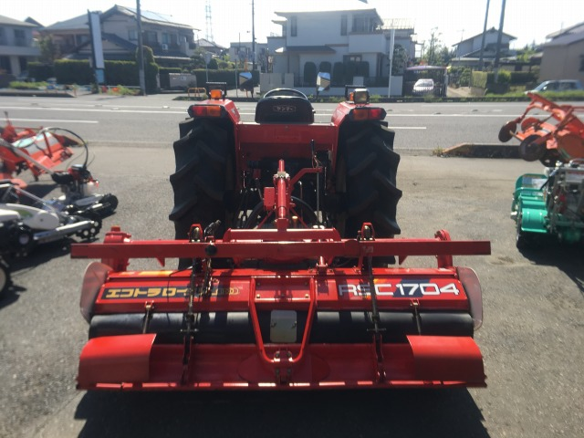

It would be really nice to get the OE Yanmar tillers over here. I know Ernie thought so too, but American people didn't think so.

Try these 2 image translator to text sites. The better the image characters are, the more reliable the translation.
Both work with copy-n-past right off the web too.
If the 2nd site translates in the vertical columns in Japanese, there is an option to 'not join lines' when you hover over the boxes. This really helps a lot.
The VN refurb importers - and Ernie, who imported good used Yanmars - assumed Americans wanted the tillers that had been on the refurb tractors forever. Nope. They didn't sell well here. Ernie said he took a load of salvage tillers to the dump. :eek:
Here's my tiller as found. The last green one, no pto shield. I told them I just wanted the cheapest one. "Ok, how about one with the tip missing off a single tine plus a set of new tines thrown in. $200?"
Oh H-- yes!
I never have replaced the tines. I can't see where there's any need.
