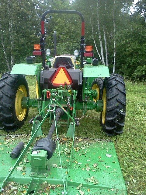

OK by me on posting the pic. I had posted it before so didn't want to repeat it to the point of boring readers. As to the tire positions , they measure from center to center of the tire so tire size only matters on the total out to out clearance. So a 5075E set position H will be 71.1 inches c to c plus 16.9 inches (half a tire each side) for an out to out of 88.0 inches and a clearance between the tires of 54.2 inches. That痴 15.3 inches wider then if it is set now at position D. That痴 a world of difference going over a stump especially if you have Rim guard in the tires.
Edit to add: Mine measures 94.2 out to out and 67.0 between them.

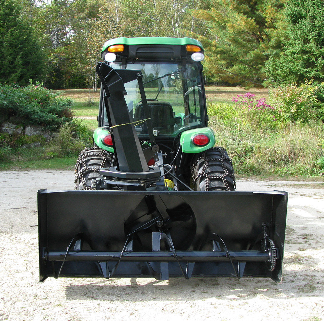

I'm not adding any new information but here is my 2 cents (if that much)...Five years ago when I bought my 3320 I realized that I couldn't easily fit chains on the tractor...so I installed maxi studs front and back....helped on glare ice but no help in "greasy" snow...so I did install extenders and chains...the extenders were originally only installed to improve stability...but once that was done I said what the heck...drove to Skowhegan and picked up the chains...this pic is from this past September...you can make out the studs on the rear tires (the only reason the snowblower is onTractorandmeteor.jpg is because I had moved it out of the barn for some touch up painting)

Bennatti: Nice looking snow killin' machine. Whose snow blower is that? Ah, must be nice sitting in that cozy rig, out of the wind and cold, probably with some tunes playing and a nice cup of steamin' cocoa.

Its a Meteor....my previous tractor (JD 850 - no cab)...was not a pleasant ride when snowblowing!
