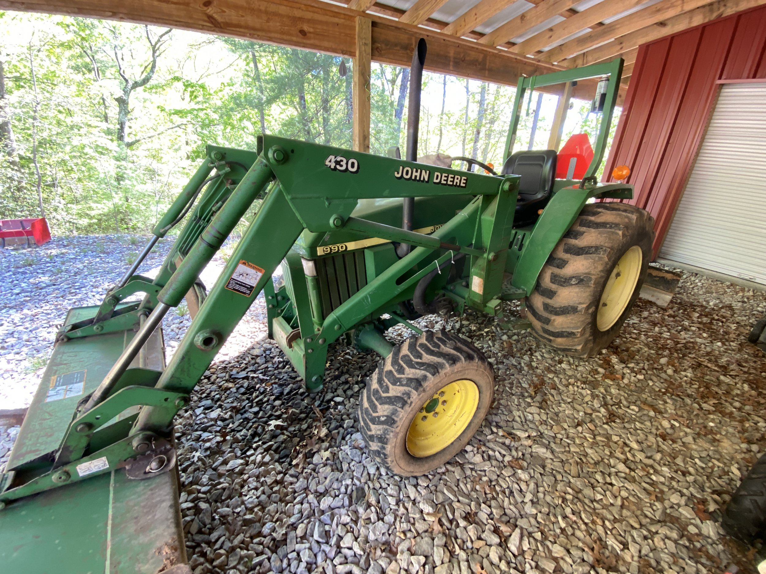

I have a JD Compact 990 MFWD with a box blade and loader. I wanted to use it on a steep dirt "driveway". A fwd pickup can navigate, but not sure about the tractor. My tires are not in the best shape.
So a question to you more experienced operators... will the tractor go up this appx 30% slope OK ?

If your truck loses traction you can step on the brakes and ALL 4 wheels will stop you. If your tractor is in 4x2 and one real wheel slips....you have no brakes. In 4x4, at least 1 of the front tires can be stopped. If you do need to stop, drop your loader and 3pt implement....they are your anchors. I have driven on much steeper hills than that. Take your time and study your angle of approach and keep your bucket low.
/ How much slope ? #3
Keep loader low and make turns slowly. Agree with all ruffdog said.
/ How much slope ? #4
If it's super steep, back up it with the loader low. That way if the tractor starts to "wheelie" you can keep it from going over. An implement on the back won't keep it from going over backwards- the 3pt arms don't resist force in that direction.
I go up grades steeper than 30% without issue. Make sure you're in 4wd though.

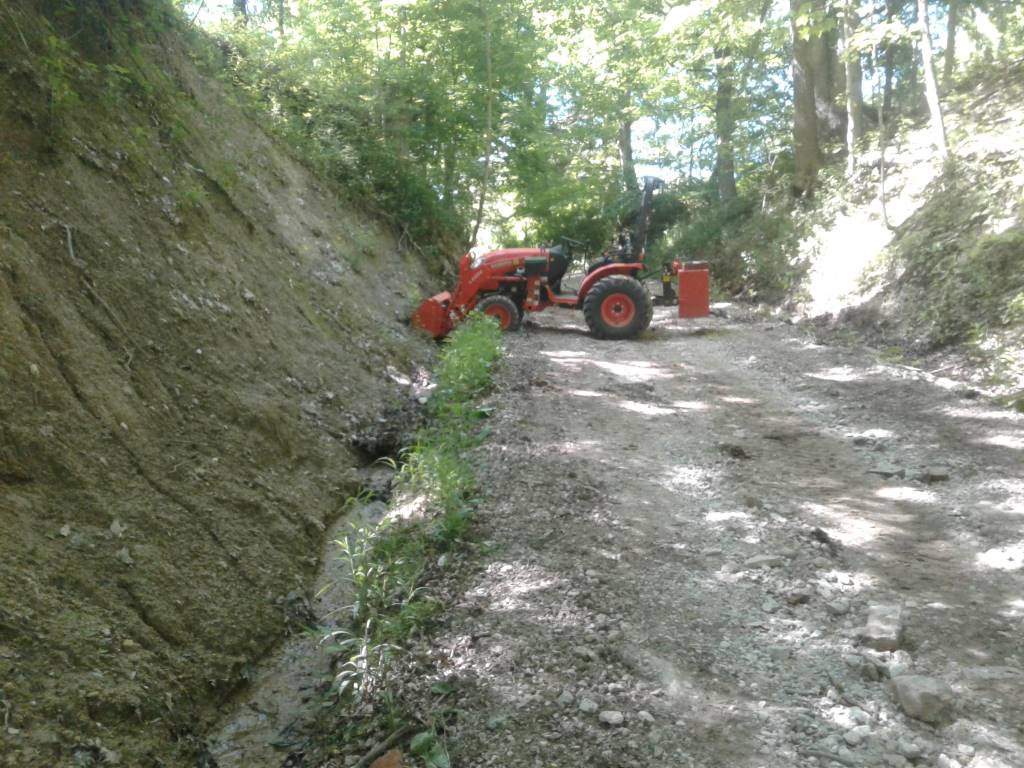

Can't tell amount of slope in photos. Adding liquid ballast to rears and adding weight to box blade will provide extra traction. This is how I clean my drainage ditches (B2650, loaded tires + ballast box) Doing this job with a BX and air filled tires prompted my desire for a 2nd tractor.

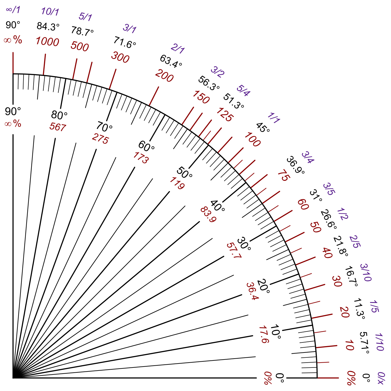

Is it 30% or 30 degrees?
A 100% slope is 45 degrees.
A 30% slope is only about 16.75 degrees.
A 4:12 roof pitch, which is quite low, is steeper than 30% at 18.43 degrees.
My front wheel drive Impala goes up angles steeper than that.
Always keep your MFWD engaged, go slow, keep your bucket low, and be prepared to push it down, not float it, and drop your rear implement if something would happen. Always wear your seatbelt, keep the ROPS up, etc. You should not have an issue going straight up and down at all.
