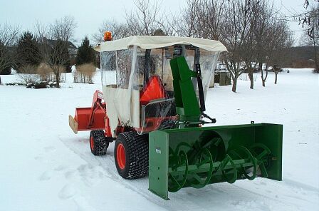

I have a BX 2200 with 22 hp, and a 54 inch; 3 pt snowblower, it had no problem handling 24 to 30 inches of snow. Did 10 driveways all at least 75 to 100 yards long, 12 to 18 feet wide, took about 4 hours. Unless you go to a 72 inch snowblower, which will need more then 24 hp, 54 or 60 inch blower is not going to make that much difference in time. A full size compact will give you better ground clearance, although I had no problem getting around with turfs and loaded tires in 4 WD in all that snow. If you have time to kill, 18-24 HPO is not going to make a big difference at the end of the day snowblowing. The heavier tractor may cause you problems with your pawn depending on your soil conditions and age of your lawn.
