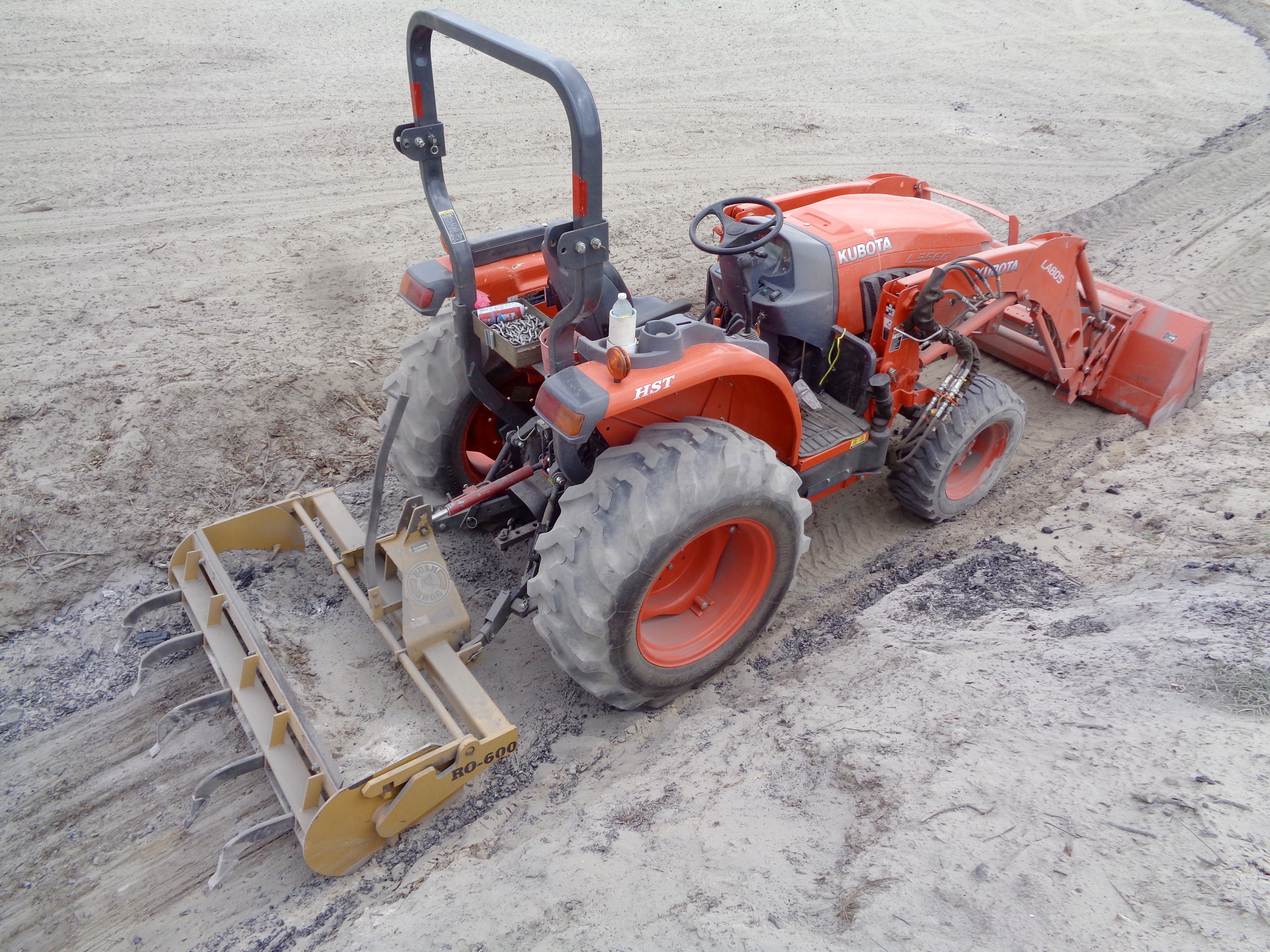

Now that I have bought my first tractor I've been researching tractor ownership.
One item I see is ballast. I'm getting the rear wheels filled so would just carrying around a box blade in the back be enough ballast for most of my work?
Or would I need to buy a 3 pt ballast box?

It really depends on how much weight you intend to lift with the loader. These tractors (I have one) are very light in the rear. Dare I say almost dangerous. A heavy box blade and filled tires is the minimum that I have on mine when doing any loader work. Even that isn’t enough at times. I live on a hill, that contributes to the need for a lot of ballast as well.

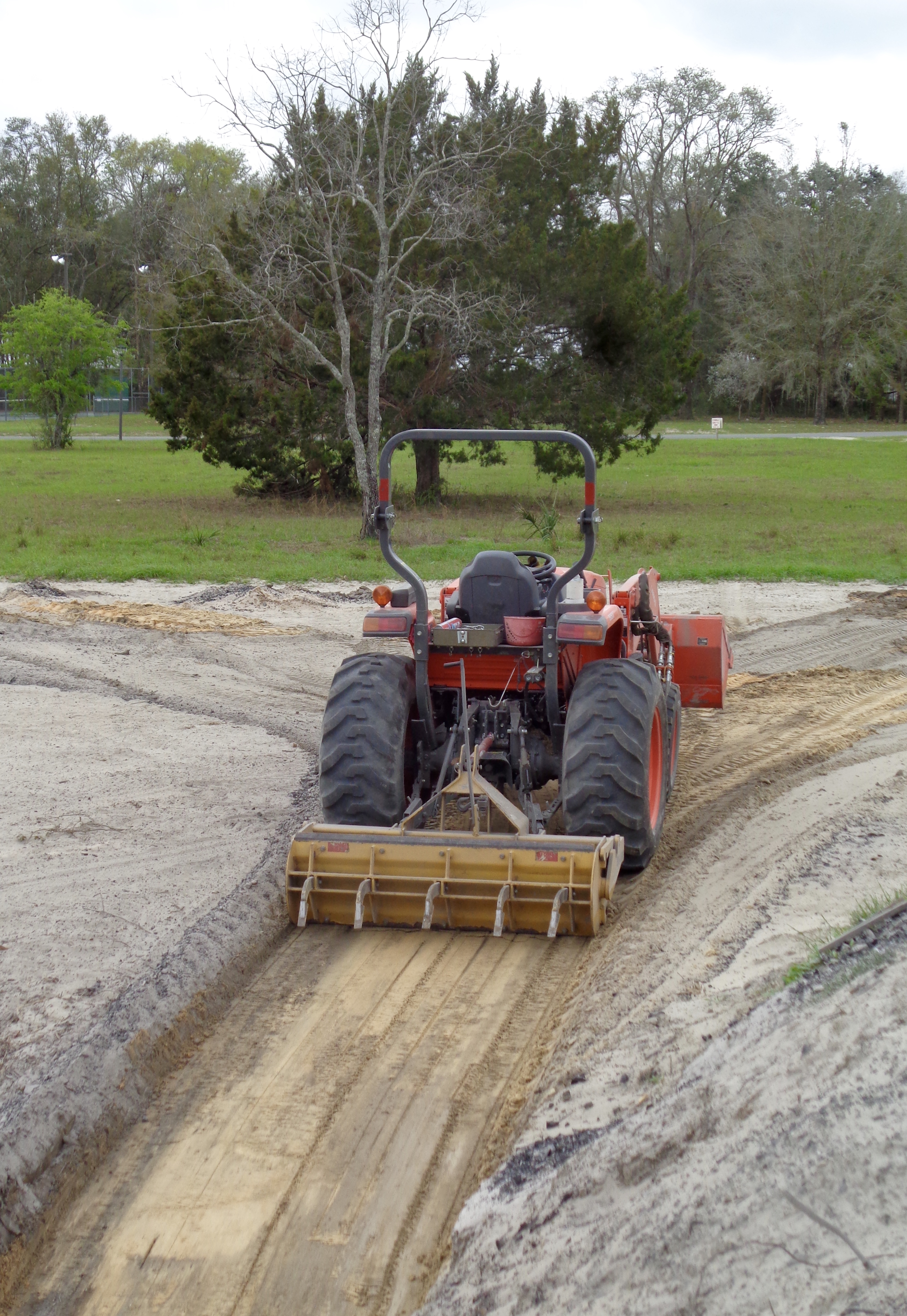

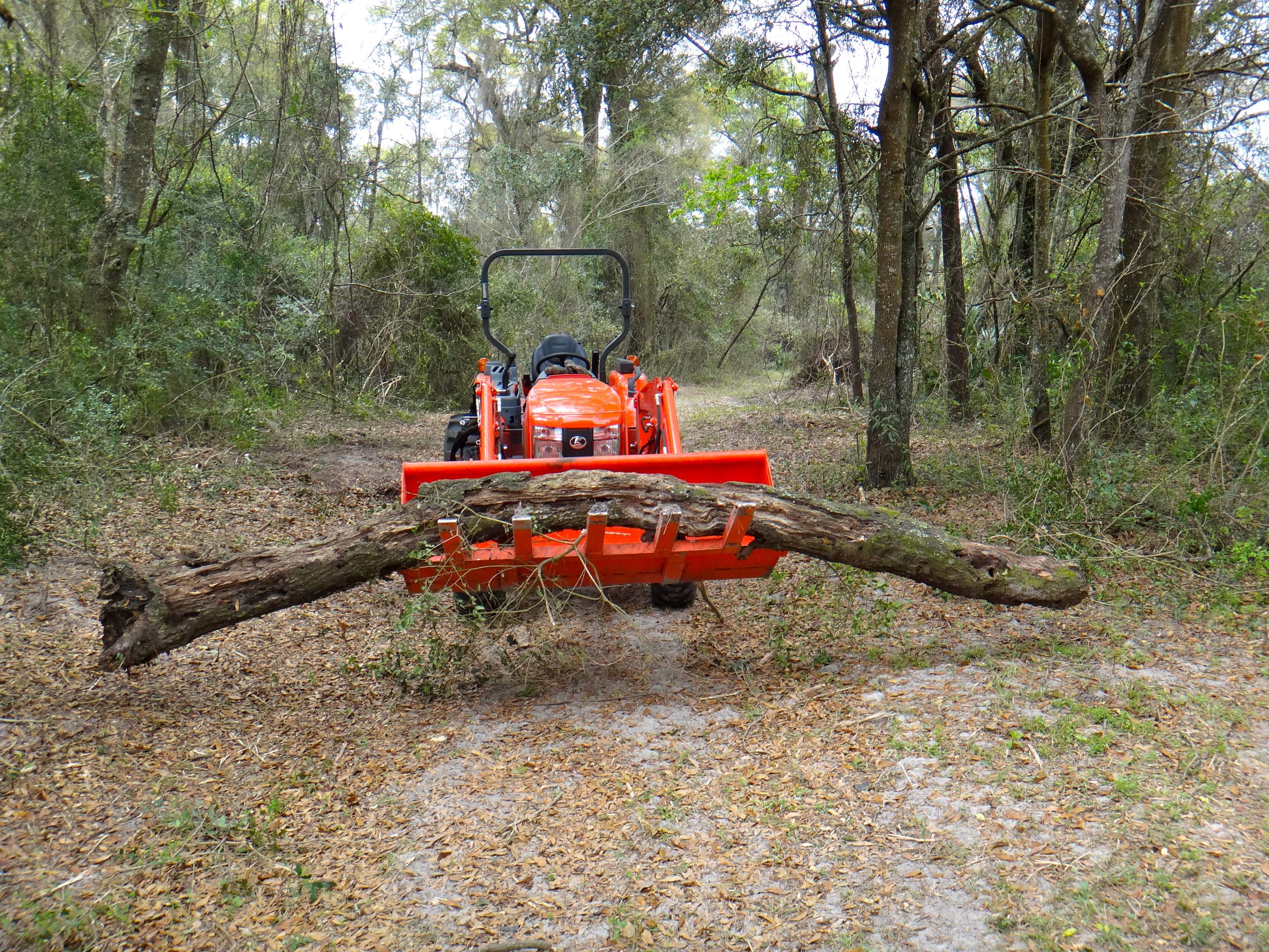

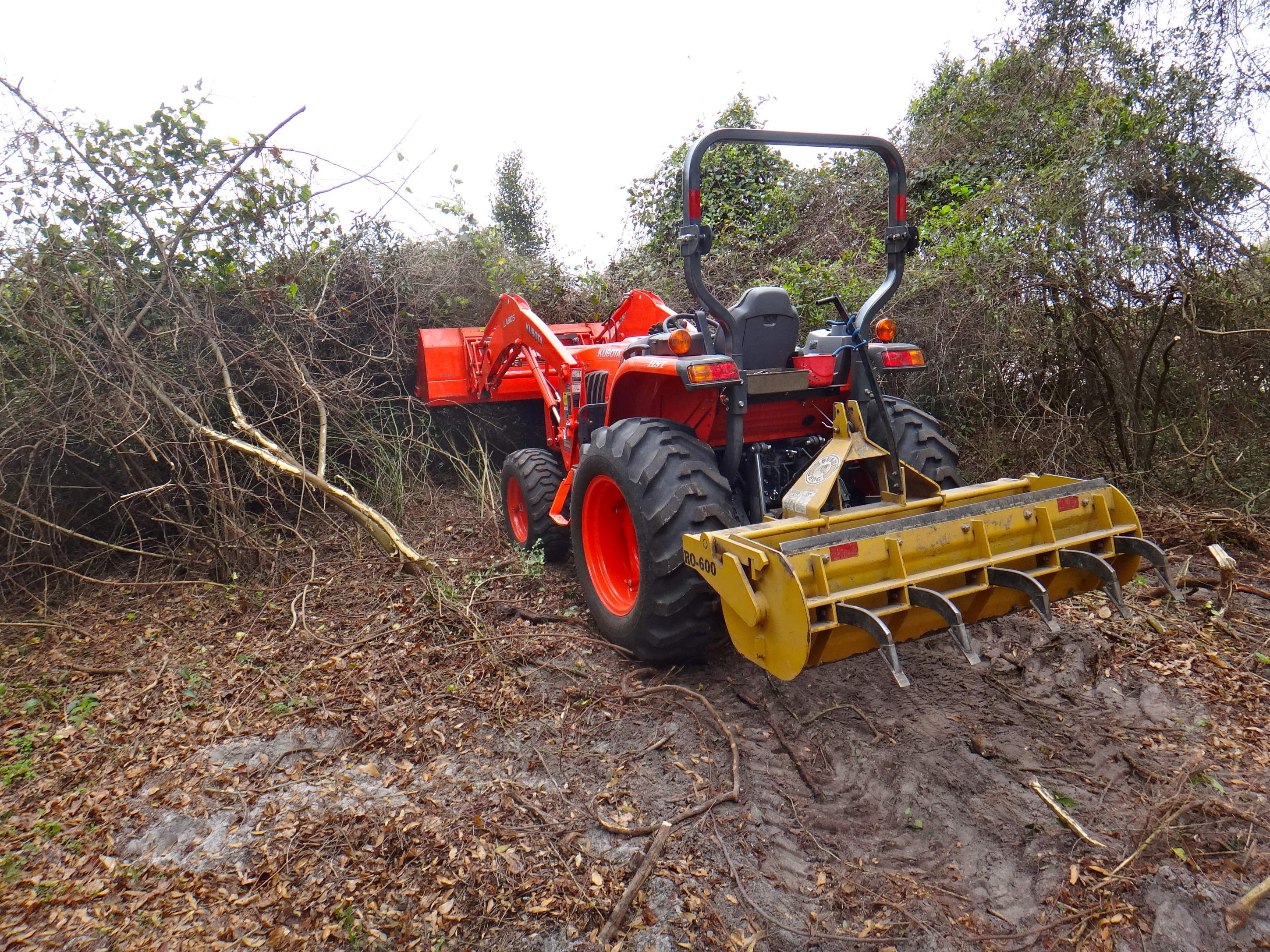

Box Blades and PTO-powered Roto-tillers are implements often used for Loader counterbalance.
Box Blades vary considerably in weight. Buy heavy, eighty pounds per foot of width. You will probably want a 66" or 72" wide Box Blade. Research Rollover Box Blades too. PHOTOS.
A Box Blade and filled rear tires will be ample ballast for any/all L3301 Loader work. LA525 lift capacity = 1,400 pounds.
Ballast Boxes are mostly for garage stored tractors used for Landscaping, where storage space is at a premium and implements other than a Loader are not contemplated.
Insert L3301 into your T-B-N PROFILE.

1000# if the weight is in close.
700# if its a few feet back

I would not waste my money on a ballast box. It won't do any work for you. Get a heavy box blade. At least, it can do work. Need more weight than the box blade - add bags of sand, chunks of RR iron, etc to the BB when doing heavy FEL chores.
Also - don't go overboard and exceed the limits of your 3-point system.

I have 800-900# total for the ballast box on my L3200, which is similar to your 3301. It's a good amount overall. I tend to leave it on full time unless I have to use an implement instead.
I used to rely on my box blade for ballast, but it was large and unwieldy in many situations, and not heavy enough (I was always having to pile additional weight on it, which made it even more unwieldy to use). The ballast box is a lot more compact sitting behind the tractor. The increase in traction is amazing.

The guy asked how much ballast for the 3PH and he is loading the tires. 700# in the form of something ~2.5' or so back is sufficient. 1000# if in closer. 10 years and 1000+ hours on a L3400 with either a 700# rear blade (COG 33" back) or a 55 gallon barrel of concrete tucked up close and weighing 1000#. The combination is stable and sufficient. And you arent gonna lift a back tire unless you stomp on the breaks going down hill with max load in the loader.
With that combination....if I was lifting 200 or 300 pounds up front....the weight on the front axle is LESS with the ballast.
...................................if I was lifting 500 or 600 pounds up front....the weight on the front axle is LESS with the ballast.
...................................if I was lifting 1000 pounds up front.....well it wouldn't lift it without ballast. BUT, having the 1000# barrel on the back results in LESS weight on the front axle vs having a 300-400# implement on the back.
