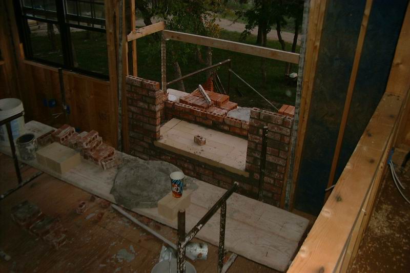

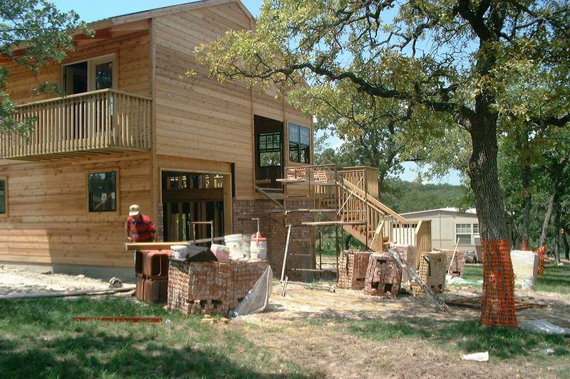

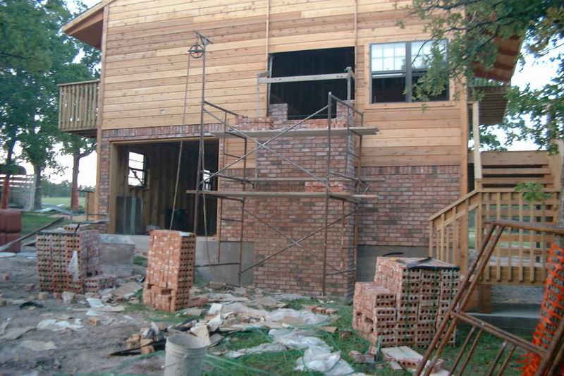

I should have taken more pictures at the time, but here are a couple more. As you can see, there is only about 4" on each side of the firebox and none behind the firebox. Also in the outside picture (2nd one), the stack of brick in the middle are not the same as the casement brick. They are cheap brick used to fill in the middle of the fireplace stack and around the tile flue. In the last photo, you can see the huge tile used for the stack. If I had asked for it, we probably could easily have made the fireplace a bit wider and put in a second flue or used smaller tile and allowed for two flues. Hindsight is so wonderful.:rolleyes:

As a matter of fact, the casement is not hollow. The builder and masons ordered "filler" brick to lay inside the casement all the way to the top. Essentially, this fireplace is solid brick from the base to the top, but I don't think all the filler brick were mortared in as the outside brick and the firebrick. Some mortar was used for stability, but essentially the inside brick are just sitting in there with little to hold them in place.

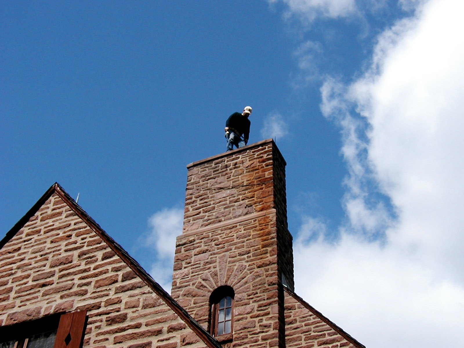

You know your house better than anyone, but that's not normally how it's done. Typically there would just be a single wythe going up one or both sides of the flue to stabilize, those bricks would be mortared, to fill that whole core with dry laid masonry units would/could collapse the throat at the top of the FP under the weight. When the bricks are mortared in they transfer the weight to the foundation via the veneer.
Do you remember how they did the floor of the firebox, could of been done a couple different ways, usually double course walls up to the bottom of the fireplace and a bed of cement on a steel pan resting on the inner course. or a block or brick frame work coming all the way up under the floor of the fire box.
Either way there should be plenty of straight shot in most of that core, except at the fireplace, though that first pic you show here has some promise, you can see there is nothing at the back but at the inside corner where the floor of the fireplace is the narrowest, shows some space there. Hard to tell how much space, it's ok to ovalize stove pipe to a certain degree to fit a narrower space.
Anyway It might be doable but would require some intrusive and destructive inspection, which could be done from the outside or maybe the basement.
Your flues look large, hard to tell by pics but maybe 12x16 or 16x16?
Around here new FP usually has 12x12, 25 years or older and all are 8x12.
Just a couple of show off pictures of me on a huge house, I use to do alot of chimney repair, not as much anymore.
JB.

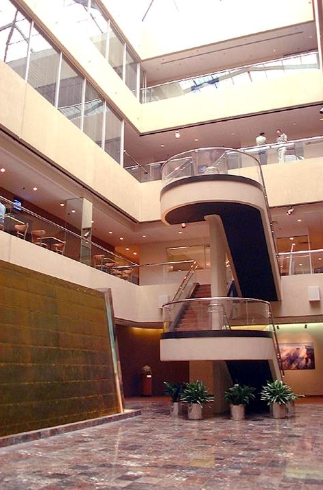

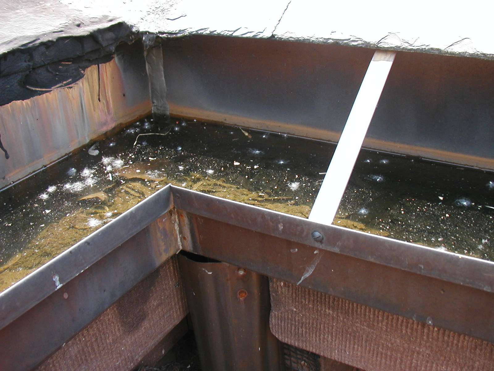

JB, what I based my comment on was also experience, but it may have been a faulty parallel that I used. Where I used to work, we had a big fountain in a large atrium in the middle of the building (see attachment). The fountain was copper clad and had to have repairs while I worked there. The structure under the copper was corroding away. Essentially, the whole fountain structure was rebuilt and new copper cladding added. In less than a year, that bright copper turned the color you see in the picture. Granted, it had water running over it 24/7, but it was inside and not exposed to any external elements.
BTW: I don't care if this thread wanders. I think I have the info I wanted and these side-topics are kinda fun.:)

Yeah, I'm not sure with the fountain application, with the constant water immersion, might have something to do with it?

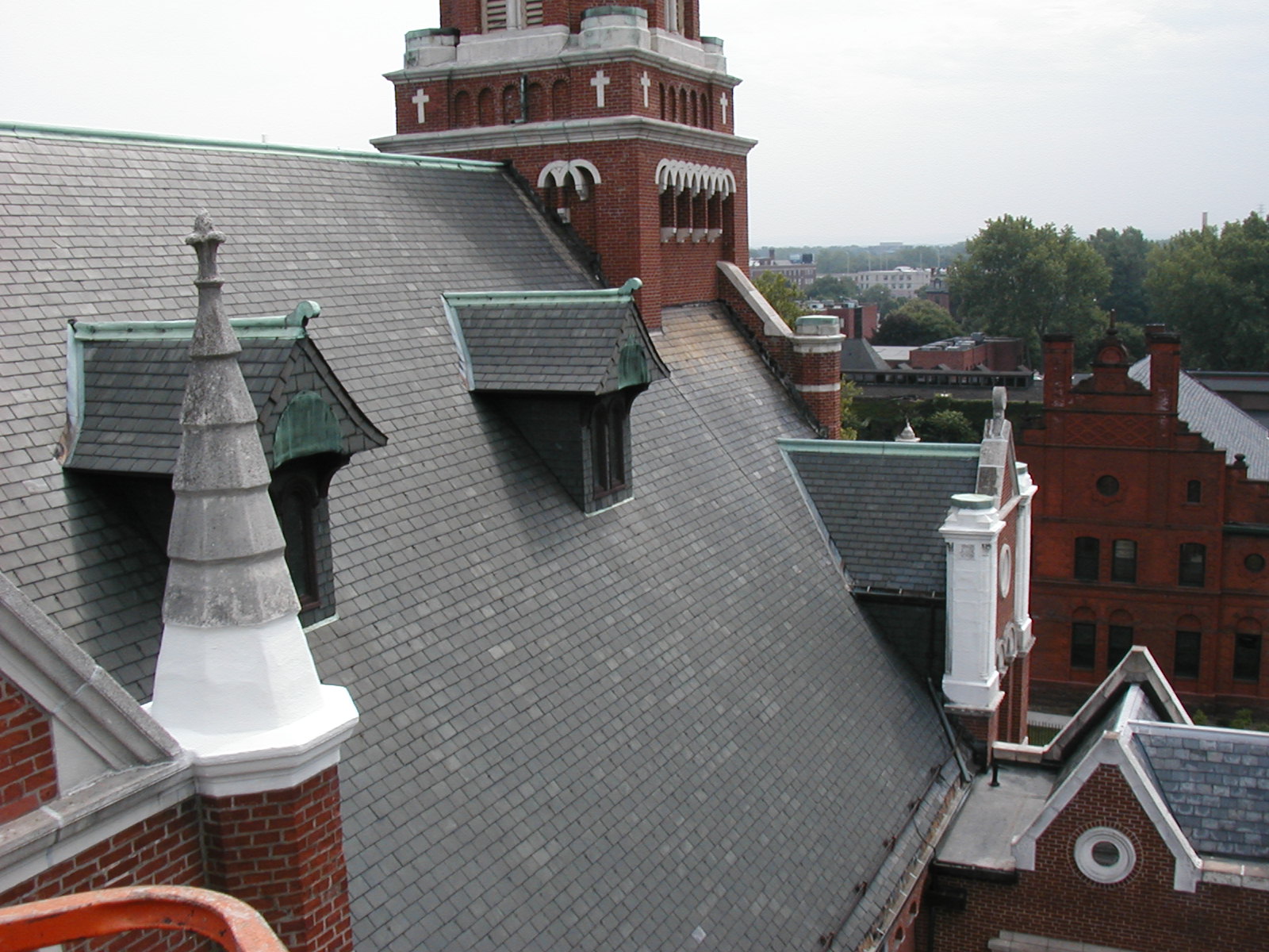

It takes about 7 years on the average around here for bright un-polyurethaned copper just to turn brown. I didn't treat it with anything. It does get warm up there when the fireplace is fully cookin', so the color change may be accelerated. Yo
I'm surprised about the 7 years, It may be due to location but I was being generous in saying it would turn brown in a season or 2. I've actually seen new bright copper work loose most of it's luster in a long weekend of rain! for sure after a year it's all brown around here.
At one time when there was more coal fired plants running, that would of sped up the patina process I think. Interesting to note, when the copper is getting to the end of it's service life, it turns orange again, not as bright as when new but it really stands out on the surrounding green, starts occurring where the water runoff is concentrated, at that time it is like carbon paper thin, and will tear/perforate easily, you can poke a finger thru it, makes it a little easier to find potential leaks.
In these random pics there is some 80-100 year old green copper in the backgrounds, everyday sight on the old institutional type buildings.
pic of copper gutter put up 20+ years ago (not by me) and still just brown.
