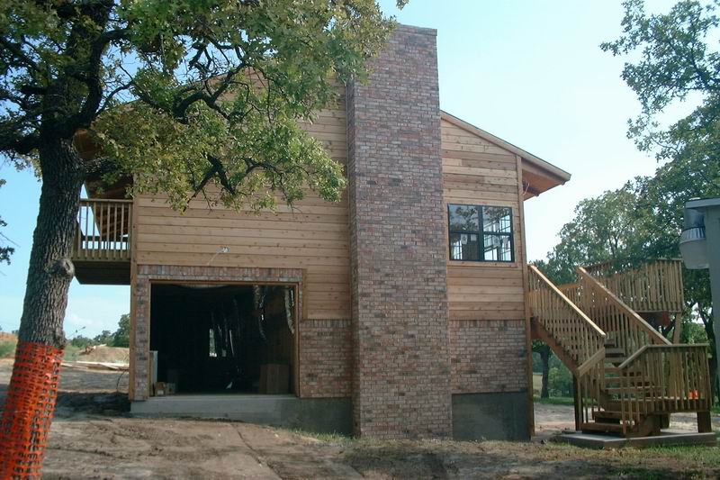

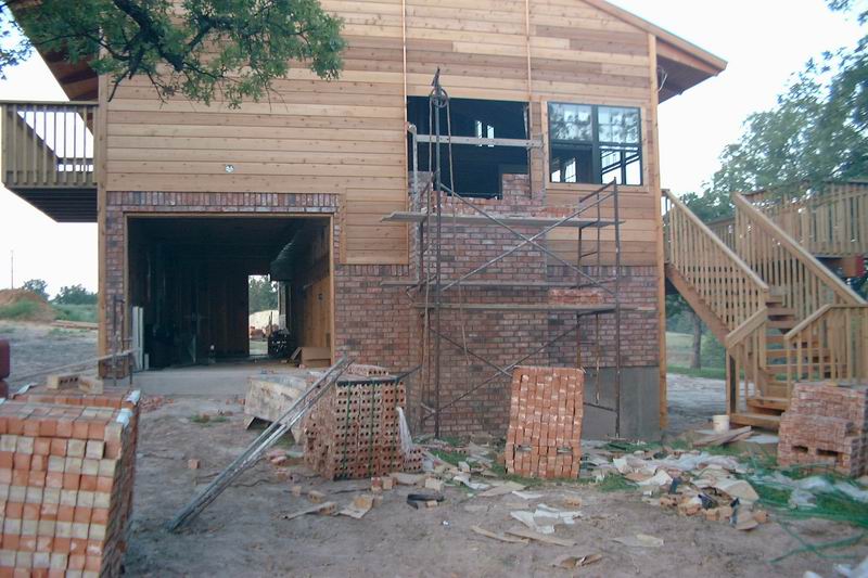

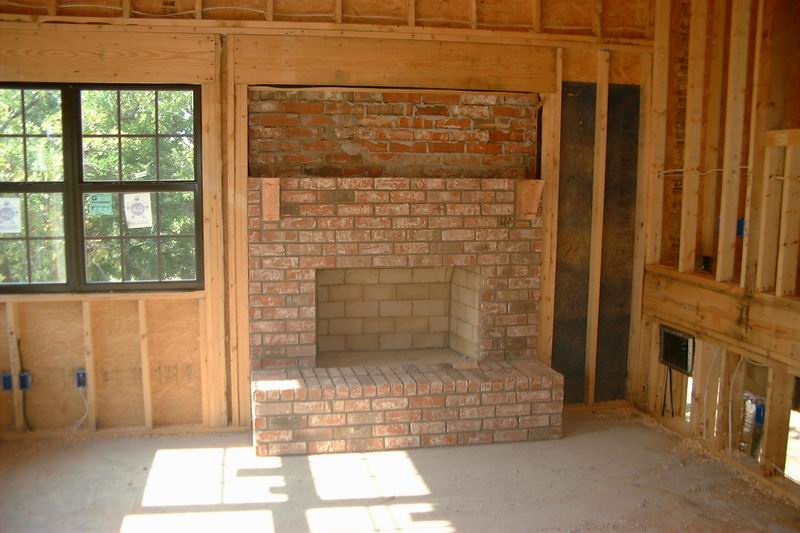

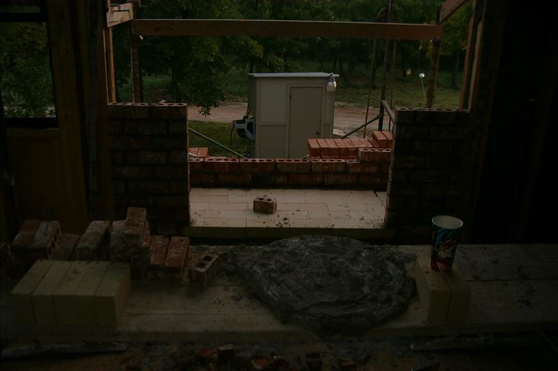

Moss, we have a regular (very large) fireplace surrounded by firebrick and what we have is not a damper, but a large rectangular door opening into the chimney. My use of "damper" was a misnomer. My mechanism for the door is stiff enough that I can close the door down somewhat like a damper but with nowhere near the accuracy of a true damper. I'd say I leave my door open 1/3 most of the time and that's enough to have plenty of draft and not leak any smoke out into the room. Our chimney is made of tiles surrounded by filler brick and then outside brick and mortar. The fireplace is a little unusual in that the brick starts on the walkout basement level and the actual fireplace opening is on the floor above. If I had been smart, I'd have asked the contractor to include a metal chimney up from the basement level and have dual stacks within one brick enclosure.
Construction pictures are shown attached.

Nice looking fireplace and raised hearth,

Jinman, you should be able to fit a real nice airtight insert into that fireplace!:D:D

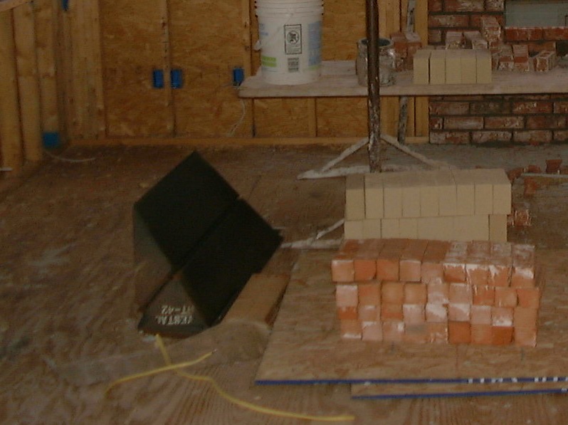

JB, you are correct. I went back and looked at construction photos and found the one below. My damper is a Vestal HT-42 High Top. Of course, my fireplace doesn't add much if any warmth to the room, but it sure is toasty if you stand in front of it due to radiant heat. If we ever want any real heat from it, we will have to install an insert as Egon suggested or completely redo the fireplace with blowers and ductwork to attach to our central heat/air system. Right now it is mostly for looks.
Our wood is split oak. The wedges are 6" maximum at the thick side by 16" long. The heaviest is about 10 lb with most being in the 7 lb range. We split trees that have been dead and standing for about 3 years. Blackjack oak is a very hard wood and burns best when mixed with postoak. If it is dry and you are cutting at night, you'll see lots of sparks off your chainsaw blade. I have not let my wood cure since I cut and split it. If it didn't dry while standing dead, it hasn't had time to dry since I stacked it. It is easy to start a fire with by using only a single sheet of newsprint and one small 1"x2"x6" starter brick.
I am far from a fireplace expert, but I leave a bed of ash under the grate and pull coals forward as they build up under the fire. It doesn't take much work to keep the fire going.

Sounds like you are doing well with the oak wood, and the only thing I would do different is get rid of the grates. Keep a few inches of ashes in the bottom, and they will support the hot coals, and let you get even longer fires from the same amount of wood. Don't need that much air circulating under the fire. IMO :)
And glad you got the damper name straightened out for posterity, if for no other reason.:)

Beautiful home you have there. :)

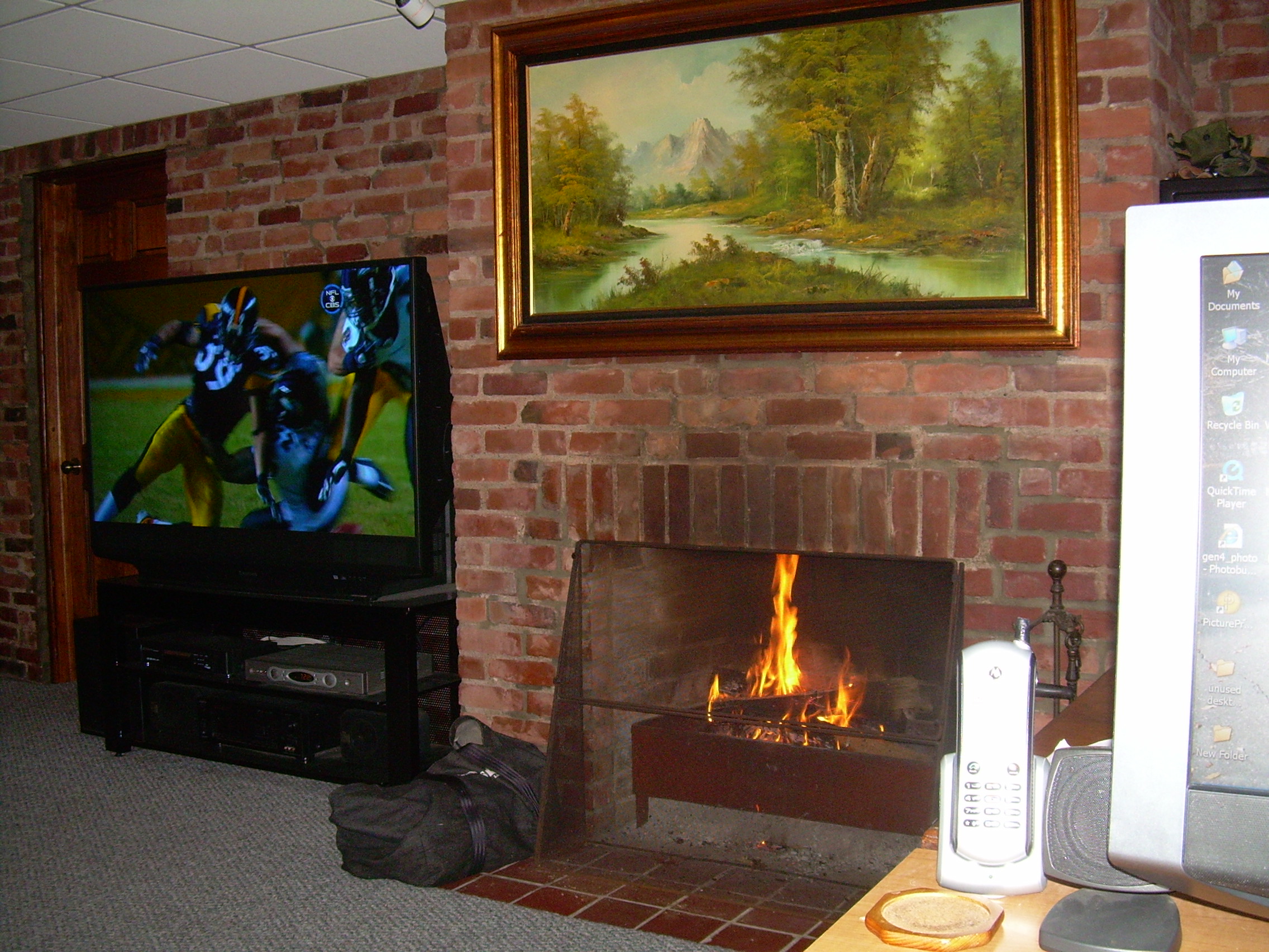

Here's a pic of my F/P in the basement cave, this one sits at floor level, I'd rather have the raised hearth of Jim's. I have a steel box to keep the logs in with a grate underneath, that raises the fire off the bottom about 4 inches. My house was built in 1936, there's another FP right above this one in the living room but we don't use it much except for the occasional fake log.
Thanks Moss. We love the house, but there are lots of things I'd change if I were doing it again. As time and money allows, I may do some of those in the future. Three floor levels with only one HVAC system is a challenge. Today, we have our main living area at 69-70 degrees, but my basement is only 59. I wish I had a wood stove there to boost the temperature a bit in winter. In the summer, it's the best spot in the house.
JB, I like your "cave" fireplace. It's easy to see that it's had a lot of use. I don't think I have any venting problems with my fireplace. In the morning I set my thermostat up from the night temperature of 62 to 70 and then start the F/P. With the damper door all the way open, I've never had any smoke or downdraft of cold air. It draws nicely.
