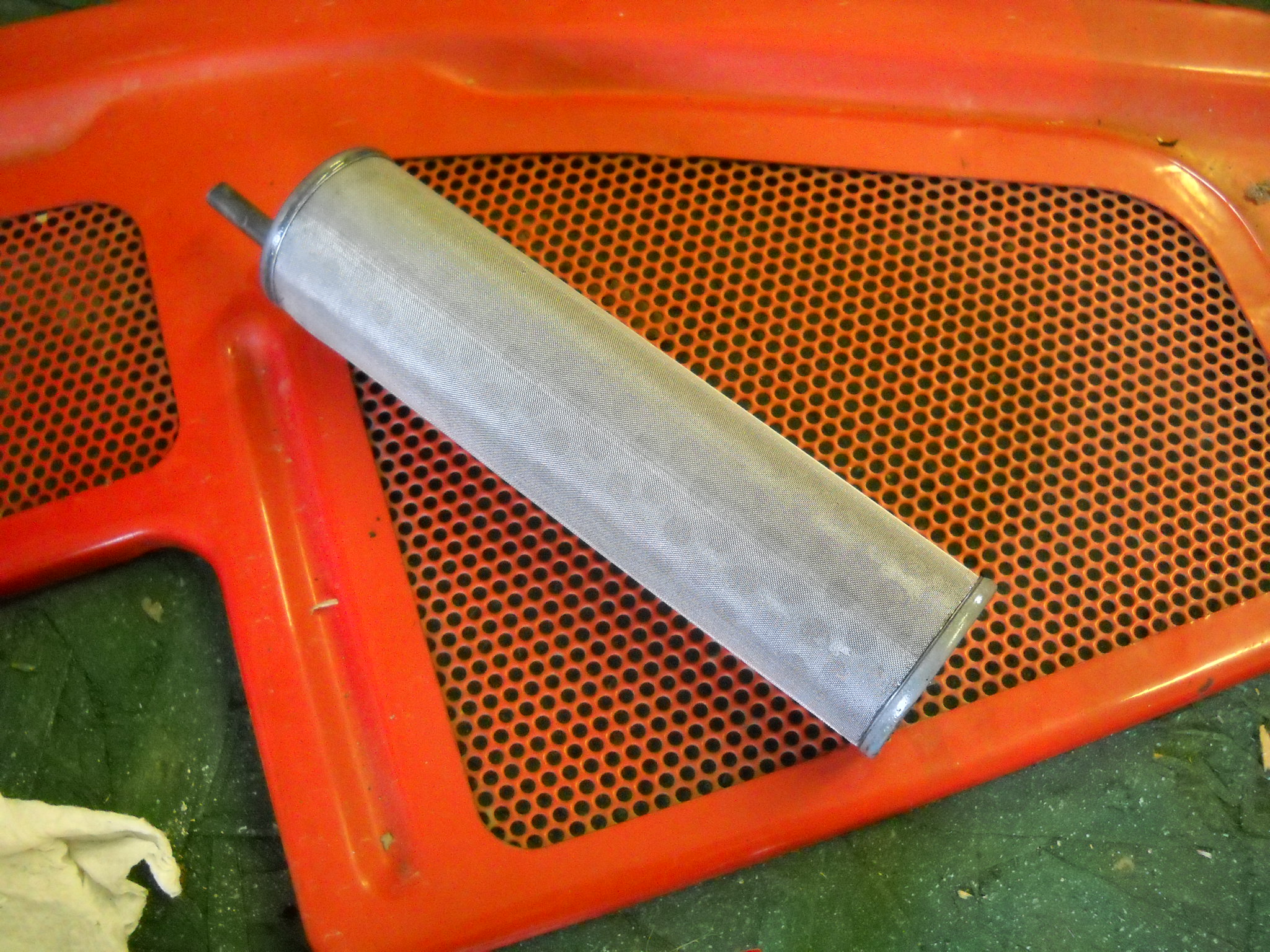

I can say that cleaning the hydraulic filter takes a little time considering having to wash it in gasoline and blowing it out with an air compressor.
Jake, please use something other than gasoline as we would like to see you continue posting for a long time. Try using mineral spirits, kerosene, varsol, or something similar. Granted they are all flammable; but gas seems to be the most volatile and dangerous.
As for the time it takes to do a major 200-hour service, I'm unfortunately in the Captain Slow camp. The worst is the mess I inevitably make draining the tranny and coolant, followed by the cleanup.
