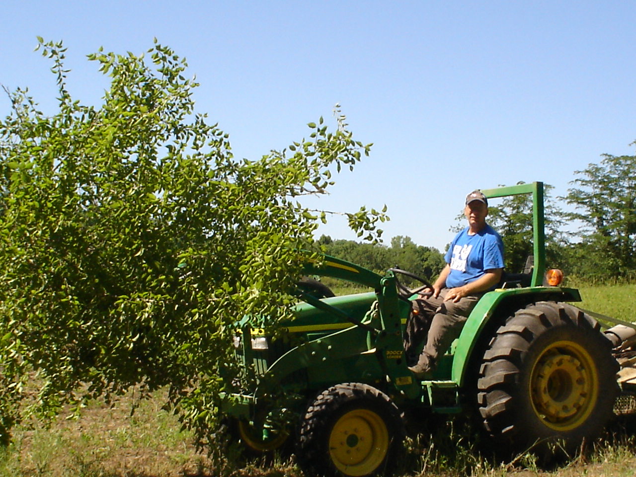

I currenty run an LX5 because I need to trim between the rows of trees, however in the high stuff clearing new fields, it never hesitates even in the saplings etc... even though I run the PTO slightly below the recommended 2600 RPMs for 540. I would guess a 6' would not be any problem for you (my dealer tried to get me to buy one but I needed clearance for the tree farm). I did not load the rears but opted for wheel weights on my R4's instead (weights don't leak). Only down side I have found so far is the top speed is only about 12-13 mph - which could be faster when moving down the road between fields, but I manage ok.

Cool Pics Mr Grizz.

Griz --- that's real impressive! Do you have weights and loaded tires? That culti-rake on the back doesn't look too heavy.
