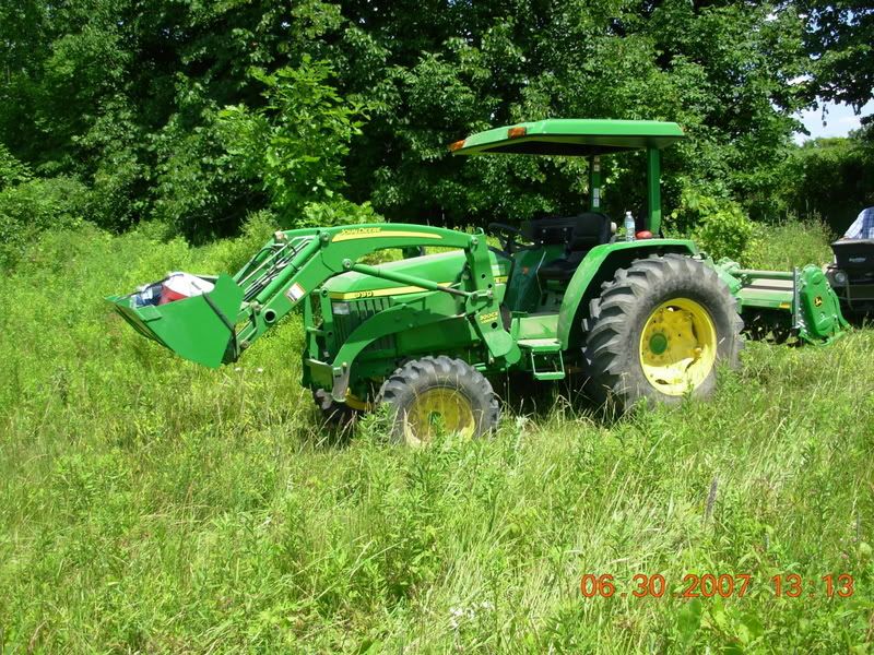

Griz --- that's real impressive! Do you have weights and loaded tires? That culti-rake on the back doesn't look too heavy.

I think the 990 is a FINE tractor! I looked long and hard when I was tractor shopping and the 990 was top on my list. The day I went to the Deere Dealer to buy one they offered me such a good deal on a 5105..... well.... I took it!:D
