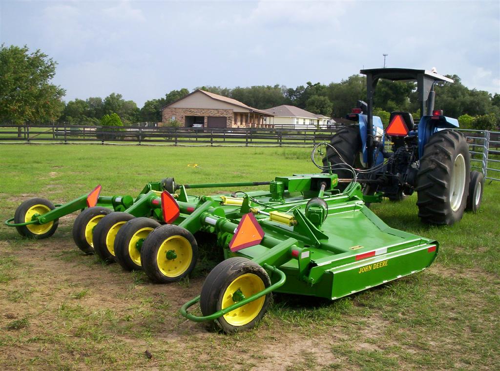

godflesh said:
There is no way anything any of us have can hit the tilt those machines hit. .
Plenty of the people here use 10-12-15-20' mowers..
Here's my NH 7610s and jd 1517 15' batwing.
