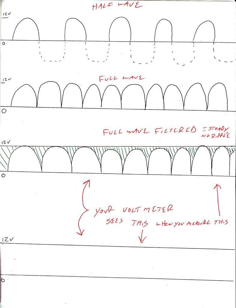

lol, I think our terminology is getting confused, caps don't fill holes ( as in a zero volt reference and up ) they smooth out " ripples"/"noise" of a specific voltage and are also used as storage cells. .
Your the confused one!
what you are calling filling a hole, as in the space between the crests of the positive wave form as compaired to steady state dc.. and YES, caps will smooth / filter that bumpy DC to steady state DC .
/ HOW DOES AC WELDING DIFFER FROM DC WELDING #68
here, this might help. and for the other EE's out there, this drawing is OBVIOUSLY not scaled.. freq, etc, waveform errors, etc. it's just a pictogram.
Skyhook... the first line shows half wave dc, an ac wave form ran thru a diode and it chops one half off as the diode oposes current flow in one direction.
the next line shows full wave dc, either a transformer and 2 diodes, or 4 diodes aranges so that the lower waveform is tossed 'up top'.. this makes for a riple-dc.
Now, if you take a capacitor and put across the ground reference and the positive test point. the capacitor will 'fill in' the space between those waveforms. ( of course you must have a large enough cap to filter with... loaded or unloaded circuit will effect that, yada yada..
the third line shows the full wave dc with a steady state line over it and a green hash shaded area.. that's what the cap is doing, the green shaded area.
to your vom, the 4 line is what gets reported... steady state dc.
I considered doing this drawing, but I was lazy. I am glad you posted it.:)
I realize it's hard for those that are not engineers or tech's to visualize some of these concepts, and how cap's and inductors interact with circuits voltage and current, etc.
hopefully the drawing will help. it's a bad drawing, but i think it will work. the signal 'generator' ( my hand ) needs to be calibrated. :)
Actually I though your waveforms were not bad at all. I don't believe I could have done any better.:)
