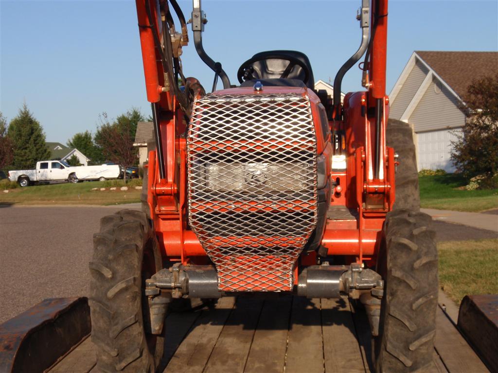

Update from the OP: got my new 16' landscape trailer on Friday -- only took a week to get it from the factory due to some lucky timing. Looks real good and tows smooth as silk. I was rained out today, but hope to load up the Kubota tomorrow and transport it over to my new property. I've got more chains and straps than I need, and will play around to see what works the best to tie the tractor down. I appreciate all the comments and suggestions here.

My Kubota dealer sold me the trailer (and is watching my spending spree with humor -- I'm already asking about a post hole digger, chipper, and land plane). For tying down the tractor, he recommended chains to the rear drawbar shackle, a chain through the FEL cross-tube, and then a strap for the box blade. I have at least enough gear to do twice that, and will experiment to see how it goes.

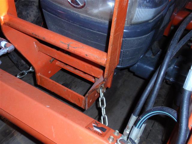

I am curious to know how various people do this -- I am looking into hauling a CUT on a 76"x14' landscape trailer (tandem axle with wood decking and rear gate). This trailer looks ideal for me, but doesn't have tiedowns, and of course with a wood deck there are no chain slots.
I know landscapers around here don't even tie their equipment down for local transport -- they drive on and set the brake.
Tie it down like its done in these pics that I took this past summer at a ATHS show in Macungie,PA.
What's the advantage to the strap/chain combination? It seems the strength advantage of using the chains is canceled by using those short sections of strap. Please tell me where I'm wrong.
   / How do you tie down tractors when hauling on a trailer? #196
The strap is to keep the chain from messing up the paint on the tractor.
The strap is an "axle strap" and is intended to go over an axle without getting cut.
Aaron Z
   / How do you tie down tractors when hauling on a trailer? #197
I personally have seen a lot of equipment damaged from using a chain that is put over an area that it should not have been there.
I use a combination of straps and chain depending what I am securing. Going over a tire I definitely want a strap. To the front I use a chain, securing it to the back I normally use a strap to pull it tight then I look at the side to side.
