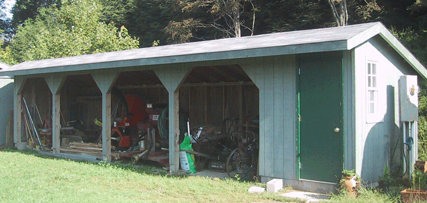

Here's a somewhat smaller version I built several years ago. It has bays for four implements plus a small closed room with a toilet that's tightly closed and heated above freezing, so works great for storing seeds, garden chemicals, etc.

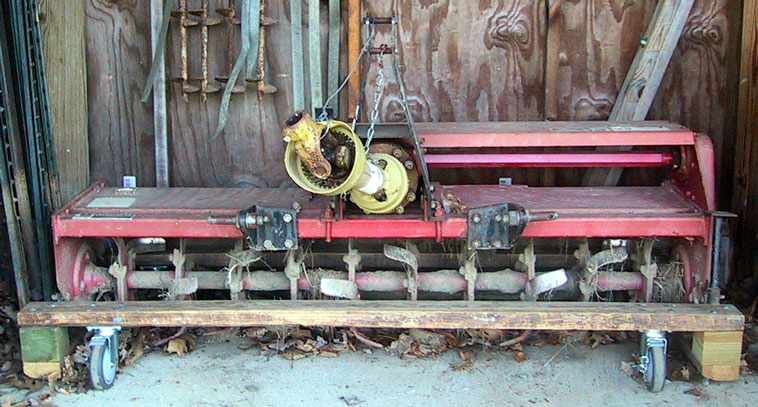

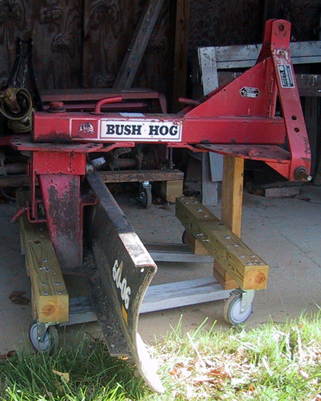

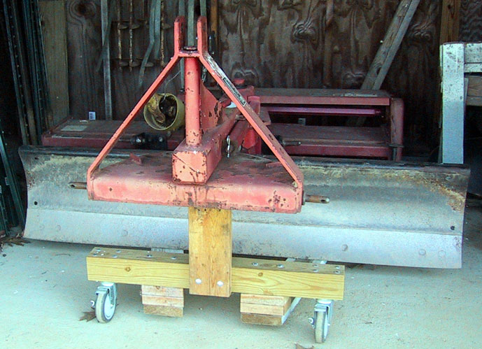

But since the "toy" collection tends to grow, you never have enough stalls. So I built dollies for each tool that both make it easier to hook up and lets me slide them in tighter to fit more in:
Terry
I like your design on the dollies, I have built dollies for mine, but I may steal your design, if I build some more.

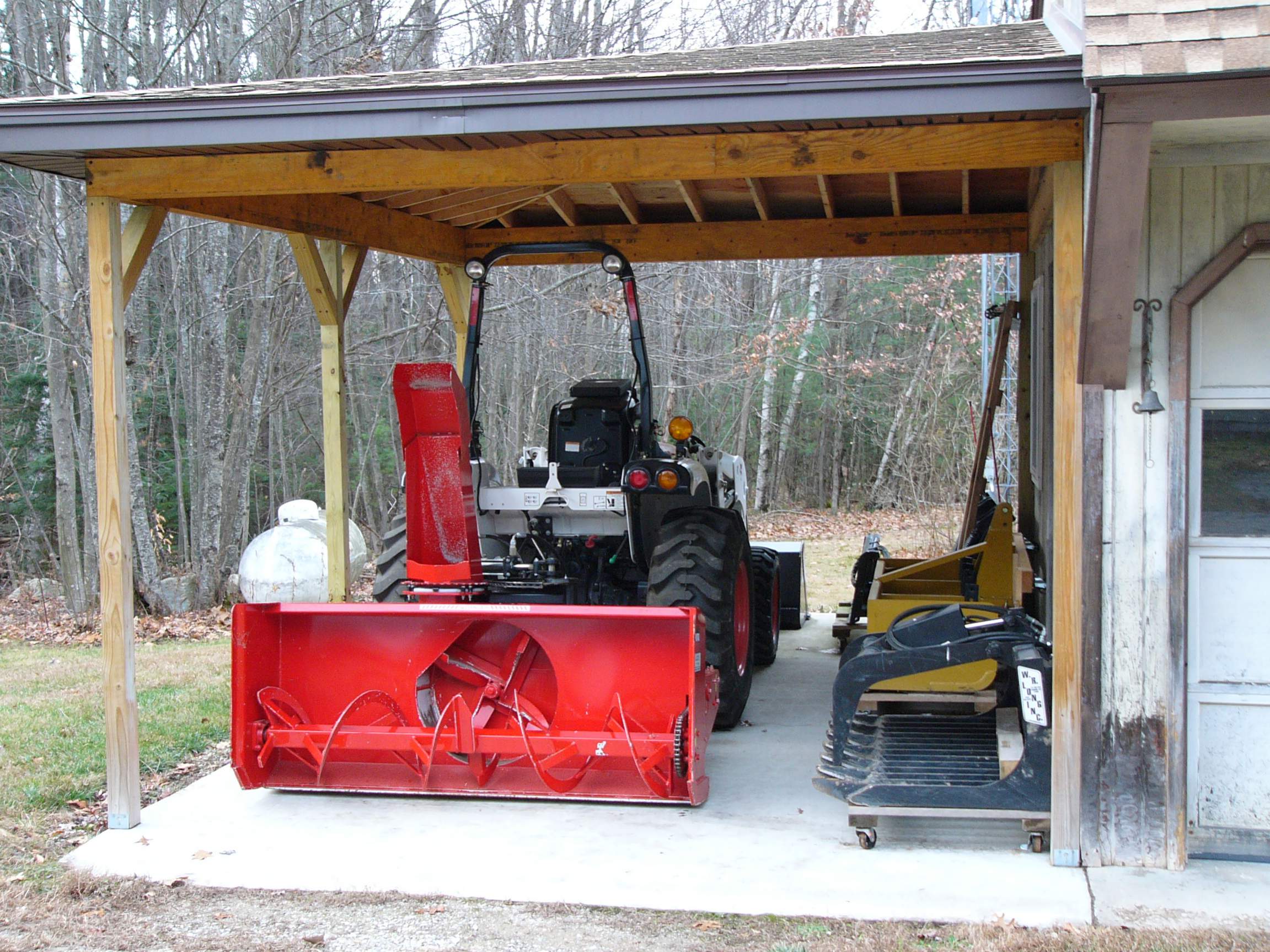

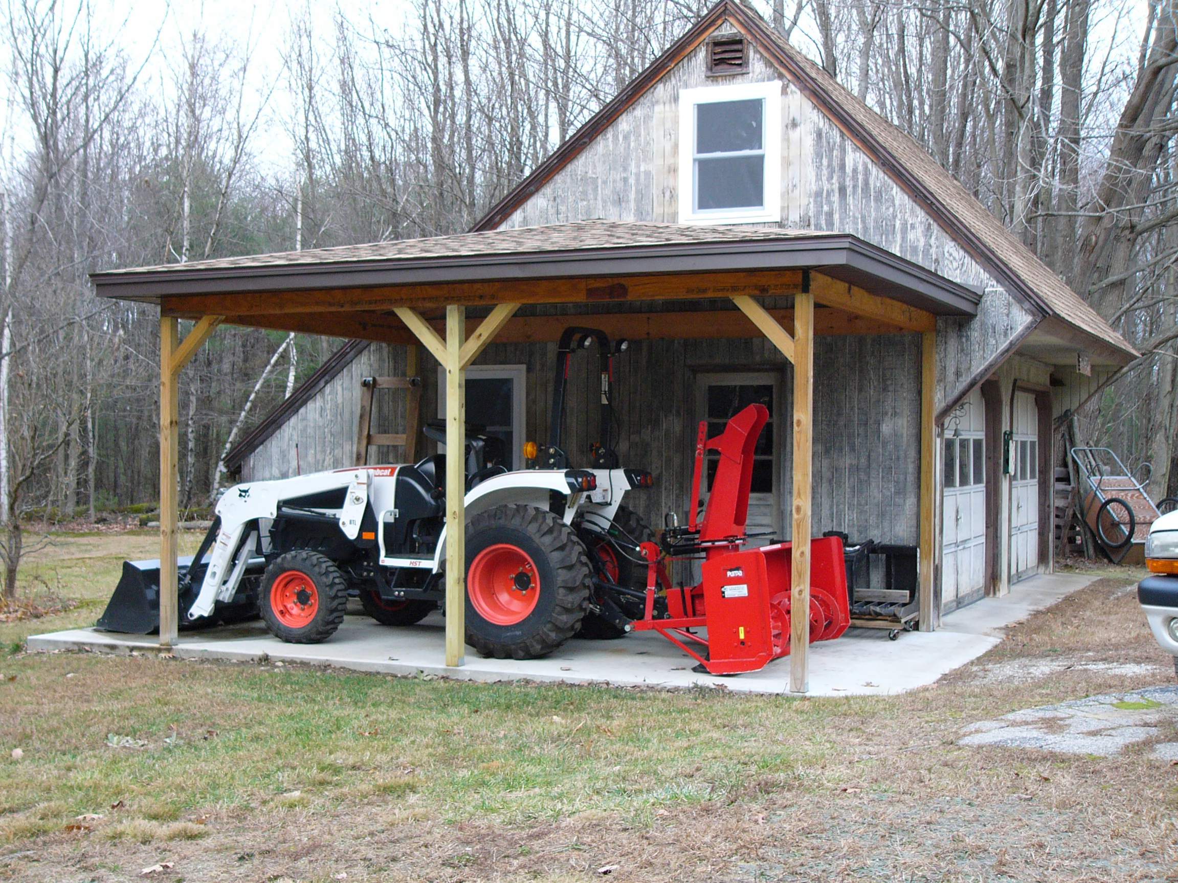

I had a car port style enclosure built for my tractor and attachments, with dollies
for each attachment. This works great, except for the fact that I didn't have the
enclosure built large enough. Depth was determined to blend in with the depth
of the garage that it's attached to, but I should have made it twice as wide.
I've run out of space.

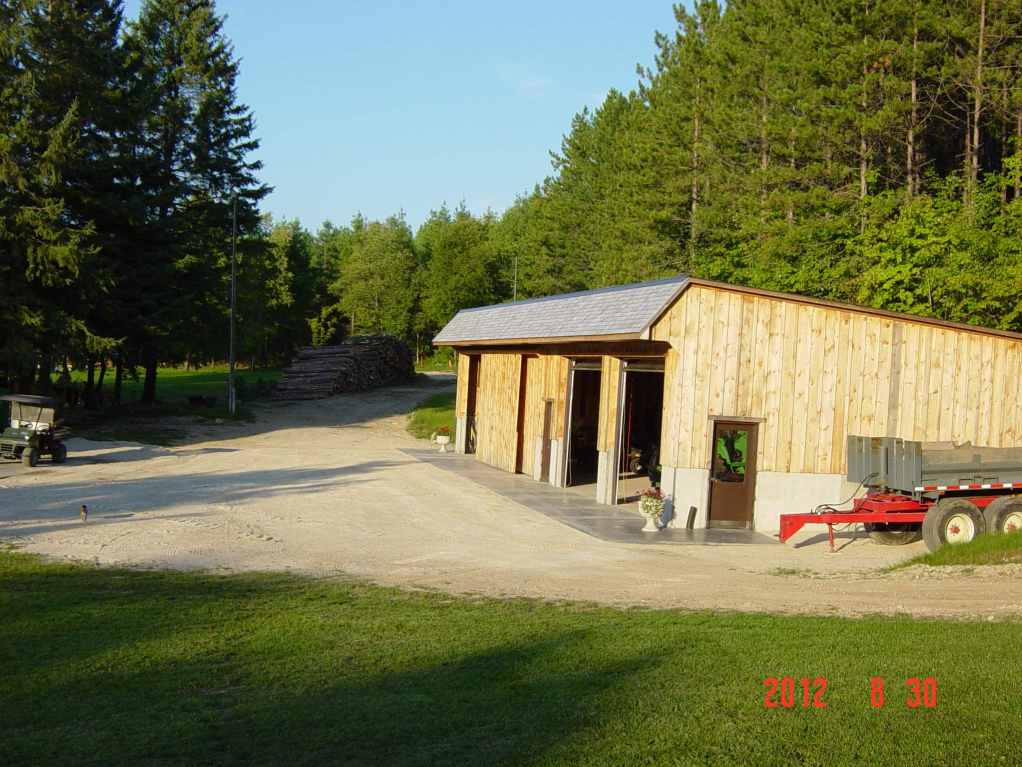

I built this a few years ago. Earlier we built another barn, but quickly ran out of room. In that barn, which is high, I have pallet racking and keep buckets and such things on the racking. Or snow blowers and various mowers on pallets. Problem with that is that too often things are in the way of the racking and putting stuff high up is a delicate operation, best done with a spotter. I have destroyed racking when stuff got hooked in one way or another!
In general, I am trying to get rid of stuff, because there comes a time when more just becomes a pain! I just hate tripping over all manner of attachments that always seem to litter any available floorspace regardless of how much room you have.
The idea I liked with this new building is that it has total access from the front and although there is still always stuff in the way it seems, it is a much better solution then doors from one side or another. Also, the barn has one of it's two big doors under the roof eave side and unless I want to do a lot of extra snow removal work, that door becomes pretty much unuseable throughout the winter months and so largely does access to the racking so it has to be more for seasonal or seldom used stuff.

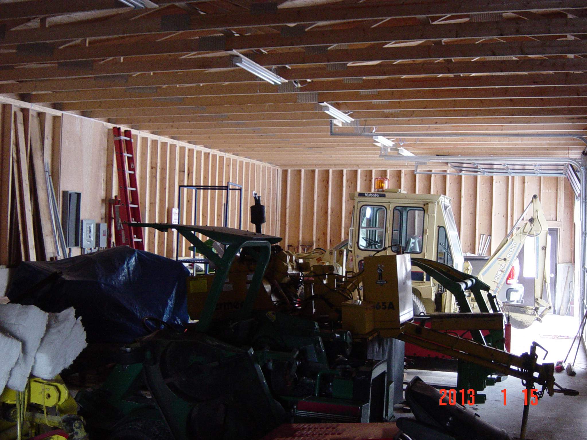

This picture doesn't do it justice, but this is the kind of chaos that always seems to exist inside any of my buildings. One thing about having more space though. There is always a good chance that there is someplace to put something and sometimes never in the same spot twice! I HATE, I mean absolutely hate stuff left outside.
Some other points occured to me. I have three or four hand pallet type trucks which I could not live without. I got them all used with minor repairs required or at auction. They are GREAT for moving stuff that you store on pallets out of the way. One is really narrow and that one seems to be my favourite and most saught after! Even better if you have concrete aprons and can move stuff outside temporarily.

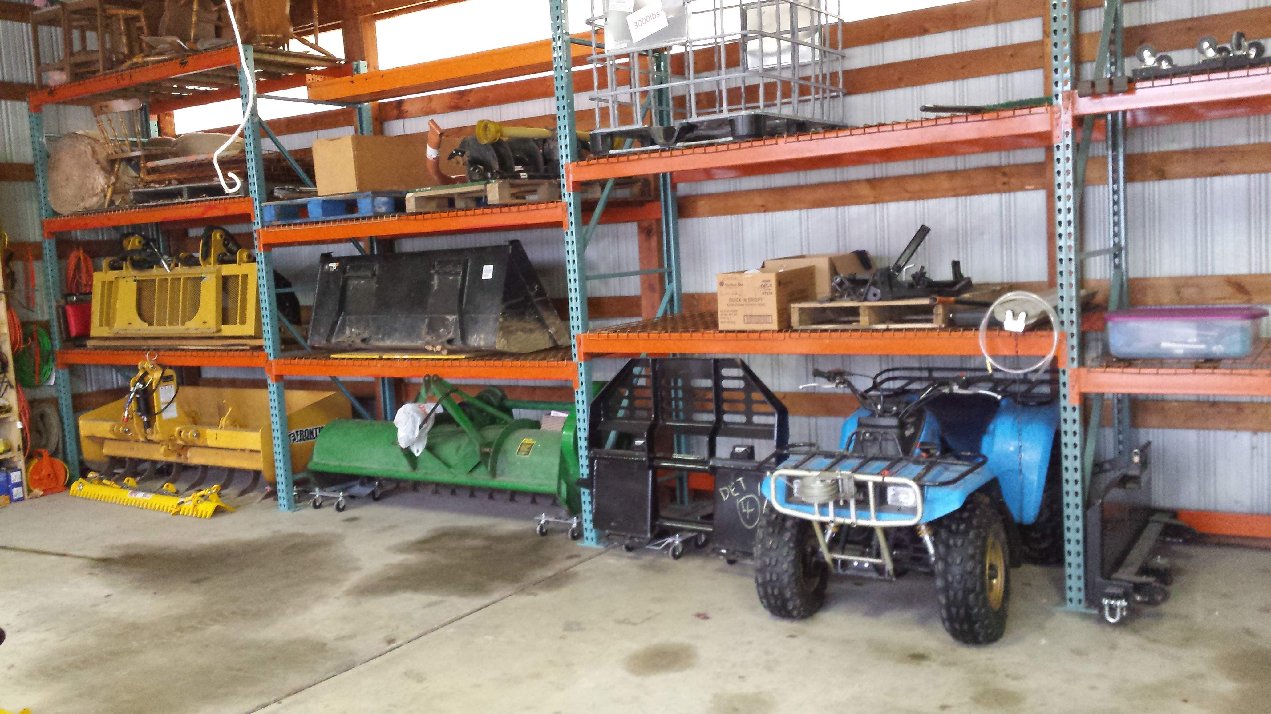

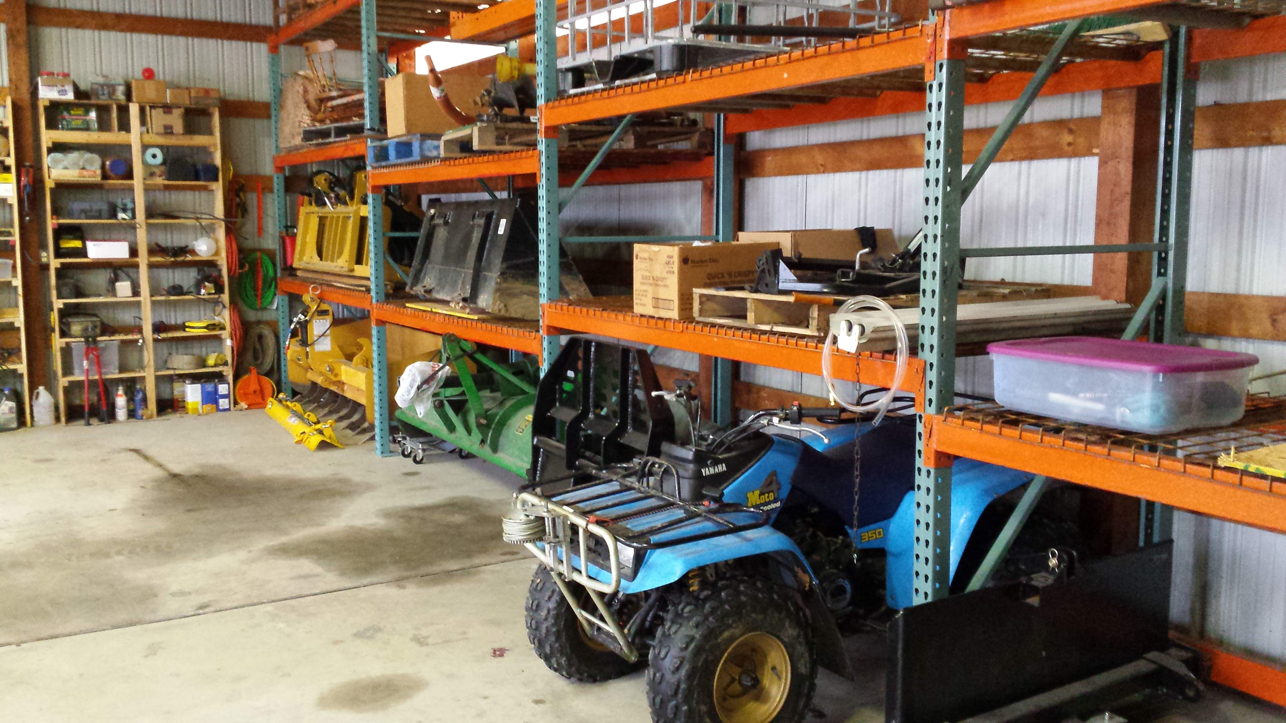

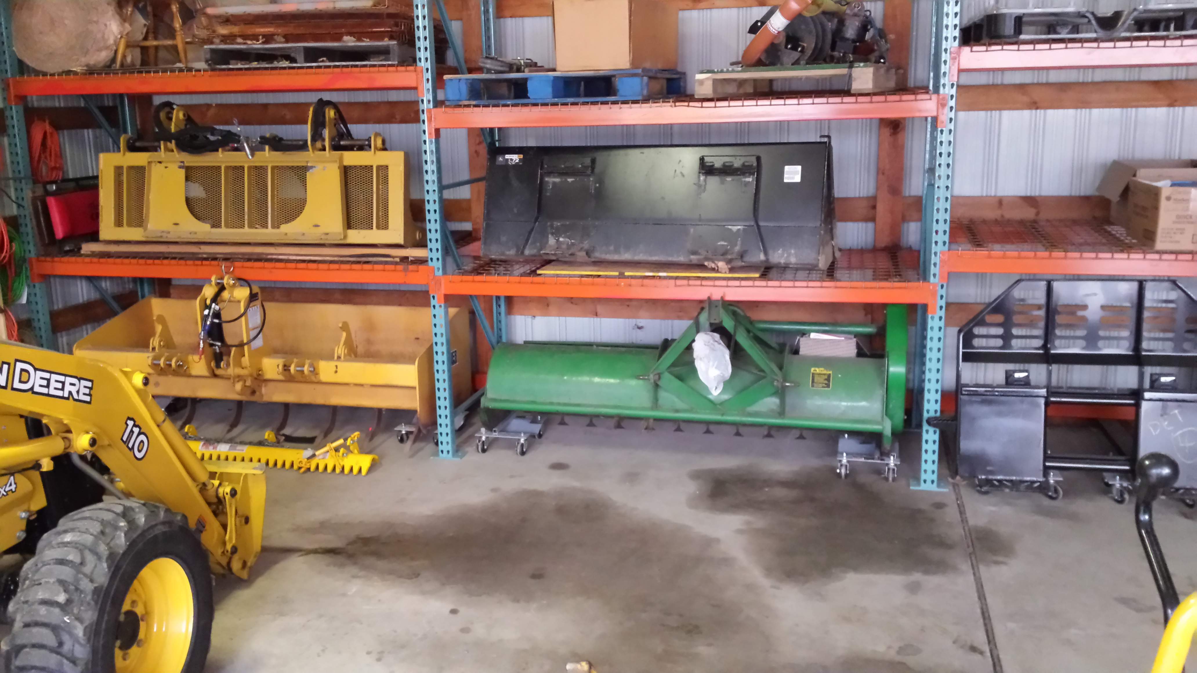

I bought used pallet racks and shelves. I put everything on pallets and stack it with the forks. Flail mower is hard to store on a pallet so it goes on the floor under the rack, snow plow on first shelf etc.
