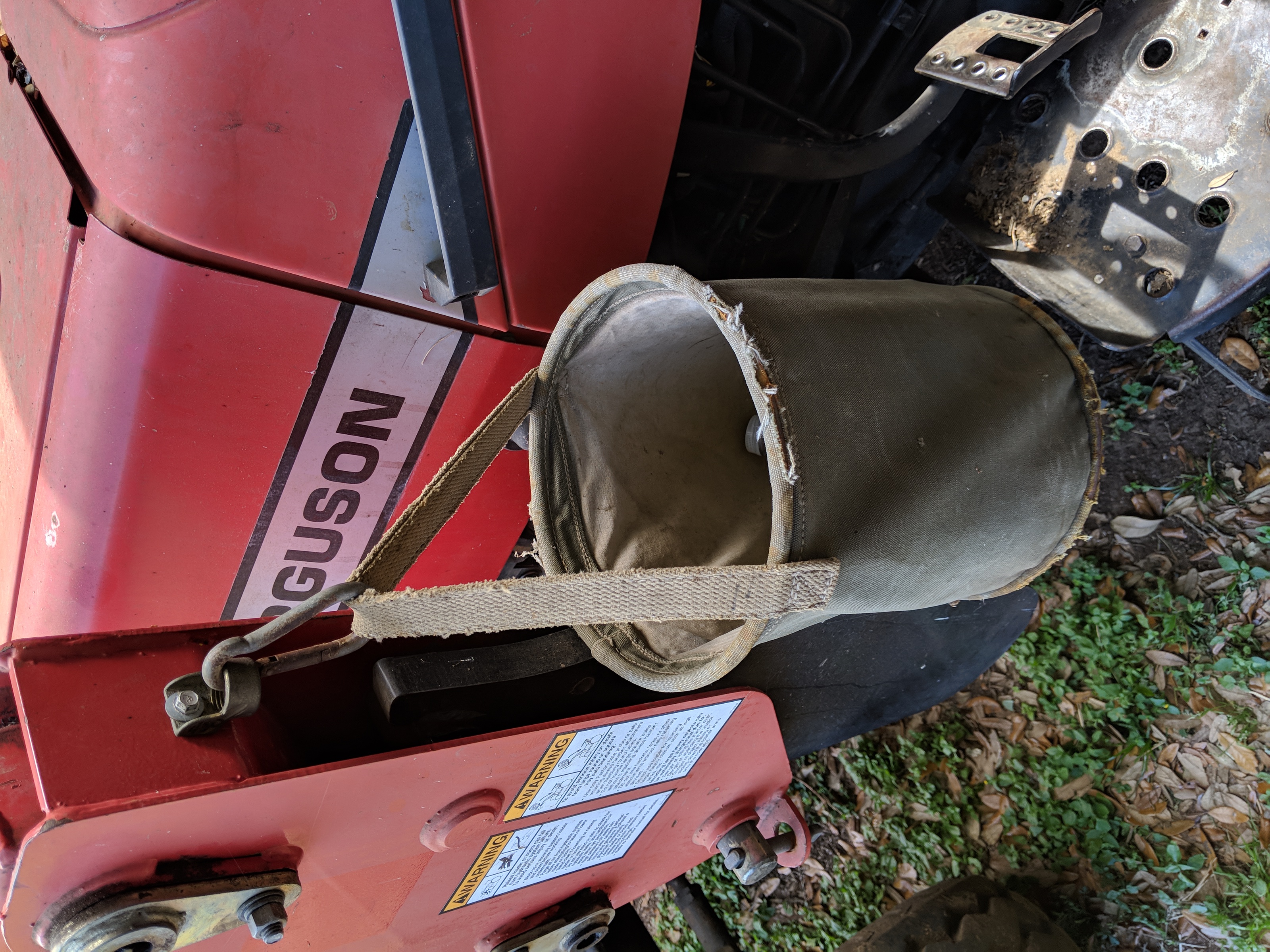

I have a few of these around from when I was doing ship repair, handy for all kinds of climbing work or going down into nasty places where the sun don't shine.
