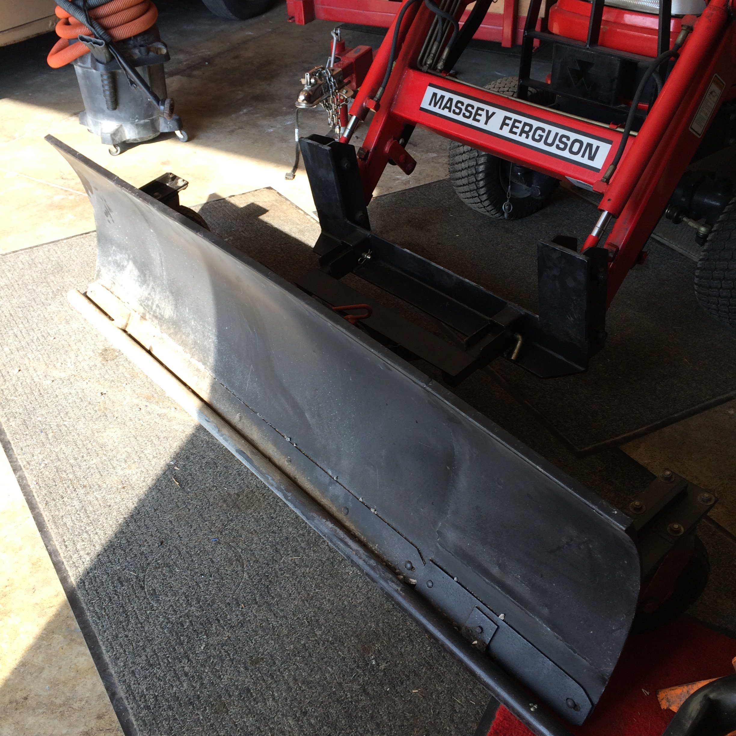

I found the simplest way is to not push the gravel into the lawn.
My drive doesn't have any inclines, so I don't plow unless I have packed down a 3"-4" layer of snow.
I do have the pipe attached to my plow. For Gods sake, don't waste your time slitting it. It's completely unnecessary. Just weld on some tabs, and attach it with the screws that hold the cutting edge on.
I have 8" casters, instead of shoes on my plow.
Since it's a FEL mounted plow, I can set the height of the blade a couple inches above the ground.
I move less than pail of gravel plowing 325' of driveway.
