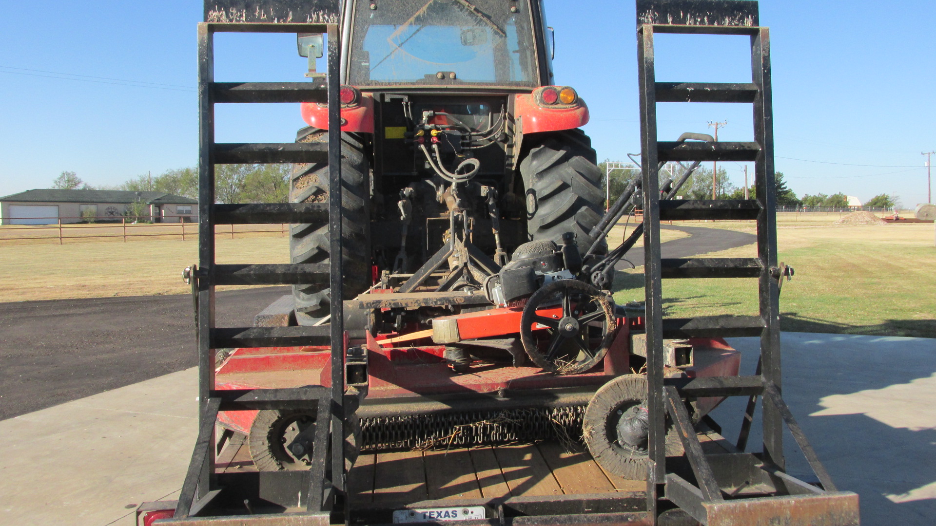

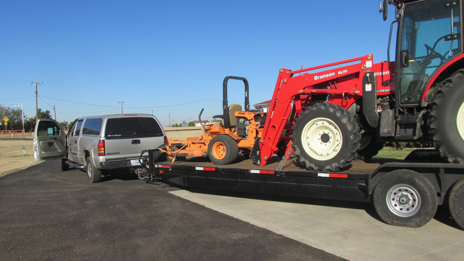

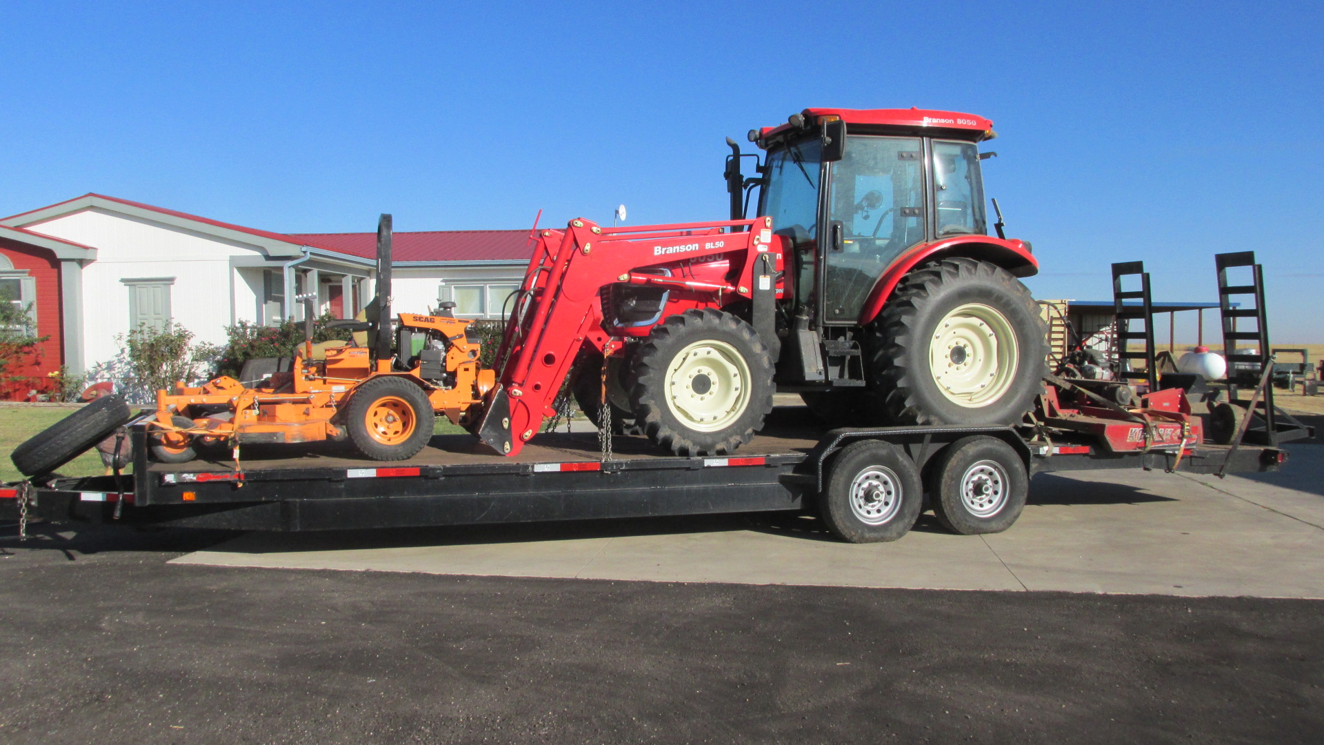

4 grade 70 chains with ratcheting load binders.
Attached to a D-ring on the drawbar in back.
Around the axle in front, with a piece of hose to protect the paint.
Glare makes it hard to see, but with a box blade up front under the bucket, the tractor and rotary cutter completely fill up a 24 foot trailer.

That's really tied down, but it appears to me that your tractor is not centered on the trailer for proper tongue weight.....just sayin'

I do realize that, but to get that long load centered, I'd either need to have the cutter hanging 3 feet off the trailer, or have a much longer trailer.
