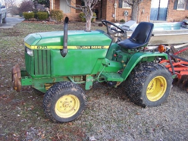

I have to haul my tractor pretty often to maintain my inlaws' place and others. I have never really liked any of the options for chaining it down. I would like to stay off the lift arms and bars, but there are just almost no options to attach to the tractor frame. I picked up some 3/8" steel U's a while back to weld on, but I can't even decide where to weld them on. I've tried chains and straps in a zillion different ways.
Show me what you do...

The one time I had to have my Kubota taken back to the dealer - they came with one of those tilting bed trucks.
The tractor was secured to the bed of the truck with a heavy chain & chain tightener at all four corners. The chains were wrapped around each axle and then attached to the bed rails of the truck. I think any other location for attachment on the tractor is likely to cause damage - i.e., the arms of the 3-point, any part of the steering mechanism etc.

In the front I would put rings on the side frame right behind the weight bracket, or on the front crosspiece the weight bracket bolts to.
434253-how-do-you-chain-down-jd670side-jpg
In the rear, there is somewhere around the drawbar area to tie to, or mount a loop to.
434254-how-do-you-chain-down-jd670rear-jpg

Good news is, the front is easy. It already has holes that's are easy to deal with. No problem there. The rear is the problem... As I was driving to town just now, I was thinking I might put a ring or clevis in the drawbar hitch, and weld a ring in the floor of the trailer in the right spot. With a holesaw, I'd cut a 3" or 4" circle out of the deck and weld a ring/hook to the trailer frame there.
I almost always have the finish mower or brush hog on when I haul it. The mowers get in the way of trying to chain it down, but I'm not going to take them off. Just gotta work with them attached...
The drawbar thing may be the way to go...

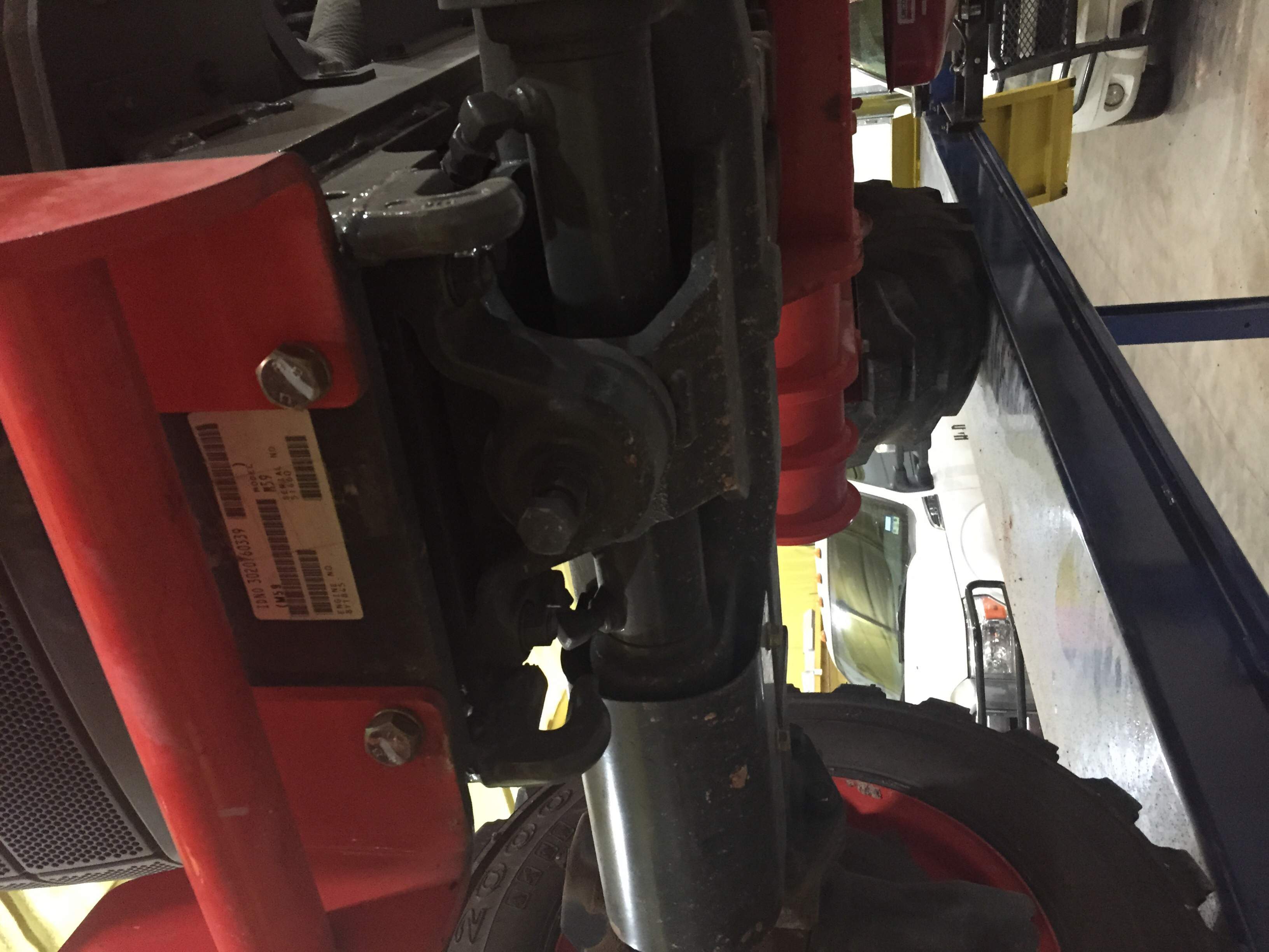

Here is how I welded a couple grab hooks on the front of my backhoe. The rear has good attachment points on each side.
Everything I haul frequently I have chains cut to the exact length needed usually only 4-5' long so they are not as bulky and are easier to work with. I can chain stuff down in a hurry for sure.
Going from the four corners out is best but I do have a trailer that I haul two kubota RTV's on and they are so close together and near the ends of the trailer so there is no room to go from the corners out so I go from the corners in. There is a d ring on the trailer on each side positioned between the midpoints of the tires. I hook a chain on the frame of the RTV's behind the tires and run it two the d ring. Four chains on each one.
