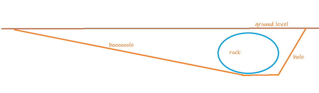

Years ago I had to remove a big rock from my new garden. All I had was my 1945 Gibson tractor. Look up Gibson tractors to see what I had. Anyway, a 7 hp Wisconsin engine was all the power I had. I dug a ramp down to the rock. Then I wrapped a chain basket made from tire chains around the rock. At least a 400 pound rock. I jerked and jerked until the rock started to move up the ramp. Once I got it moving I didn't stop until I had the rock where I wanted it. So a ramp is a good idea I think. Drag the rock onto some sort of sled, maybe a piece of 3/4 plywood or an old car hood. Water the ground heavily along the path you want to drag the rock so it is extra slick. Drag to desired location. Or, as someone else suggested, hire a big wrecker to pick and place it.

Try digging down like FatJay wrote, water the ramp so it freezes over, put in posts at top of the ramp to attach cable/heavy rope, winch rope and rock up ramp if you don't have something to tow it with.

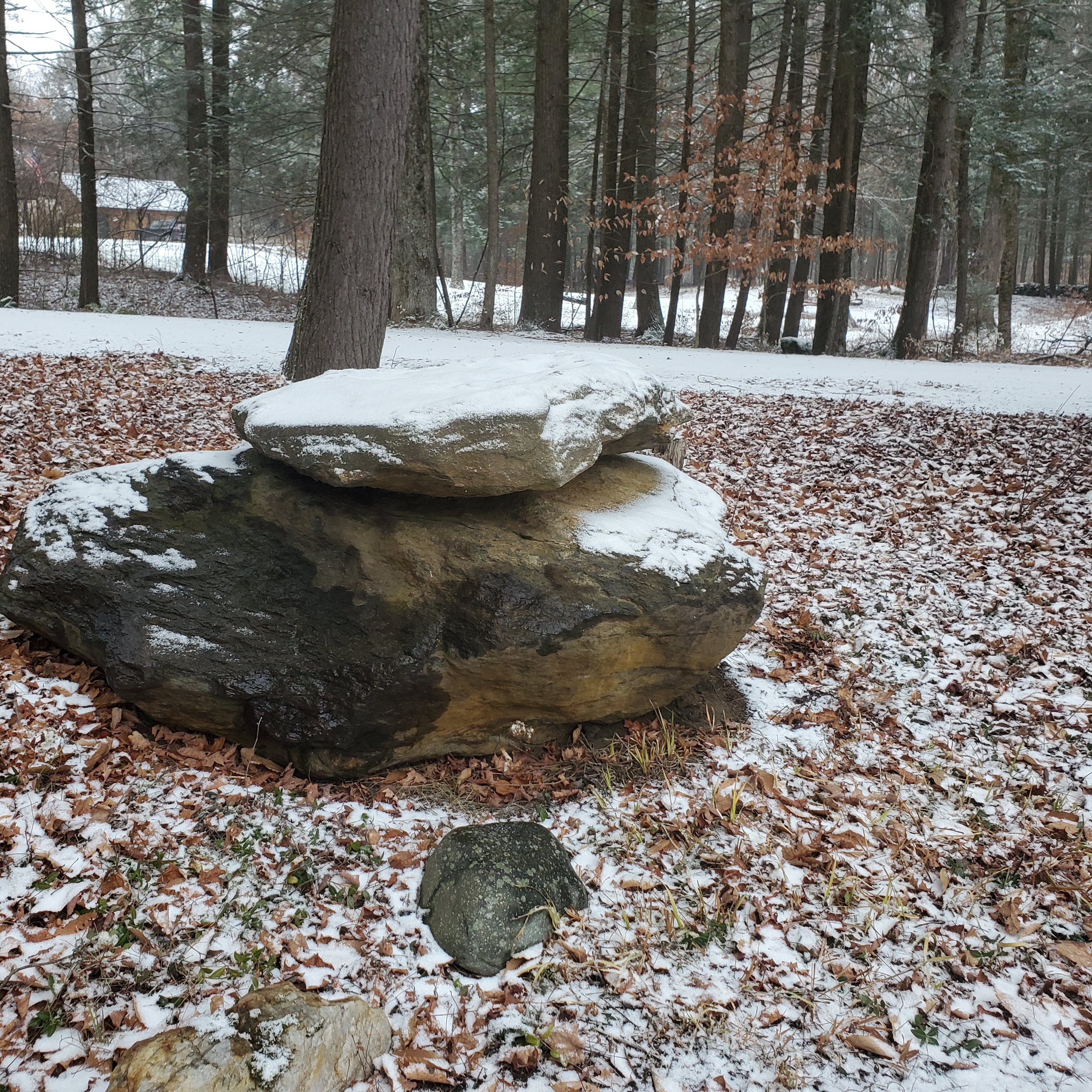

About 20 years ago, this one showed as a 12 inch "crown" in the garden. I dug it by hand, jacked it out of the hole with a cheap 2 ton hydraulic jack. Inch by inch. Chained it up and drug it to the corner as "an ornry ment" , with the Fordson E27n. Then piled a "cap stone" on top just to be contrary.
The base stone is 92 inches the longest dimension, 64 inches front to back, and 33 inched vertical.
It must be heavy, it hasn't moved an inch since.

Dig a path down so you can drive down to the rock, then drag the rock up the hill.
Might be a possibility if the estimated weight wasn't between 40-50K pounds. It won't budge with a 15K excavator. Started exploring using a deadman anchor and about 5 snatch blocks to create a 5:1 system
