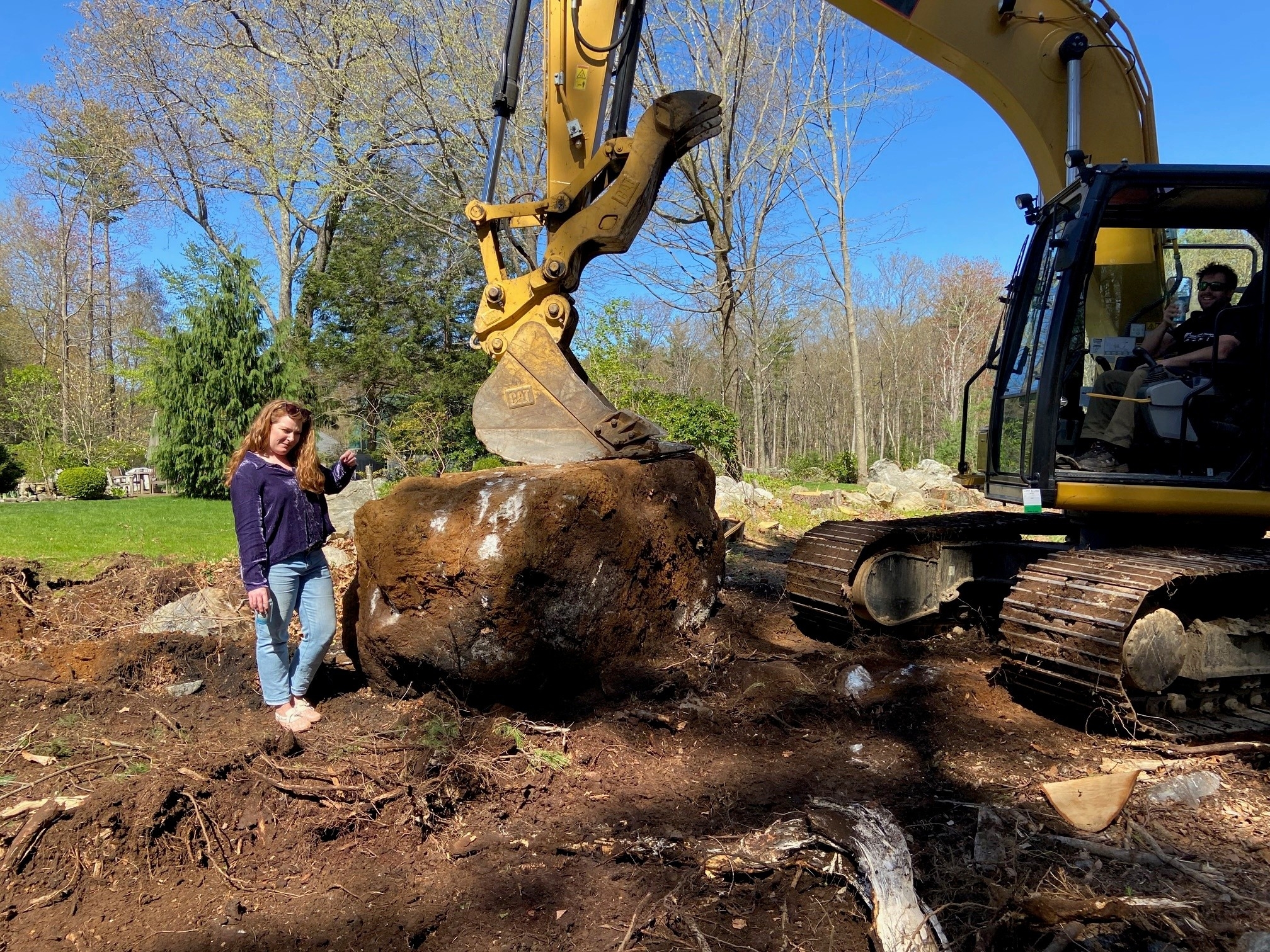

This is the typical New England boulder and Cat 315 2x the size of the OP machine but was a struggle.
5'H x 6'Wx 10' L a bigin..

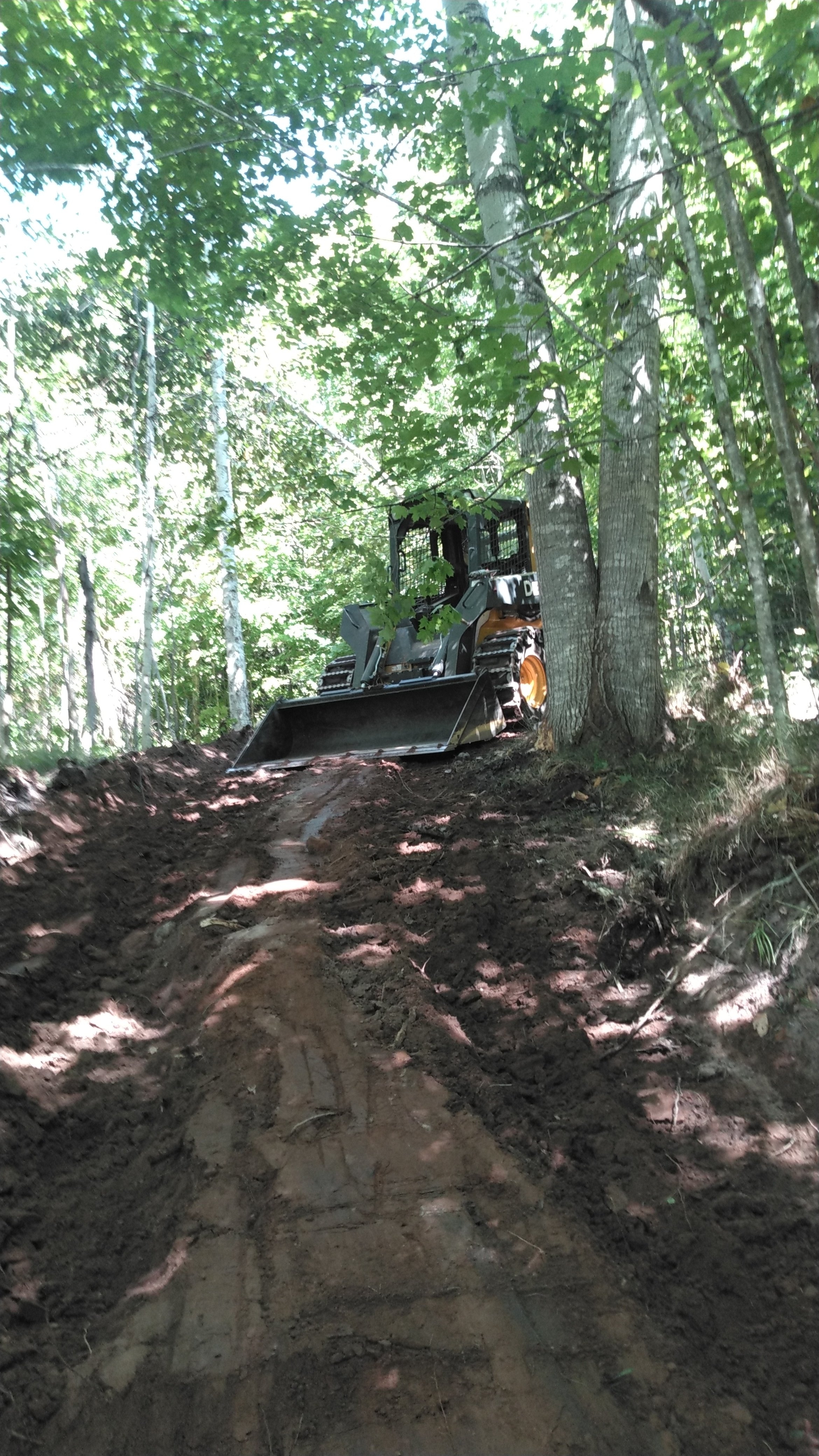

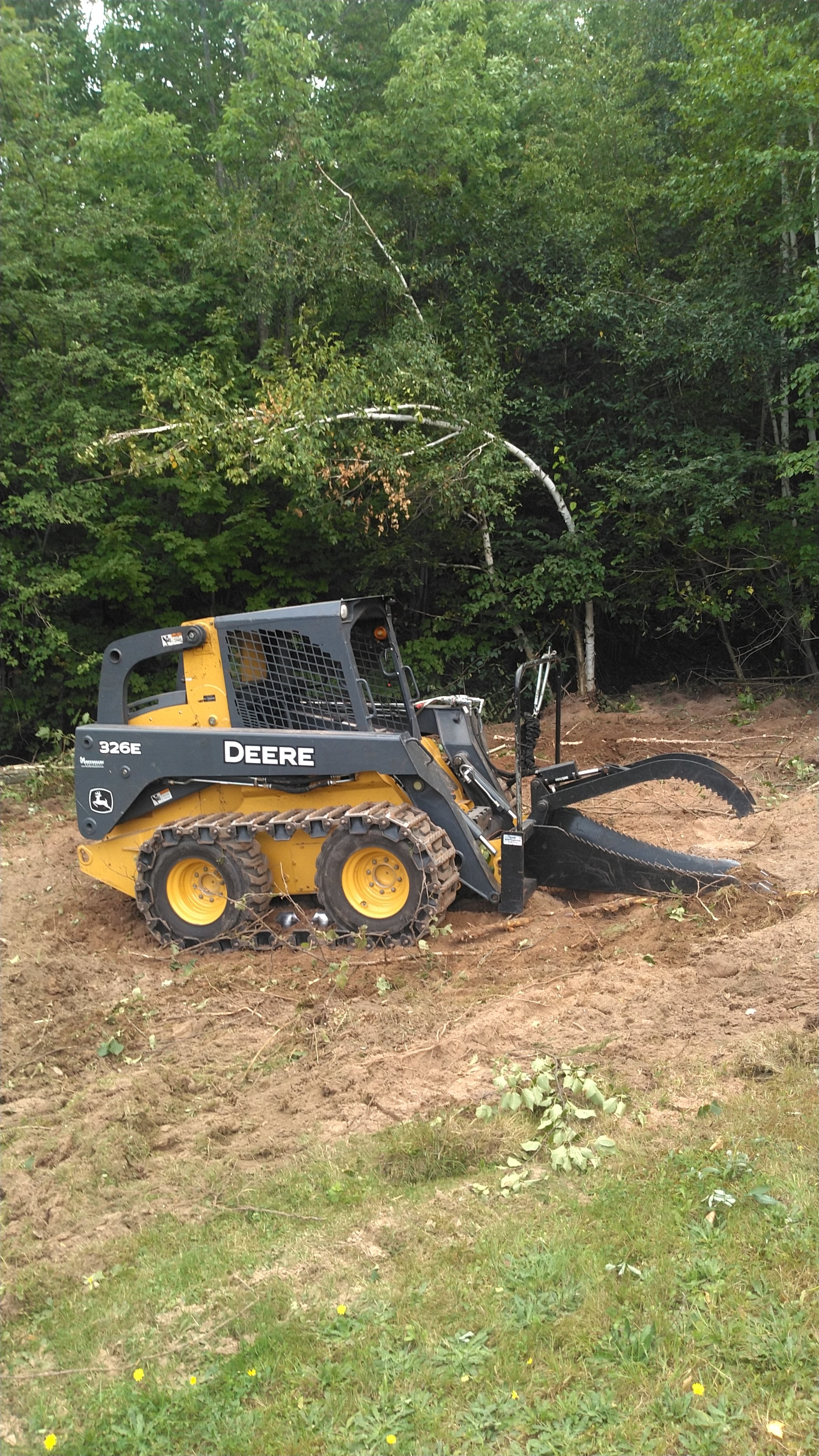

Wish I had pics of some of the boulders I moved with my old steel track.over tires JD 326 ss , and a heavier duty stump bucket with grapple. As long as I could get the boulder to move by digging down around it in a hole with stump bucket I could use the bucket like a pry bar to pop it out of hole to more level ground.and push it down an embankment, off a logging two track I was helping make more useable for vehicles to access a camp. Dangerous, problaby, but it worked without any noticeable damage to 326 or injuries. . you will problaby. Have to push a rock that size if you manage to get it out of the hole. Me anyway I'd never try pushing something that big up an incline. Good luck.
