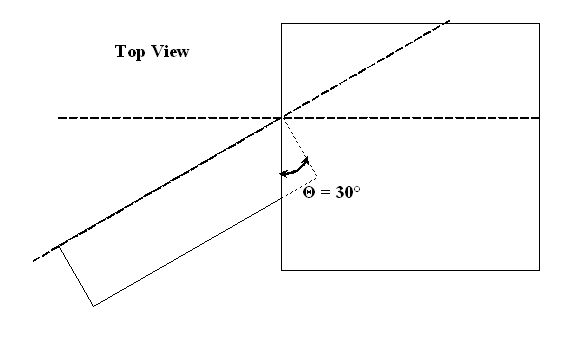

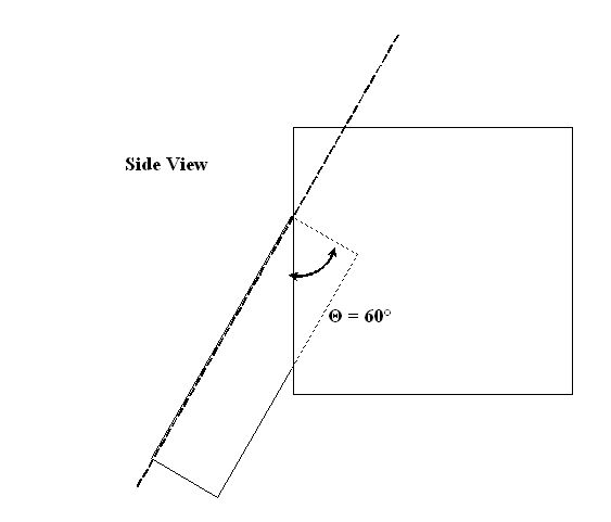

Pooh_Bear said:
I drew this up in AutoDesk Inventor...
Perfect!
I wish I could afford the price of a good AutoCad type program like that and the time to learn how to use it well.
   / How do I calculate a compound Miter? #22
Pooh_Bear - sweet drawing program. I was trying inadequately to do it in MS Word! :( Although it was only 1:00 AM. :)
The 30° cut is the same as I was looking at, however I was trying to keep the legs square to the ground to help with cutting the "feet" end of the legs. As you rotate those legs both angles will change. The position of the leg relative to the box and the ground can stay the same but spinning it will change both angles, won't it? (By spinning I mean like a log would spin with a logger running on it in the water - best way I can think of to make sure you understand what dimension I'm referring to.) If the legs were round it would probably be easier to deal with as he will need to lay the thing flat on an edge to mark and cut the angles.

   / How do I calculate a compound Miter? #25
This has been bugging me all day. If you use a round leg, there's no "compounding" of the angle. In looking through the posts, GuglioLS already said that. Also, you said you kind of mocked one up and it turned out to be 35°. If you used the same angles as in Pooh_Bear's drawing, (30° & 40°), but rotated the leg a bit you'd get that 35° angle. That's the thing with the square leg, there's an infinite number of top/side angles that would position the leg where you wanted it, but each one would be rotated differently along the length of the leg. You have to figure out what orientation you want the square leg. That's where Pooh's drawing program comes in handy. You can rotate that sucker and pick what you like.

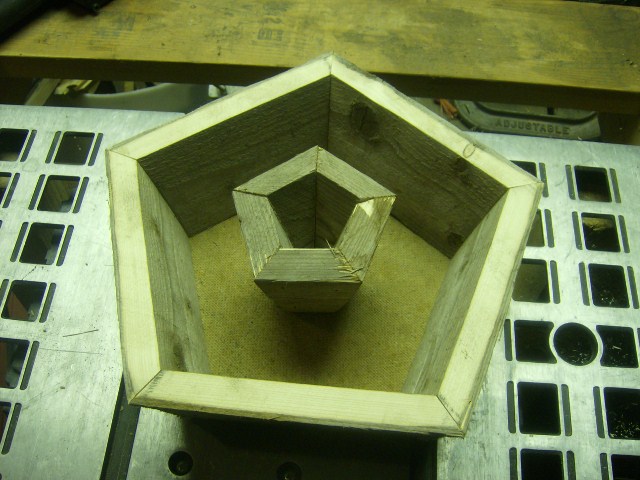

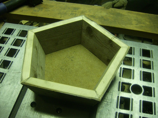

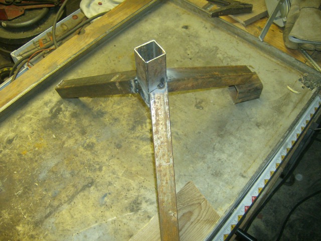

#33
Drum roll please....
Look at the picture below.
I took the peice of wood that I had cut out last night with a 30* bevel and a 30* miter. I measured each angle on each face in turn and transfered that angle to the metal. I'd mark the angle to the right on one peice and then to the left on the other to make mirror image legs. When I was all done I realized that the mirror image legs were really exactly the same.
I cut out the one set, and I'll cut out and tack the other set together later. I am going to true up the base with shims and then scribe around the legs to cut them so that it will sit level on the floor.
I'm still trying to decide if what I did was cheating for the purposes of this project or not.
   / How do I calculate a compound Miter? #35
Bravo! No cheating there, you set the angles in your mind, then made it happen. Cheating would have been, cut/try it out/cuss/re-cut/try it out/re-cuss... etc. :) Looks outstanding to me!
