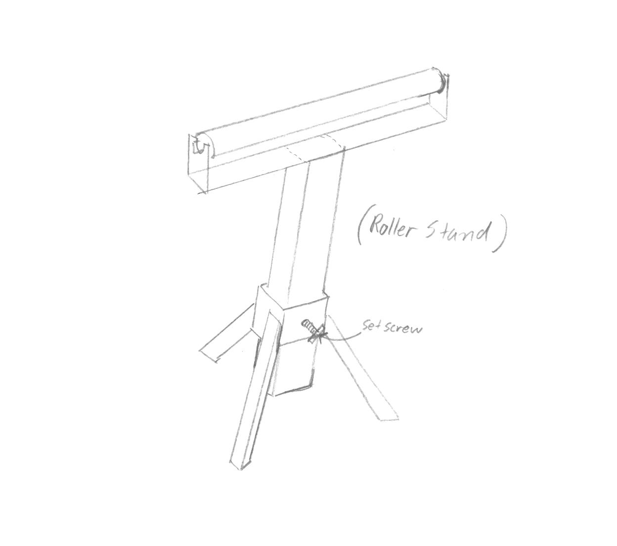

This has vexed me for some time. Any time I try to figure out the angles to set my saw and miter guage at to make compound miter cuts I end up wrong. I've always had to resort to the cut, test, cut, test method for compound miters. Now I'm working on putting together a couple of roller stands from spare pieces I've had laying around. I've given up trying to figure it out. I'm swallowing my pride and asking for help.
I know someone out there has a great trick for determining the cut angles for a compound miter. Please share.
In this specific situation I have a square tube and I am putting three legs off of it. One will come straight off the back of the square tube angled down 60 degrees. That cut is easy...60 degrees along both sides of the leg and 90 degrees accross the top and bottom. Same thing for the base of the leg that will touch the ground.
The other two legs will come off of each side of the square tube. They will be angled 60 degrees from the tube to accomplish the 120 degree split between all three legs and they will be angled down the same 60 degrees as the leg coming off the back. The cuts along the sides of these legs will be at 60 degrees, but the top and bottom cut will be something between 60 degrees and 90 degrees.
How do I figure out what the angles of these top and bottom cuts will be?

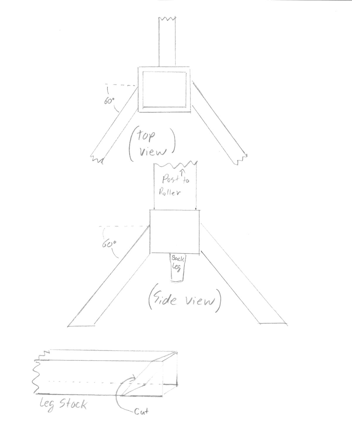

Below are my rough attempts to sketch out what I'm talking about. The first picture is a 3D sketch so you can get the basic idea of what I'm trying to accomplish. The second pic shows detail from a top view and a side view. At the bottom of the second picture is an example of the stock from which I'm planning to cut the leg. What I'm trying to figure out is what angle I have to scribe on the stock to cut a leg that will weld onto the square tubing at 60 degrees from vertical and 60 degrees from perpedicular to the side of the square tubing.

According to my calculations it should be a 60/30 compound angle.
60* you got, cuz that's what you want.
I came up with 30* because.....you want all three legs to be roughly equal "distance" or angles apart, so thats 360 / 3 = 120* since you are using a square (4x4?)to mount the legs to they are 90* apart, so one leg is mounted and the others are referenced to the starting point. The next leg is already 90* away so add 30* to that 90 to get to the 120*.
To Compound matters :rolleyes:
There is a bit of a "problem" in that "perfect" 30/60 compound angle theory -The vertical center-post is Square!
Now,if you were to cut that post to a 3 sided 120* triangle or if it were round, your legs would fit perfect without a compound angle.
K.I.S.S. :)
Good luck.
Larry

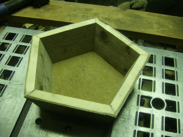

In your case I think you are talking about a 'three sided pyramid'
These formulas should solve just about any miter problem. Start by getting a value for 'A' based on the number of sides. Then figure the miter and bevel. Ensure you calculator is in degrees mode and the value for 'SLOPE' is in degrees. If you load these into a spreadsheet program you can create a chart.
A=90-(180/#SIDES)
MITER=90-(ARCTAN(SINE(SLOPE)/TAN(A)))
BEVEL=ARCSIN(COS(A)COS(SLOPE))
A=90-(180/#SIDES)
This works great for picture frames and situations where two pieces come together to make a corner. The scenarios I'm talking about are where a single piece needs to be mitered to mate with a flat part of something else. I think there's a way to extrapolate the info from the formulas you've posted to get what I want, but I haven't gotten my head around it yet.

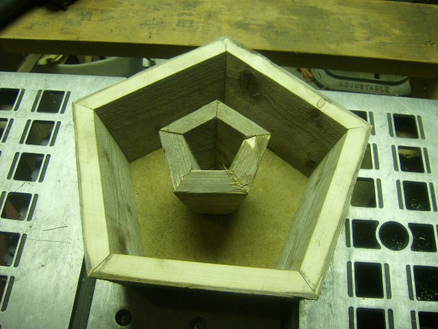

In a temporary fit of despair I gave up the roller stand momentarily to play with Gizmo's equation.
Ten minutes later...Voila! See the pictures.
Now that I've proven to myself that I'm not completely useless, I'm going to bed. Maybe I'll have an epiphany in my sleep and wake up as an engineering genius.
I'm eager to hear what Renze has to say. His post gave me hope that he'd have some additional insight.

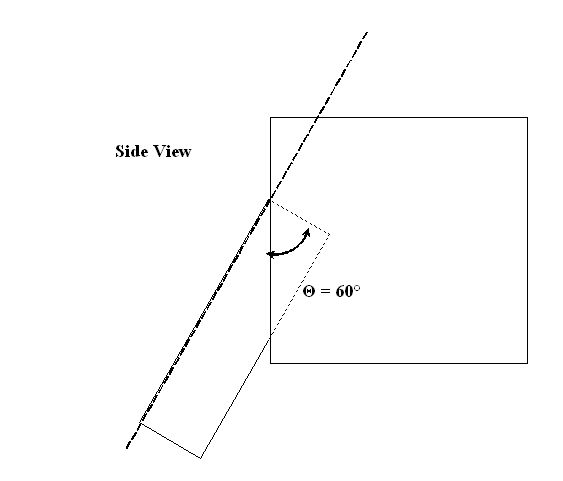

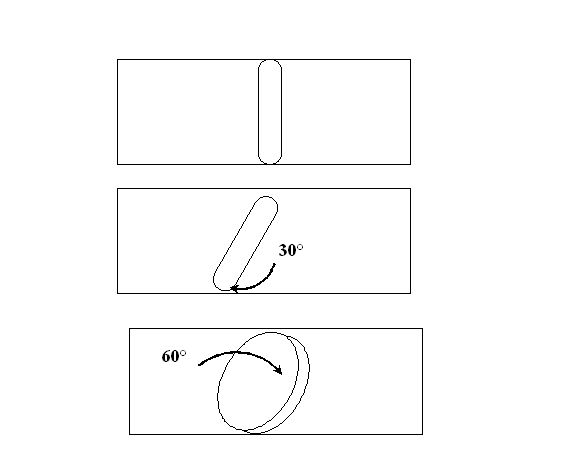

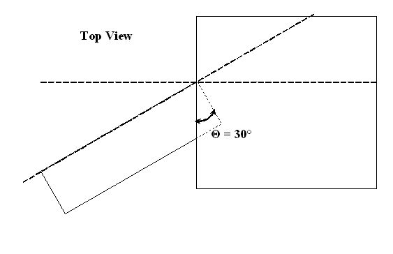

See if this will help. Here's the first cut, similar to your drawings. I added the plane of the blade so you can see where it needs to be moved from.
To make this cut you would have to do this: (that's supposed to be the mitre saw by the way)
However I suspect you can't do the 60° angle. Is that correct?
Edit: I just saw your posts while I was making my mitre saw drawing. :) Nice work on that. If you can do the 60° you should be good to go, but my angles are likely backwards.
