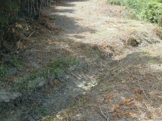

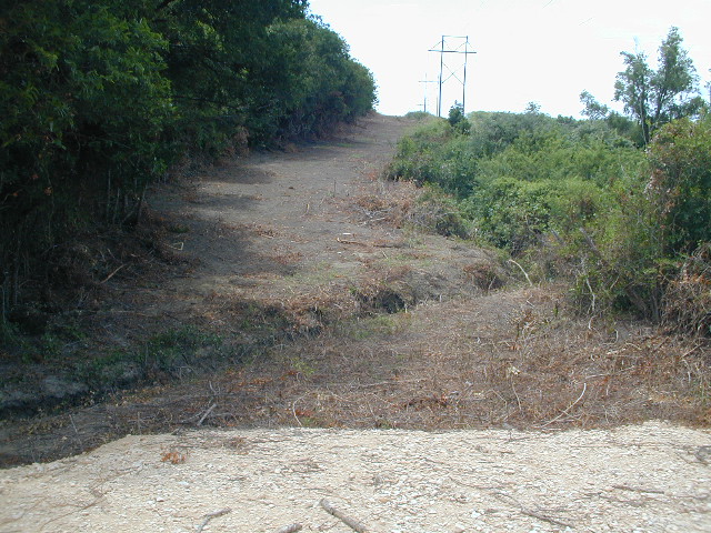

For a gravel driveway that has to cross a wet weather creek.
Other than clearing the brush to see whats there, the creekbed is as it was carved by decades of water flow. Water gets going through there pretty good when it rains.
Any thoughts?

No way to say for sure, but culverts never fail if they are too big. They fail from being too small and/or not having any protection at the ends for erossion.
Just off hand, I'd be worried if you went with 18 inches. That's a pretty good sized culvert, but 24 inch should probably be a minimum size. Then consider rip-rap or cement to hold the water back from eroding along the sides of the pipe. The back end seems to get it the worse, so be sure to do both sides.

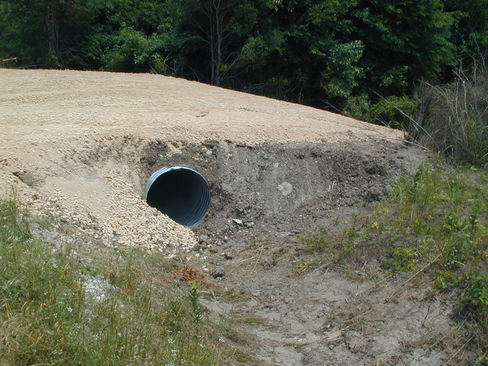

What is the picture of with the culvert in it? Is that on the same drainage?

The drainage with the culvert installed is up close to and parallel to the road. The county specced it and installed it. I bought the pipe from a vendor and had it delivered, its 36".
The county did the installation and provided the fill for $5 per foot which worked out to $150.
They only do the road drainage or I would have asked them do the creek crossing as well.

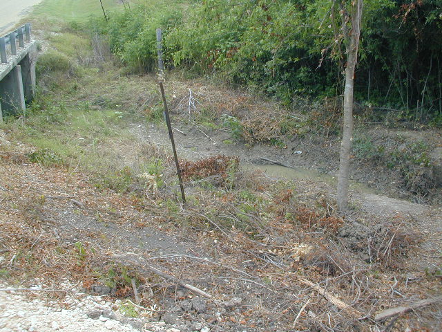

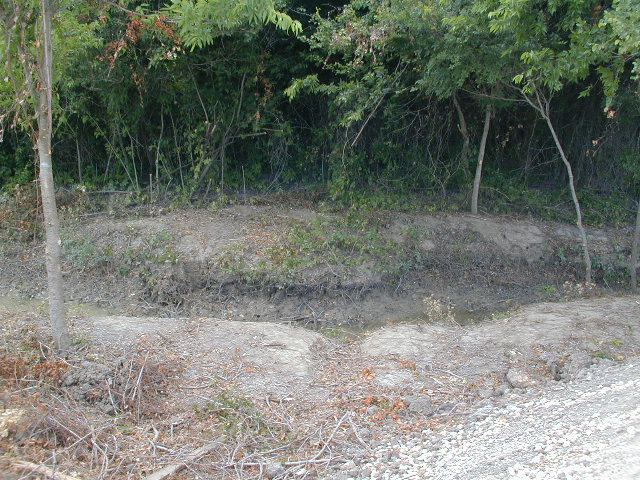

The creek bed where the crossing would be is about 4 feet wide and about 3 feet deep. About 75 feet down the creek it passes under the road.
I have not seen it after a heavy rain but have been told that "quite a bit" of water runs through there.
Might just have to leave it as-is until there is a good rain and see for myself.

Based upon that bridge -- assuming it's where the road crosses the creek just a bit farther down -- I'd be concerned about a 4' culvert being big enough. Just looking at the pictures -- I'd be concerned about even a 6' foot one. Maybe two 4' ones, side-by-side, embedded in a concrete wall on both ends to control erosion... Hard to tell just by looking at the pictures.
If you'll examine that bridge closely, you can likely see the high-water marks on the concrete. That would tell you how much water you might have to deal with...

the real answer will require the following info
-100 year rain fall rate is for your area
-what's the size of the contributory area is (that part up stream that collects water)
-what the permeability is of that area.
-what slope your culvert will be at. ( as steeper culvert flows more water)
there might be some other info but that is most of it.
