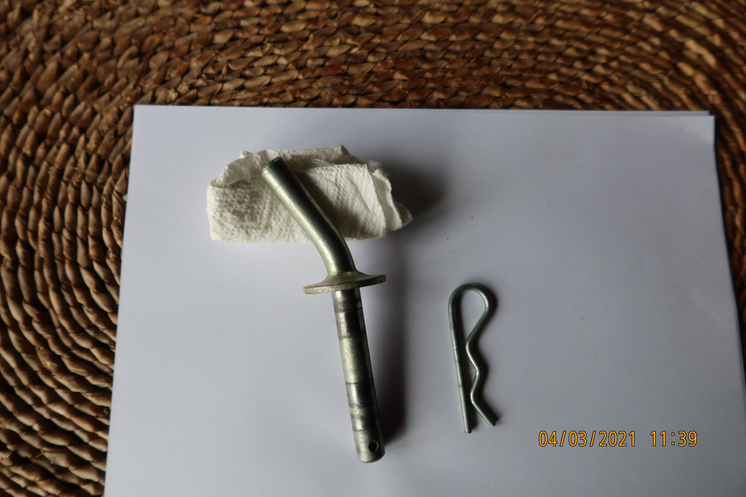

OK - I just now pulled the pin on one of my stabilizer bars. It's 1/2" in diameter and 3" long from the end to the welded on washer. The "hair pin" hole is hard to see - there on the end.
/ How big is that pin? #7
OK - I just now pulled the pin on one of my stabilizer bars. It's 1/2" in diameter and 3" long from the end to the welded on washer. The "hair pin" hole is hard to see - there on the end.View attachment 693200
Far more likely to be 12mm than 1/2". There's very little on that tractor chassis thats not metric. 1/2" may be too big for the holes in the bars.
/ How big is that pin? #8

Perfect! Thanks for measuring them oosik! My tractor is up on my farm and I couldn't get to it right now to get a measurement. What am I doing that's causing these pins to be lost?... Aging! :) I don't know how many times I've laid the pin on the top of the tire or somewhere on the 3 point or implement and driven away. Usually remember it and can backtrack and find it, but not always ;).

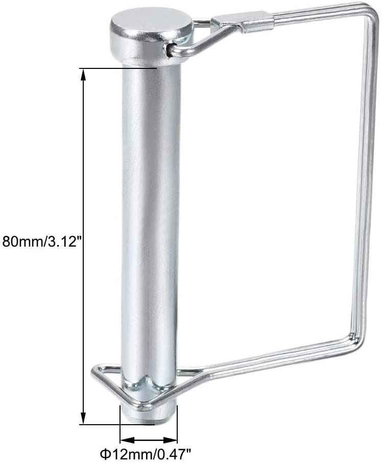

These pins are $20 each at a kubota dealer. I Found these 12mmX80mm (.47"x3.12") on Amazon, 2 for $11.99. Just ordered them so haven't tried them yet, will let you know.
Uxcell shaft locking pin :

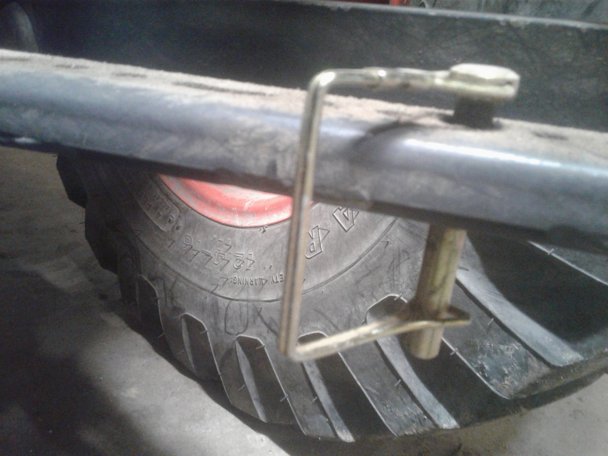

I feel the factory pin with the cotter pin in it is a pain getting the cotter pin in & out and holding onto it. I hope those spring clips I found on Amazon work, super quick & easy to remove & replace without dropping any small pins in the high grass!
