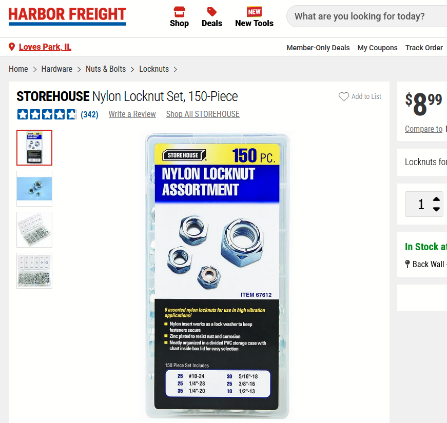

I measured it, it's definitely 24mm.
Dealer recommended a 24mm bolt. I'd need to figure out a way to keep the nut from rattling off but still make it quick removal.
Use a Nylock nut. Simple really. And in stainless.
