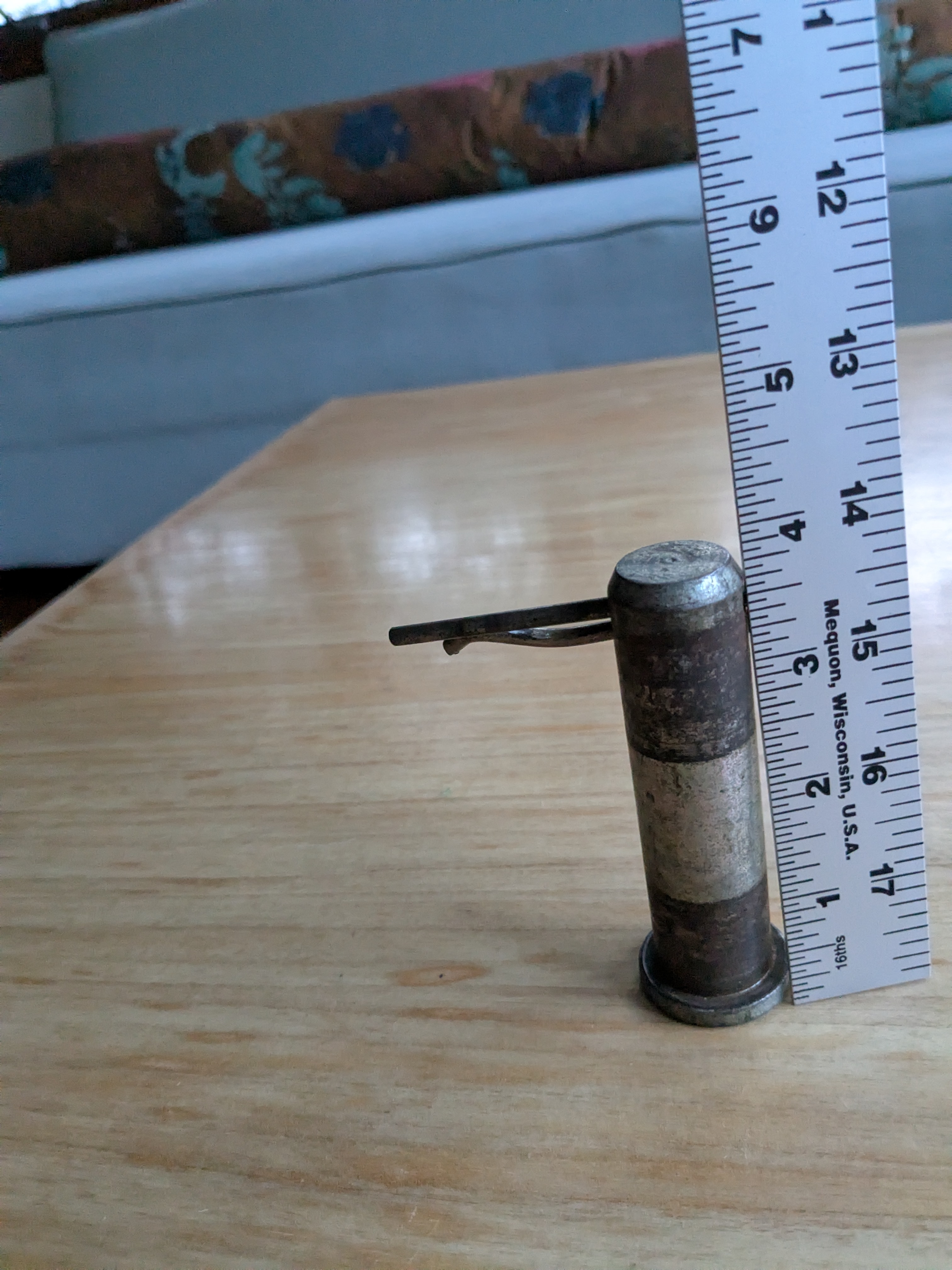

I measured it, it's definitely 24mm.
Dealer recommended a 24mm bolt. I'd need to figure out a way to keep the nut from rattling off but still make it quick removal.

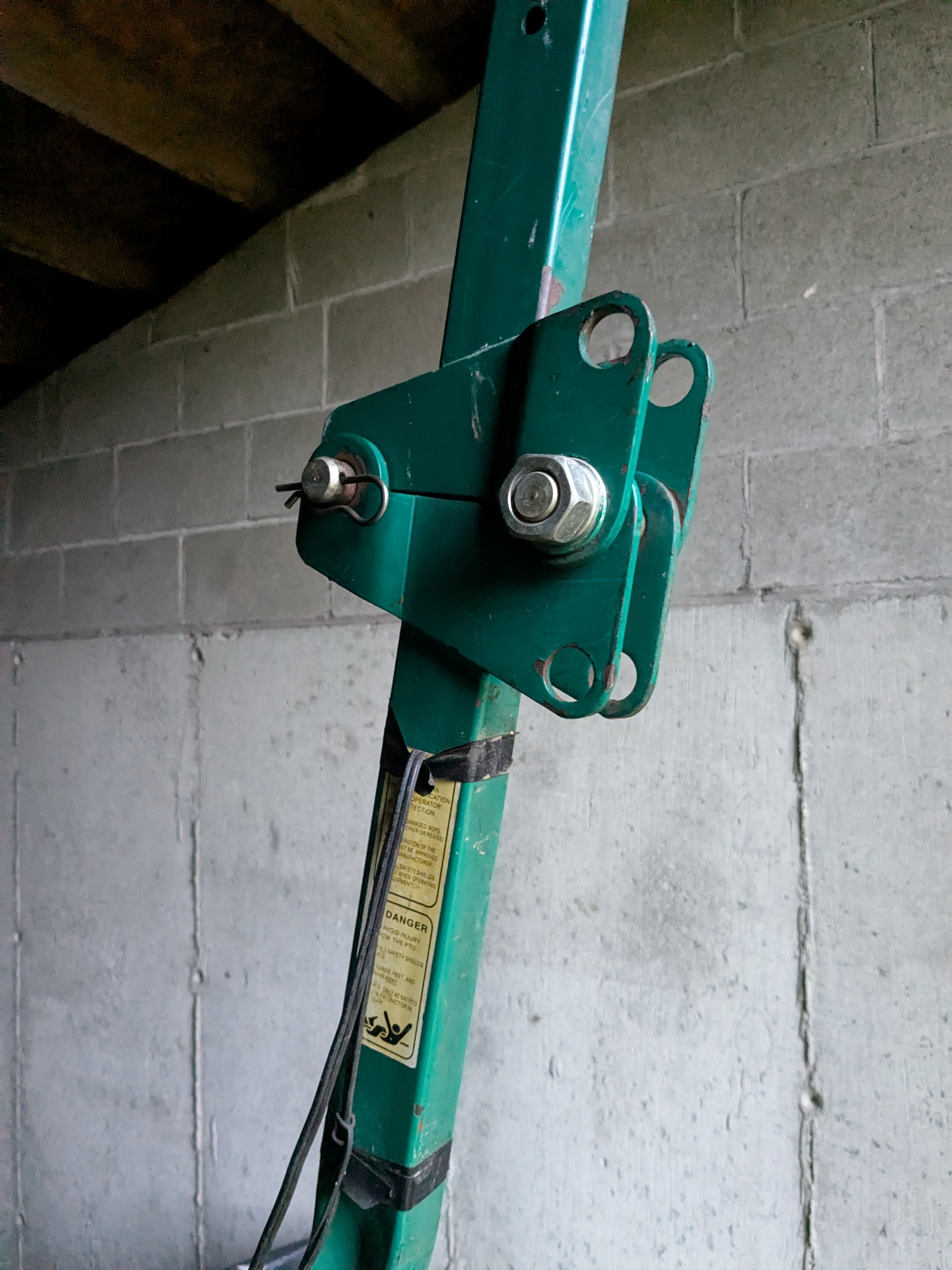

If jinma will not supply the part, get the material spec, or a reason in writing why not, before you make one.
Otherwise, throwing away the tractor
may be the only option.

Just for context, here are a couple of pictures. This is the ROPS hinge mechanism. To fold it, the pin in question is removed and it pivots around the bolt and nut until the other two sets of holes meet, then the pin is re-inserted to hold it locked in the down position.
This is a closeup of the pin. Overall length is 100mm or 3.9 inches, diameter is 24mm.
