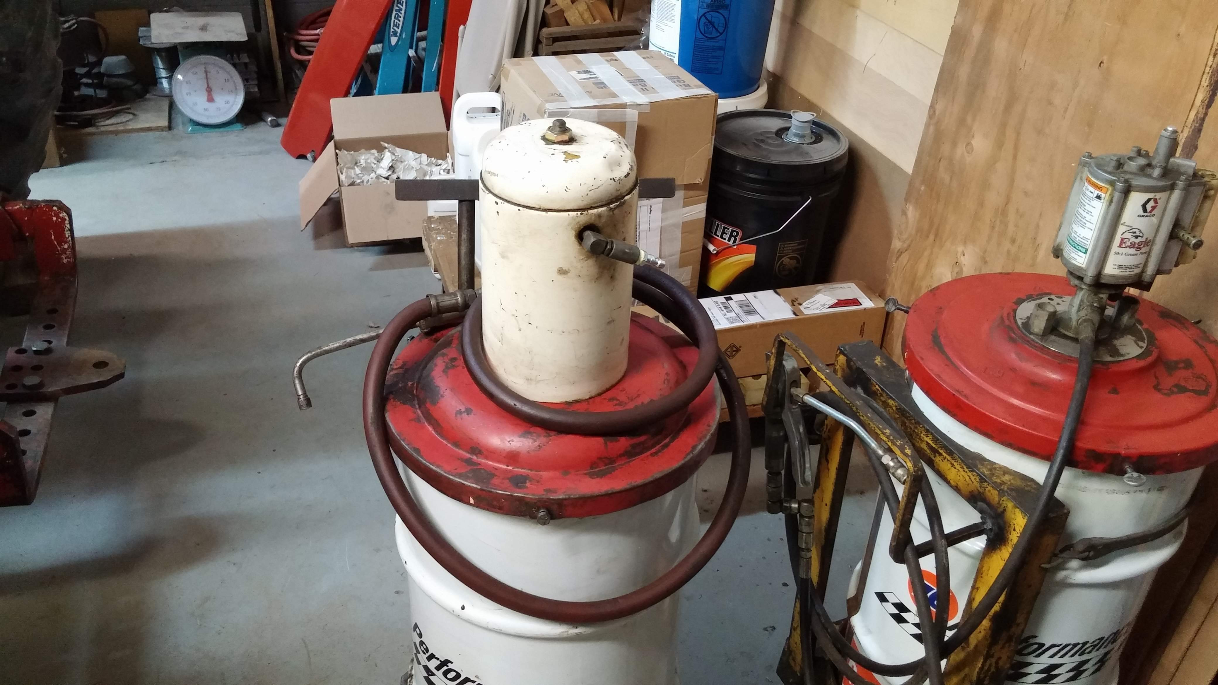

I use this.

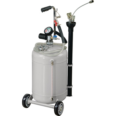

You want one of these, sucks the oil out. I bought this one then a larger one. Use this one for water/antifreeze and larger one for oil changes.
