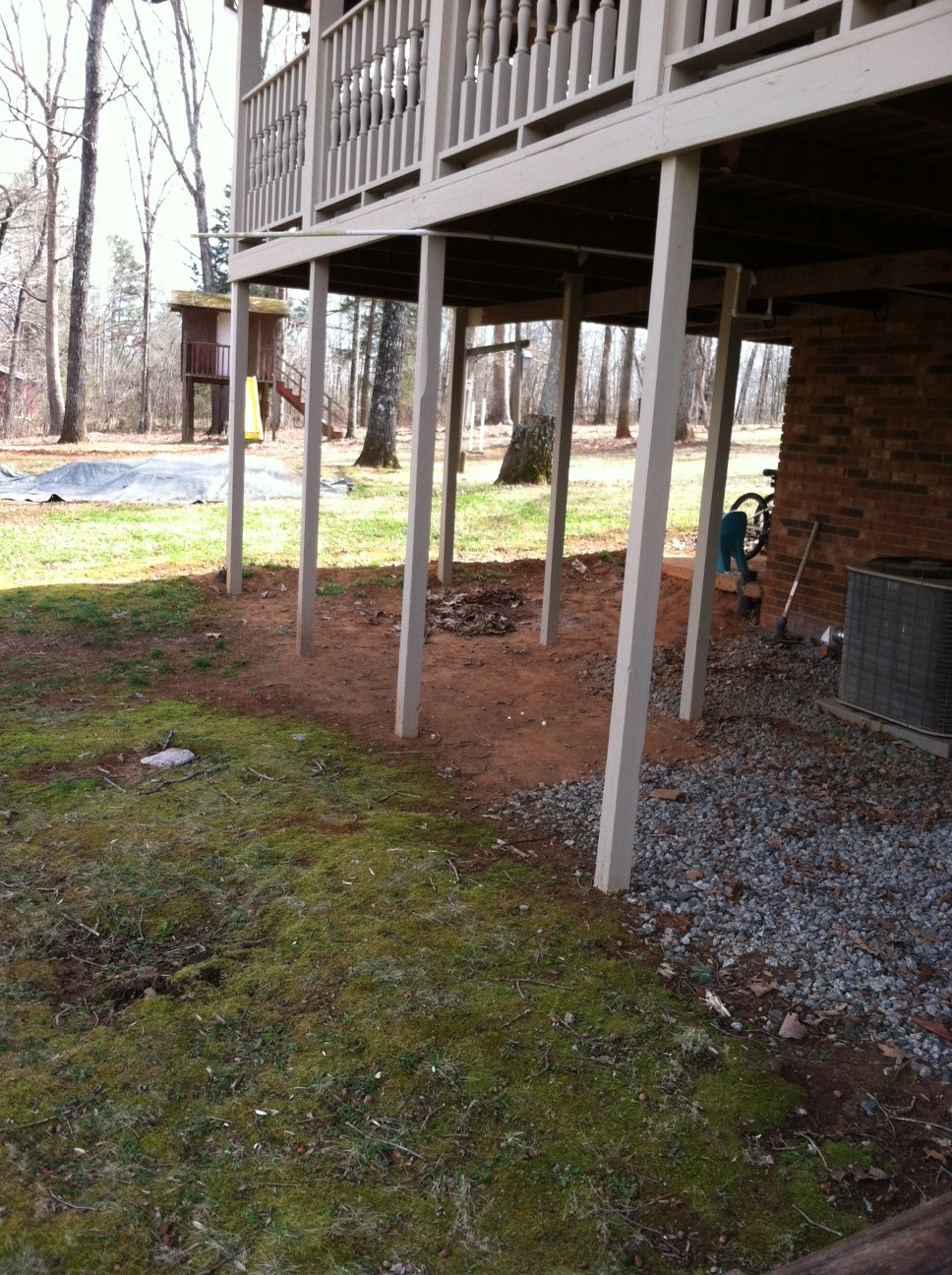

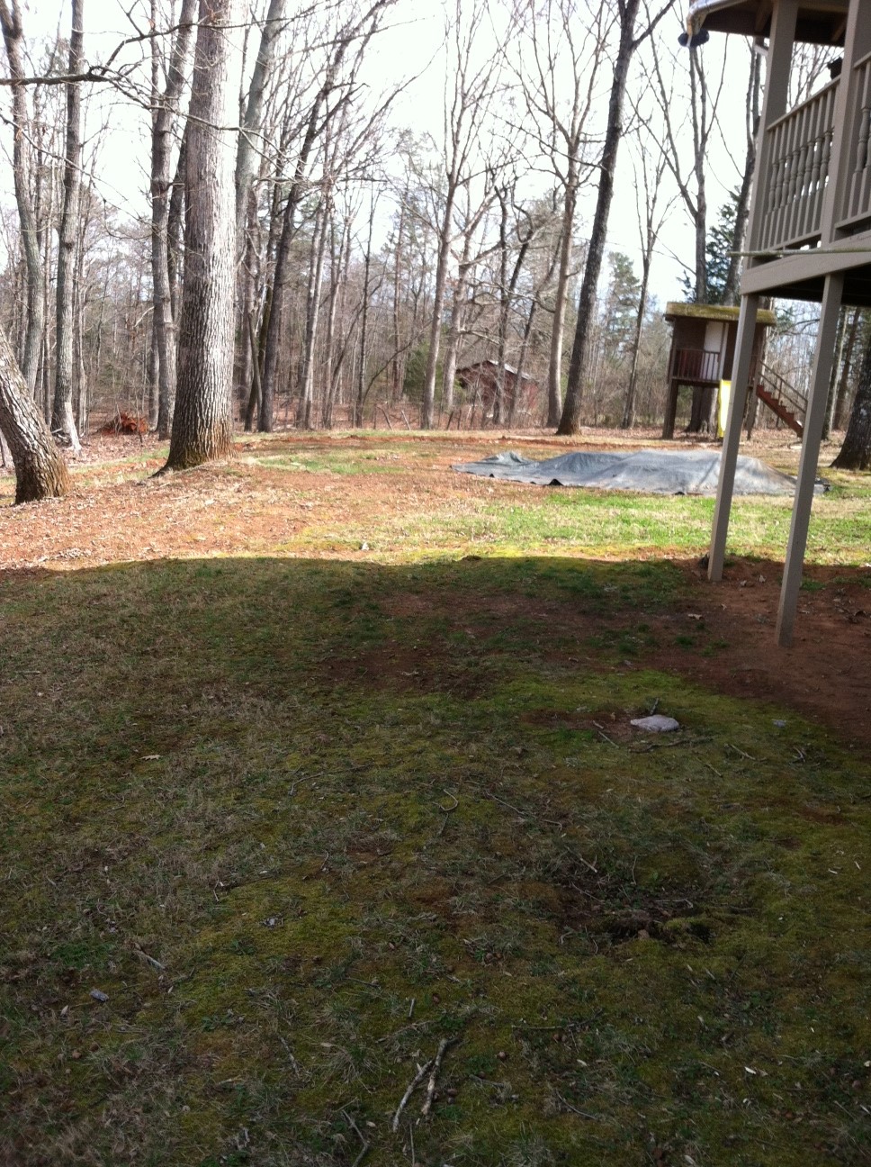

Here's a sketch of what I have found. There is one corner uncovered as noted. So, any ideas on where to dig for the lid? Guessing it would be on the centerline of the 4' width, but wondering how far in from the 4' edge.
/ Household Septic System #147
My tank has it 's big lid in the exact center. Try there first.

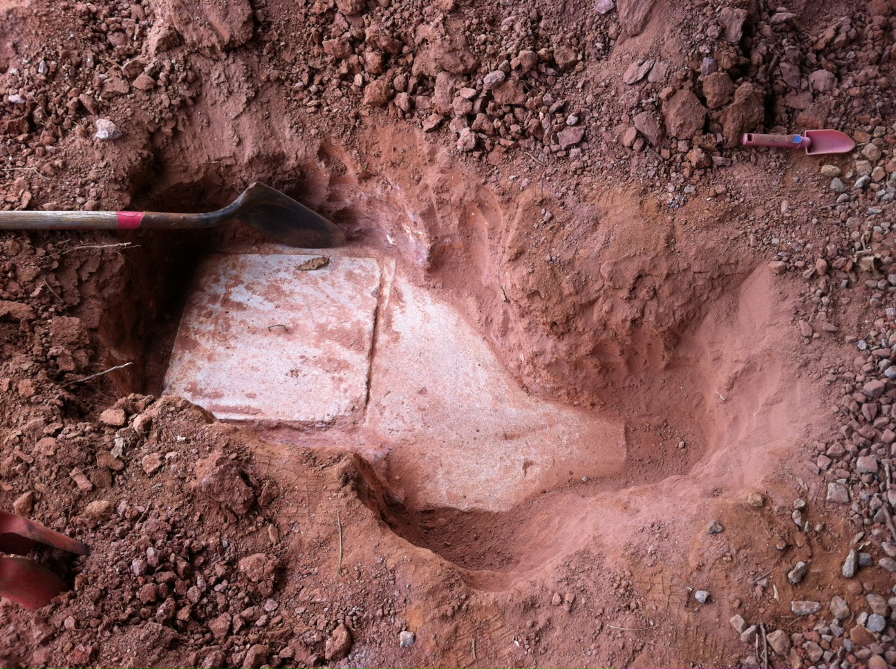

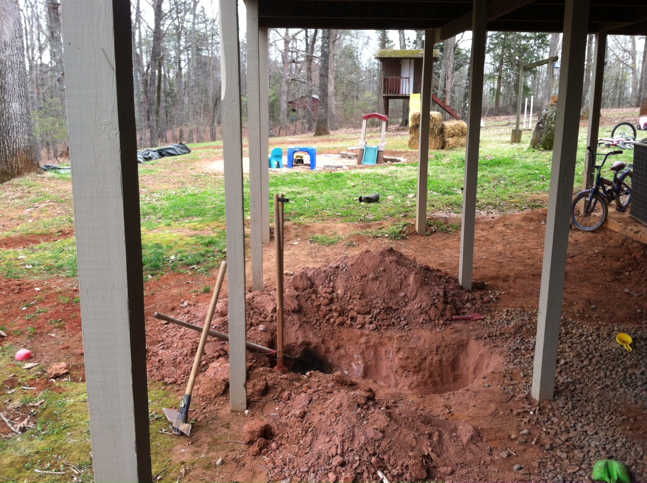

Found a 20" square lid(?) with not much more than a coat hanger wire in the center. The lid center is about 32" from the long edge of the tank and 6" from the short edge. I guess we can call the pumper now and hope for the best.
Thank you everyone for your help!
/ Household Septic System #154
There is a very good chance your tank is 10' long & in that case you may have another lid 56" from the one you've found. Since it's the lid closest to the house that's where the solids will be if it's a 2 compartment tank. It sure the devil looks like hard digging. If it's full to capacity with solids would be very good to pump both sides to avoid contaminating your field and creating more problems.

You probably want to lightly tap the cover before you lift up on the hook, to make sure it is loose.I have had to install heavier hooks with a hammerdrill in covers the hook broke or was missing. Your sketch shows four lines leaving tank outlet with no dist. box, unless there is some type of manifold to connect four lines to one outlet from tank. I do my tank every year on my wife's birthday. I tell her it is her birthday present. plowking

Final Chapter - Thanks everyone. The tank is clean now and the lid is covered again with an inverted 5 gallon bucket and 4" dirt over that. It's location is well documented now so it should be much, much easier the next time.
For you guys who know septic systems, this tank had about 8-10" of thick, dry muck on the top, some water in the middle and about 2 feet of sediment on the bottom. The pumper said it may have never been pumped before and we would have had issues sooner rather than later. The sediment on the bottom was hard as bricks and had to be broken up then watered down to get it out. YUCK! Glad it's over and I am now a firm believer in getting them cleaned regularly. Thanks again! :cool2:
