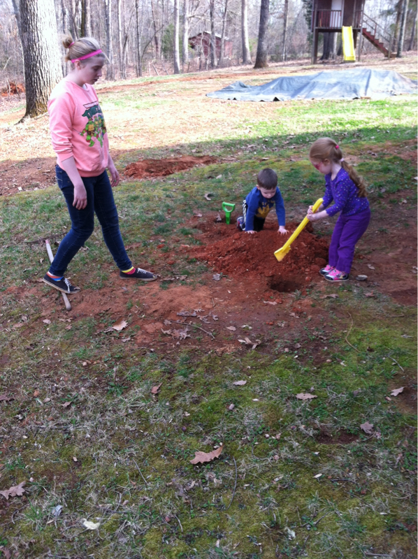

Third 45" hole = strike three. :(

Well, somebody is happy at least. :laughing:
For sure the twins are enjoying the dirt and dad home on vacation from work. The weather has been great but freeze coming this weekend.

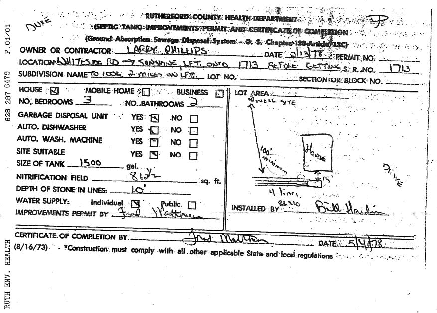

Found the sketch from the health department...
Unfortunately, that sketch says its 15' from the house (or more) but it doesn't say how far in either direction. It could be under or behind you from where you took the pictures. Or to you left. Or.... grrrrr..... hope you get a freak 1-2" late season snow storm so it melts over the tanks! :)

5'hx 4'w'10'L plus eight inches each for 4"thick walls and floors.

You sure you're on the right side of the house? :eek:
Yes, based on the location of the water well and driveway noted in the sketch. :D
