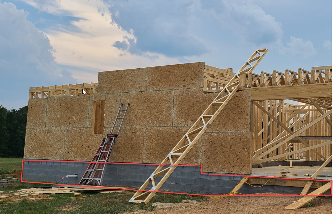

Does anyone have any thoughts on blue board (foam sheets) insulation around the blocks before bricks are laid? Not sure if it's worth messing with or not. Theoretically it *could* help insulate the floor from outside temperature?
/ House Build 2023 #171
I don't know about foam board (seems a good idea?) but I'd suggest taping the seams on your OSB and the sheathing to the block (use Siga Fentrim tape). Do you plan on doing air sealing?
/ House Build 2023
#172
I wrapped it with Tyvec, taped anything that looked like water or wind could get through, and foamed all gaps, cracks, and holes. Bottom plates on the walls will be caulked before insulation.
/ House Build 2023 #173
Sounds like you're on top of it.
I'd check greenbuildingadvisor to see if folks suggest putting foam board insulation on the block (many of the articles are behind a paywall, but the Q&A section is very helpful). You have a poured slab if I've followed correctly vs a crawl (which would likely be insulated on the inside), so I've not followed what building science advocates for these days.

/ House Build 2023 #177
I’ve read foam on outside of basement walls is good.
/ House Build 2023 #178
Definitely use window foam around the windows and doors.
The big misunderstanding about wall insulation is that does very little to control the outside temps from getting into the house. Wall's need to be made windproof. The wind is your bigger enemy in the walls. This is why taping the outside of the windows and doors is so important. Foam adds another layer of stopping the wind. If air gets through the walls, it defeats the insulation.
Attic insulation is what keeps the inside temp where you want it.
/ House Build 2023 #179
I have a 20x30 garage that I work in. I dug 2 feet down all around the outside and installed 2 inch closed cell foam. It was well worth it. The floor is a lot warmer. It probably helped a lot that I sealed the foam to the house wrap.
